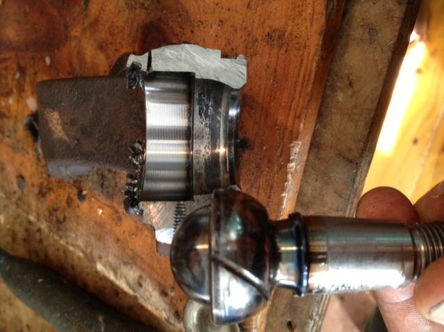

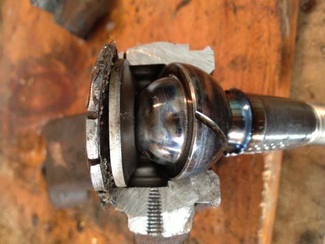

    Cut the Moog ball joint open today, it is metal on metal contact and does not have a full ball. Crappy and quick wearing..

    Do you have any photos that we can compare to Dirty Pool's pics?

    Moog LBJ. I think there was a rubber washer between the two plates in the third pic to keep preload on the ball or something
    Very happy i bought toyota ball joints. Think the moog uppers will stay until all pro ucas are in the budget..

    Good work, confirms my suspicions.
    I stole your pics for my data base and to update the other "ball joint" threads.
    You should be good for a while with Moog uppers, they don't see half the loads the lowers do.
