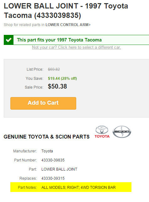

    According to the site this is for the 4WD. It maybe just the ball joint and not the entire bracket. If so all good to me - my local NAPA will press them in and out for $8. But, there is one that states for coil spring, and it looks to be the entire bracket, for $94.

    It looks like that part number, "43330-39835" is for 5 lug trucks, not 6 luggers.
    Not the right one for a 4x4 or a 6 lug Prerunner. Here is what my lower ball joints look like.

    That's what mine looks like too, the lower picture. Funny how the site states both will fit in my Taco, as I am a 6 lugger. I am not excited to pay $94 for the lbj when other brands are in the $40's, but will think about it. I was planning on changing both sides out at the same time, but if I do go the OEM route, that price will force me to do them one at a time with some space between. I have an entire other vehicle I am tossing money into currently :(

    Dang it seems like there are a few different ones....on camelback toyota parts is does not ask weather it's a 5 or 6 lug 4wd or 2wd. I am confused....but I am a noob also. Wha what are the correct part numbers for my 1998 4x4 TRD 5 speed? Thanks everyone.

    I'm doing mine right now - actually have the truck jacked up.
    For my 1996 4x4 6 lug, I ordered 43340-39585 and 43330-39815.
    I got them from Toyota Parts Zone. I have ordered a lot of stuff from there and have never gotten the wrong part - it's less confusing than Cameblback.
    These look like the correct parts, but I will know more later this afternoon when the rest of the tools arrive and I finish the job.
    I was also pleasantly surprised that they came with all new bolts, castle nuts, and cotter pins included in the package.
    ***Follow up: yes, these are the correct parts for my truck.
