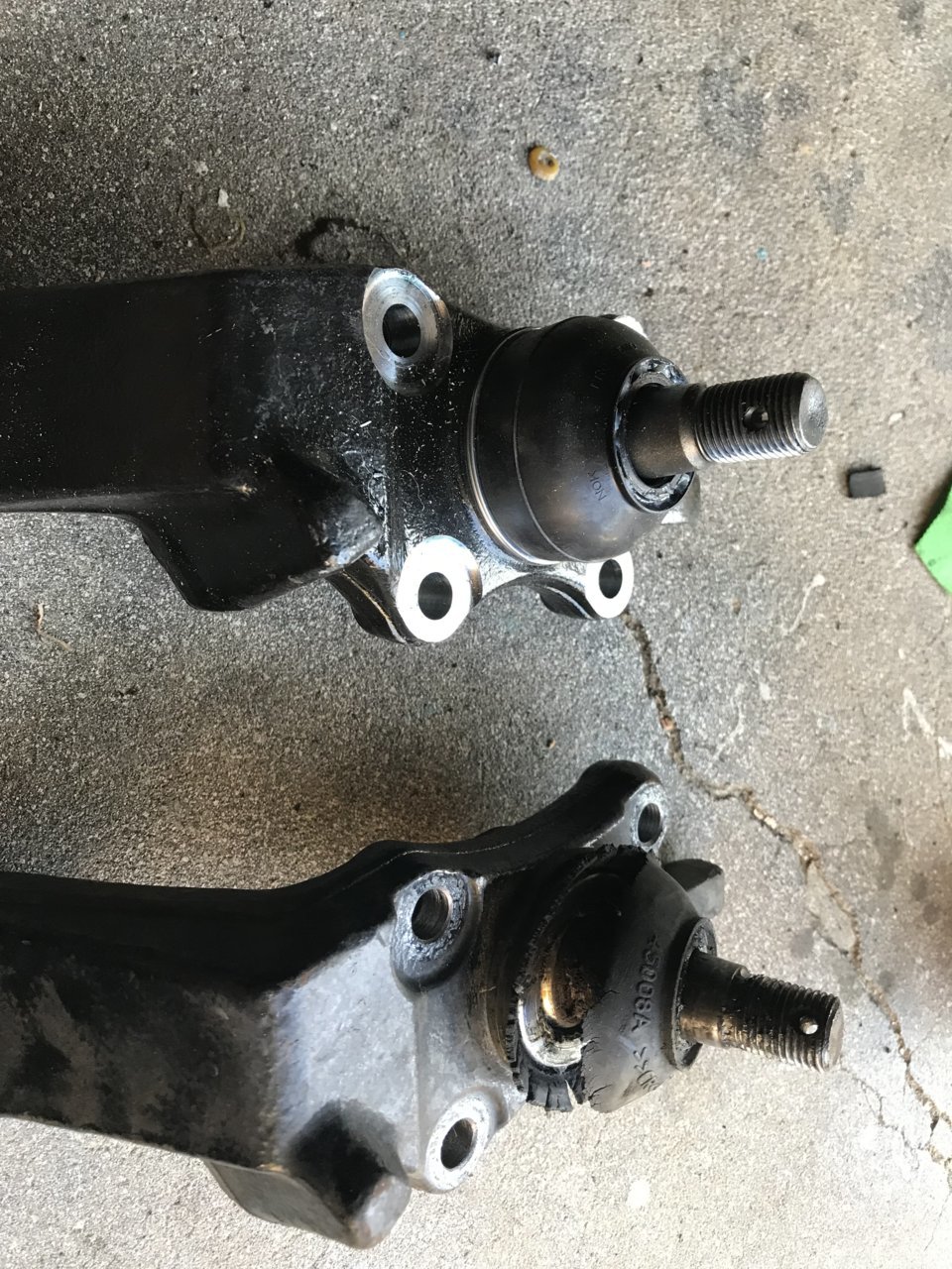

  12. Aug 8, 2019 at 5:32 PM
    Mtb_mafioso
    Mtb_mafioso [OP] Well-Known Member
    Jul 2, 2019
    #298146
    48
    Ended up going OEM. So glad I did it now instead of waited.
  13. Aug 8, 2019 at 5:59 PM
    eon_blue
    Mar 4, 2016
    #180213
    69,919
    Azusa, CA
    :eek: Was the boot like that while it was on your truck? Or did it get ripped while taking it off?
    If it was like that on the truck....that thing was a ticking time bomb
  14. Aug 8, 2019 at 6:09 PM
    Mtb_mafioso
    Jul 2, 2019
    #298146
    48
    It was on my truck like that
    . I’m going on my 1st overlanding trip and I wanted to make sure this thing was at the best it could possibly be.
    I have a family friend that is a mechanic and I take my cars to him and he tells me what to do and I pay him a “consulting fee” $20. We put it in the lift and he noticed it right away. He told me not to skimp on this part. Man I. Glad I listened.
    Wulf, GQ7227 and eon_blue like this.
