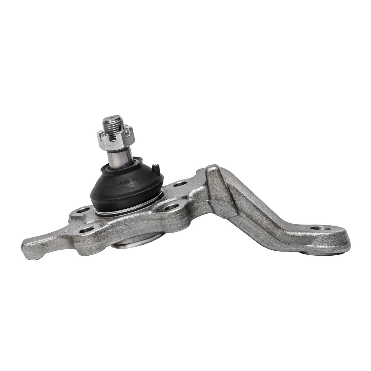

    You need things that look like this
    3D8F4A6E-A8E8-4C5A-915C-1677F6E236D8.jpg 7963B35E-A742-4D1F-96CC-1C7A7432D557.jpg
    Kwikvette likes this.

    What the poster above me said.
    If OP insists on Rock Auto, follow the parts for Prerunner and 4x4.
    Ignore S Runner.
