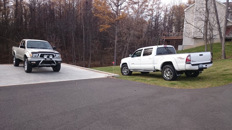

    Ive got a 2012 DCLB. Getting ready to spend some coin on her after selling my cherry 02'DSC_0577.jpg
    Is anyone running the 18X9 Ballistic jesters? (I plan on lifting it as well)
    If so,..how does the truck handle with them, and what offset did you get? (Pics appreciated)
    I ask because I used to have a set of Moto metal rims on my 1st gen and they made it handle horribly. Put stock wheels back on in the winter and it handled fine.
    Trying to avoid finding that out after buying them.
