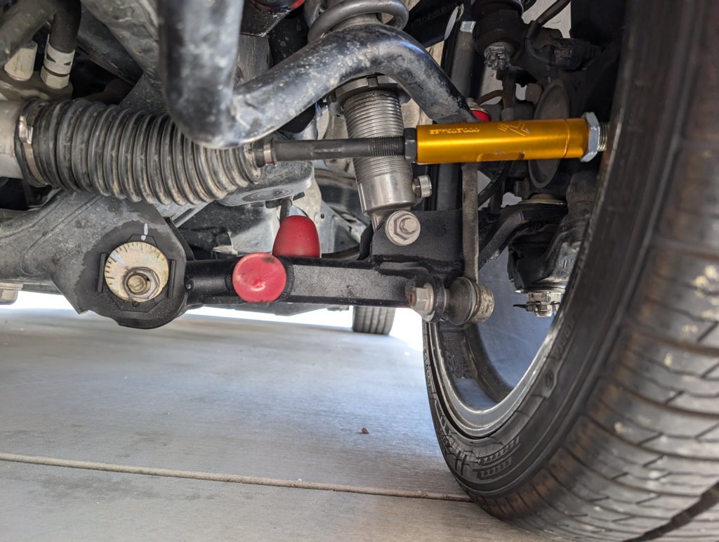

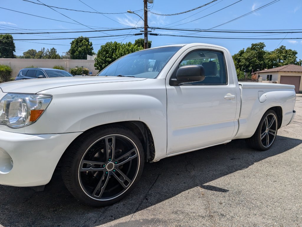

    5-lug with DJM arms, Viking coil overs, reworked tie rods and spaced steering rack up front. Dropped approximately 3.75/4. I basically don't have any stock suspension parts left on the vehicle beside the front sway bar.

    Trust me, I know. I've done a lot of trial and error getting things to work the way I want them to. Re-did the rear three times trying to get it just where I want. Had to play around with the tie rods and spacers a couple times to work out the bump steer issues. And just finished making my own spacers for the driver's front to get rid of the taco lean without screwing up how the coil overs worked.
