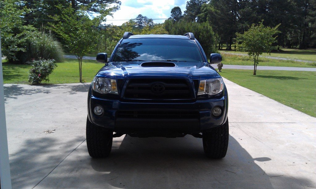

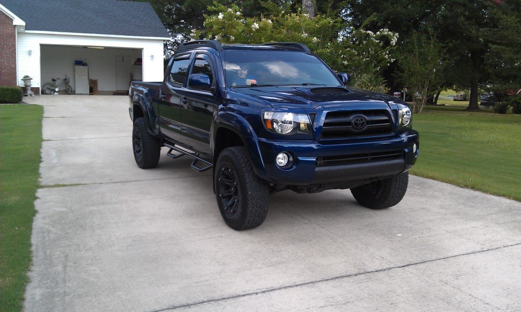

    Current Picture.....

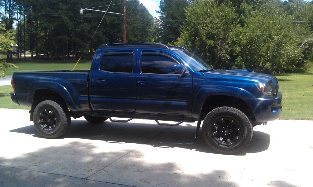

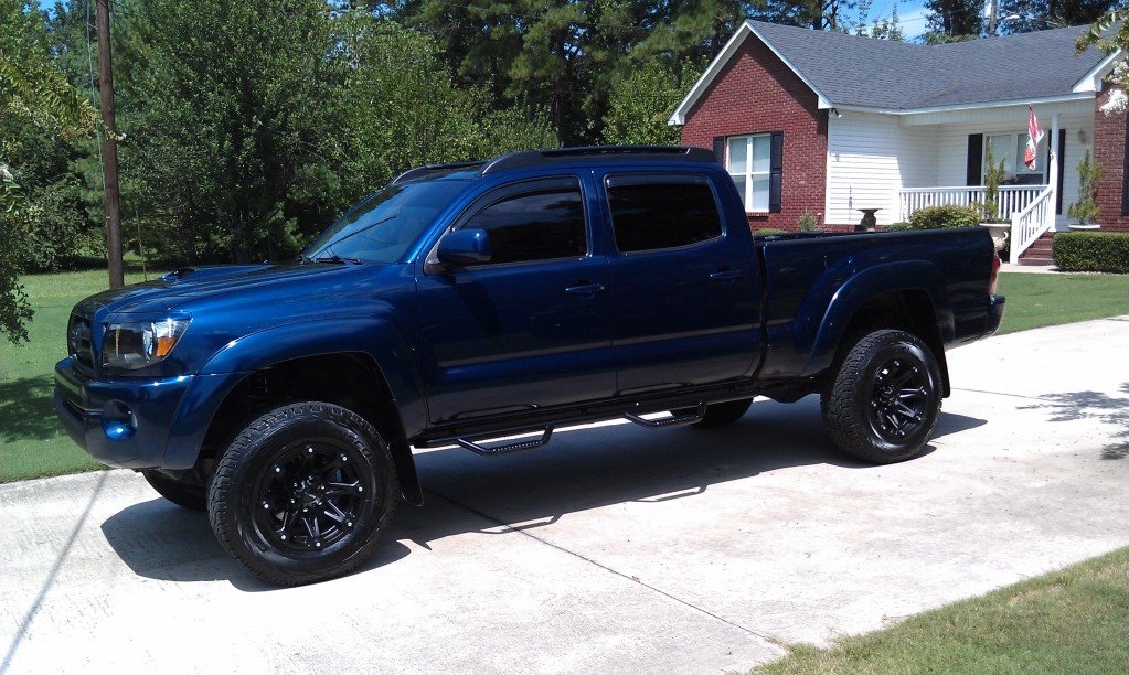

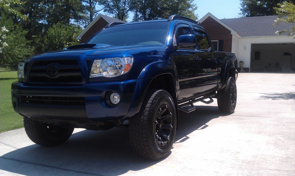

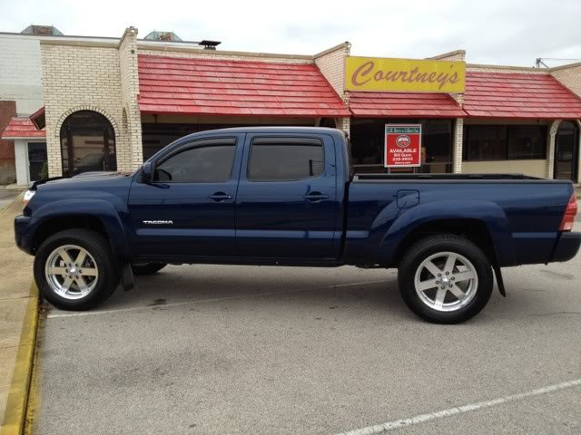

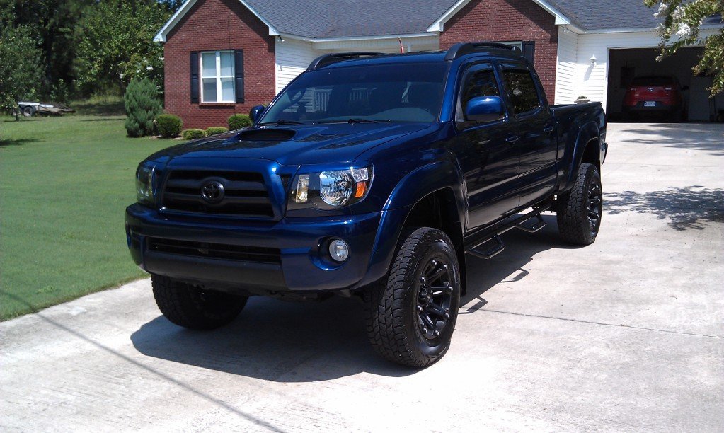

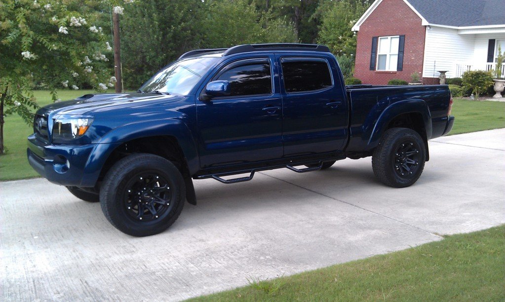

    The day I bought it. 2006, Double Cab Long Bed Prerunner. 20" Enkei's and a 2" Spacer lift (didn't like either and new they wouldn't be on there long). 144,000 miles. Quickly removed the bug guard.

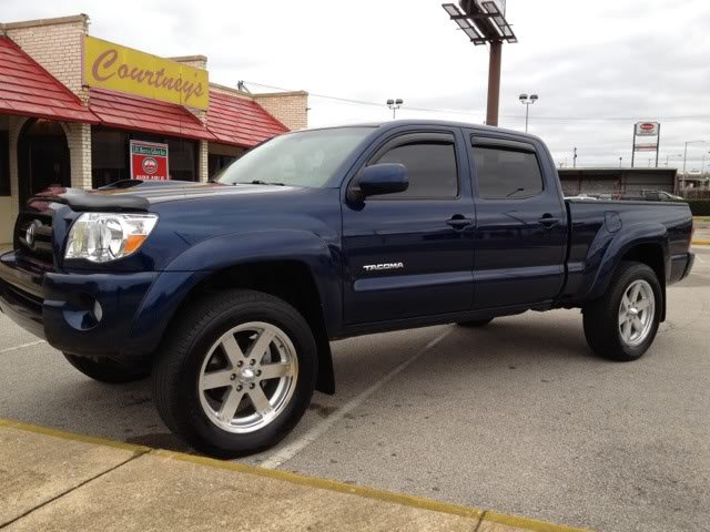

    First Mod. Wheeler 1 1/2" AAL to get rid of the nose high look.

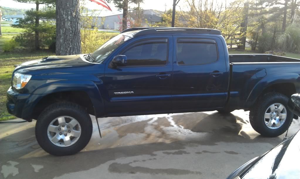

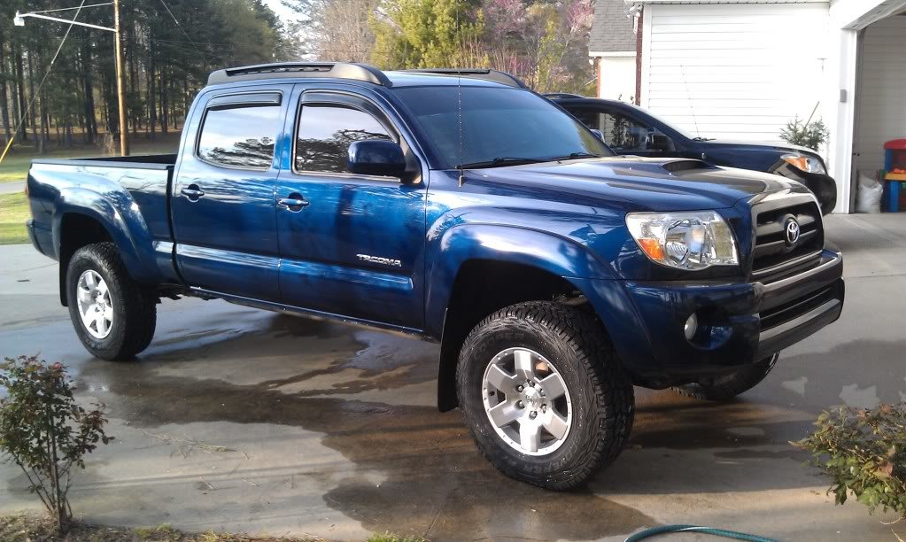

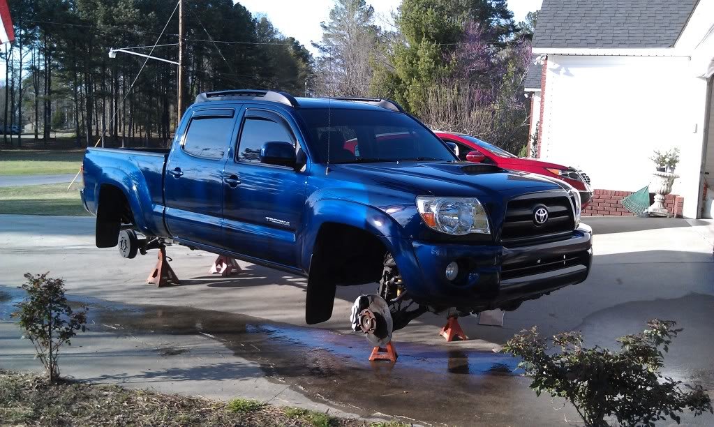

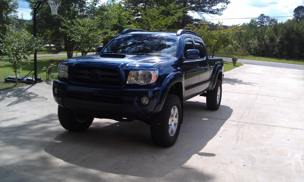

    Next Mod...Sold the Enkei wheels so I had to put her on stands until my new tires came in. Installed the roof rack while I was waiting.

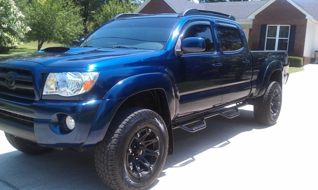

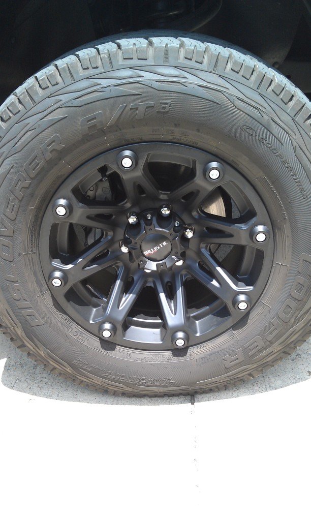

    Tires ready to go on the truck. 275/70/17 Cooper Discoverer AT3. Wheels are FJ Cruiser 17s.
    Next....Installed BORA 3/4" wheel spacers.
    Blacked out the front valence with Rustoleum Bedliner.

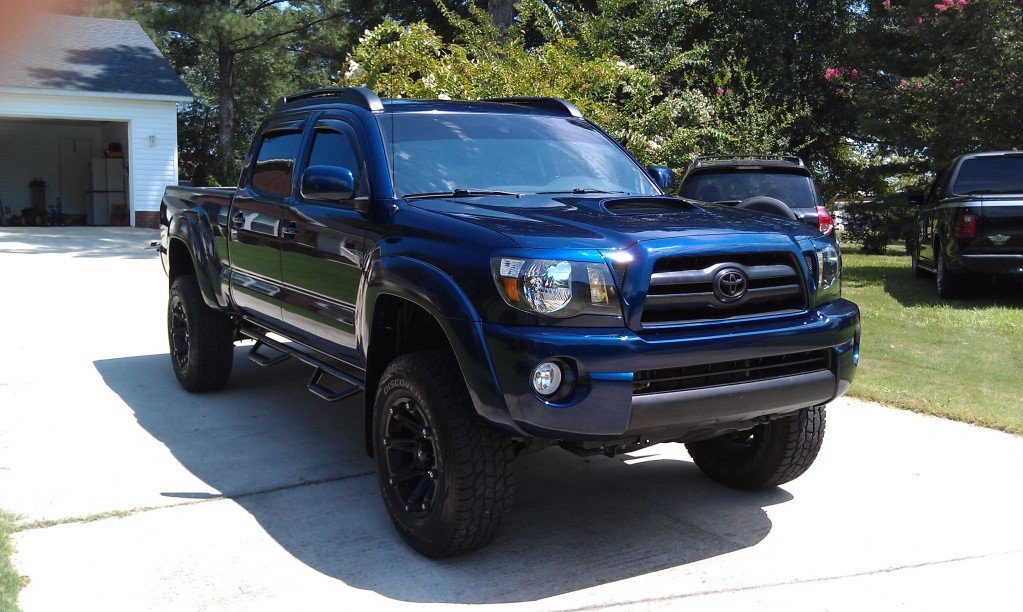

    Installed Eyelids purchased from a member on here.

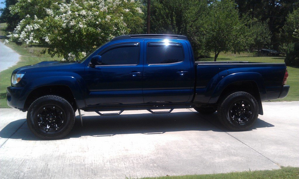

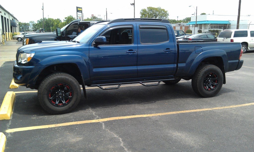

    Ballistic Jesters 17x9. Also installed the NFab steps.
    Removed the red from the wheels and painted the silver dome hickeys black.

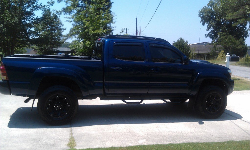

    Looking good my Indigo Ink, DCLB brother! Really love the way the tint pulls everything together. Your truck looks sick...I love it. :thumbsup::thumbsup:

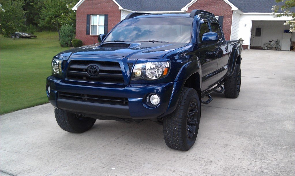

    Thanks a lot. I've looked at your truck several times myself. I wish I would have gone with 285 Duratracs, but it just didn't make a lot of sense to put them on a prerunner that I drive as a commuter. Currently I've got the headlights out doing the BHLM, so it will look much better as soon as I can find time to finish.

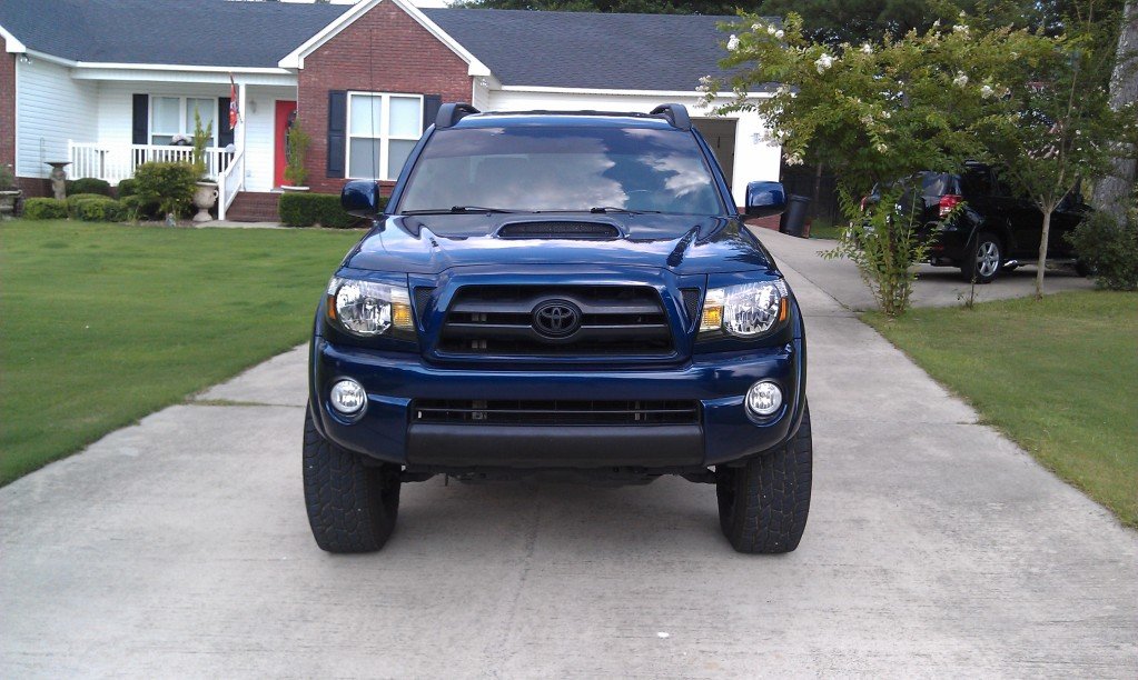

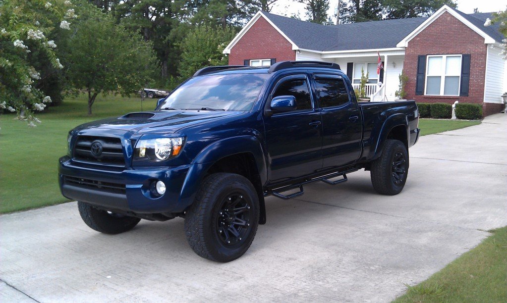

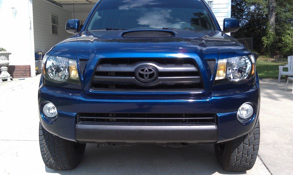

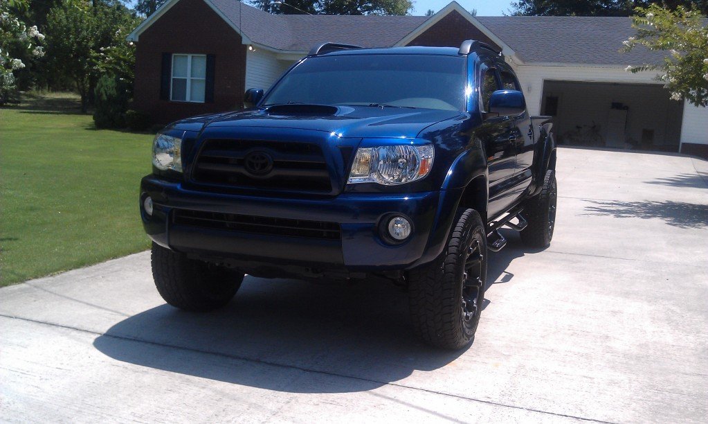

    Finally took the time to do the BHLM. Just noticed in one of the pics you can see my 3 year old with his bright orange arm cast.

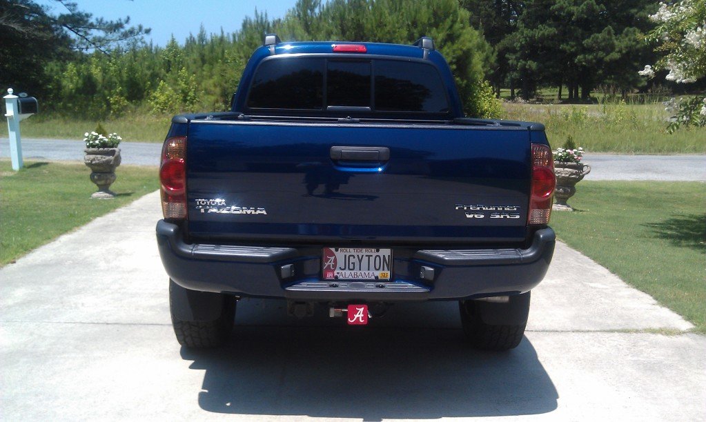

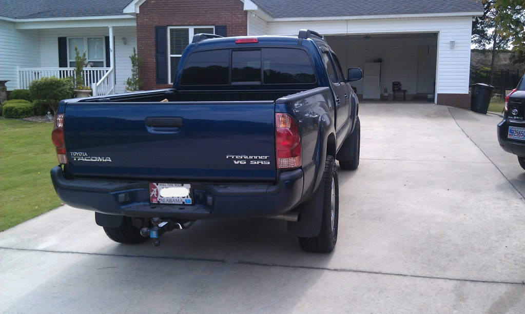

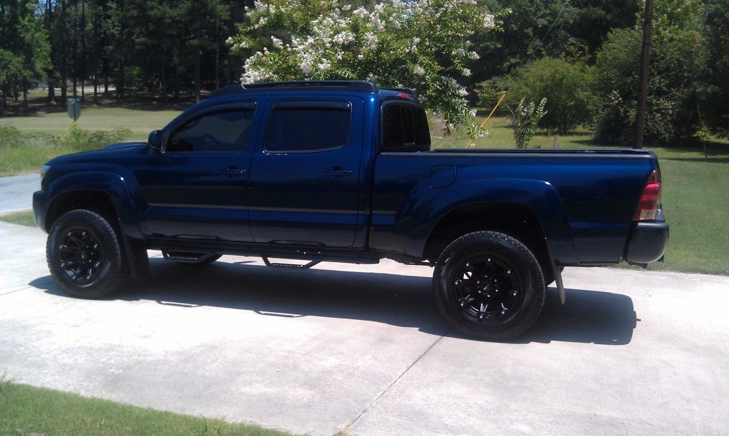

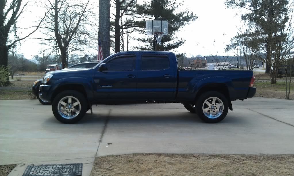

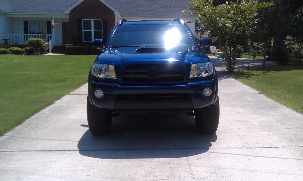

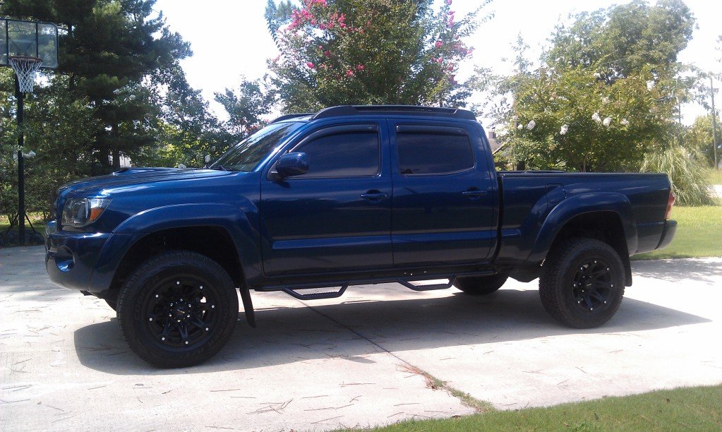

    Added a 1 1/2" block to the rear for just a little bit of rake. I normally wouldn't do a block but since it's only 1 1/2", I think it will be fine. No vibrations and no axle wrap yet. My measurement now in the back from hub to fender is 25 3/4". 1/2" top plate spacers and Light Racing UCAs going on later this week.
  8. Jul 24, 2012 at 12:56 PM
    Bama_TACO
    Bama_TACO [OP] ROLL TIDE!!!!!!!
    Aug 3, 2010
    #41157
    1,011
    Winfield, AL
    2006 PreRunner Double Cab TRD SPORT

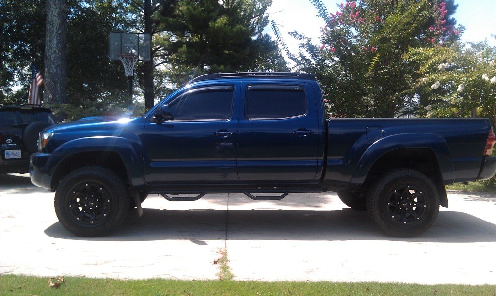

    Installed 1/2" Top Plate spacers, Light Racing UCAs and 1 1/2" Block in the back. Measurements now from center of hub to fender are 24 3/4" front and 26" in back. I don't know what it measured stock because it had the spacer lift when I bought it, but from looking at other measurements of stock DCLB prerunner sports I'm over the 3 1/2" mark (probably closer to 4"). Got it aligned today and got 0 camber, 3.0 left caster and 2.7 right caster. Drives really good now.
