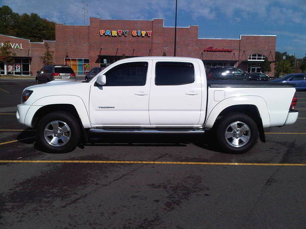

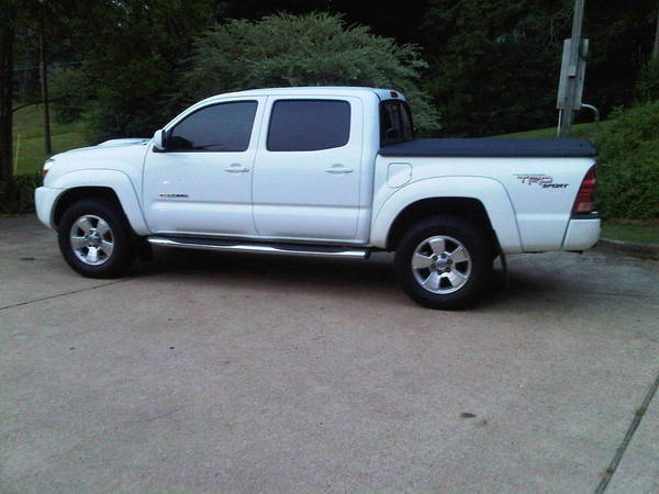

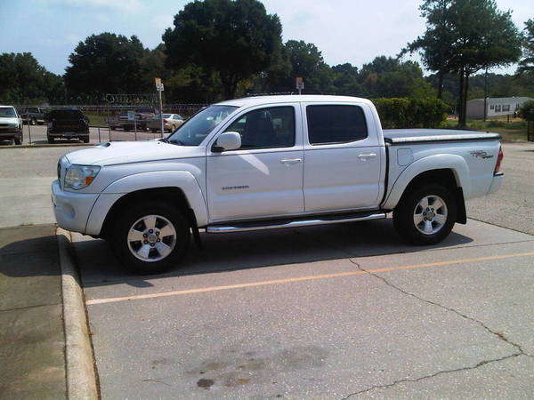

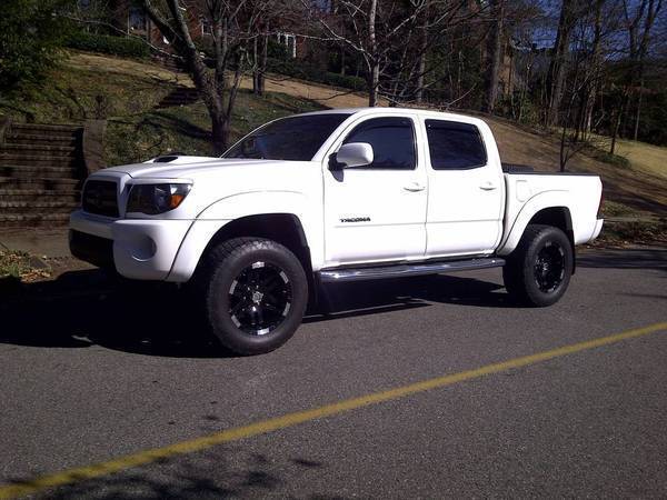

    The day I bought it.

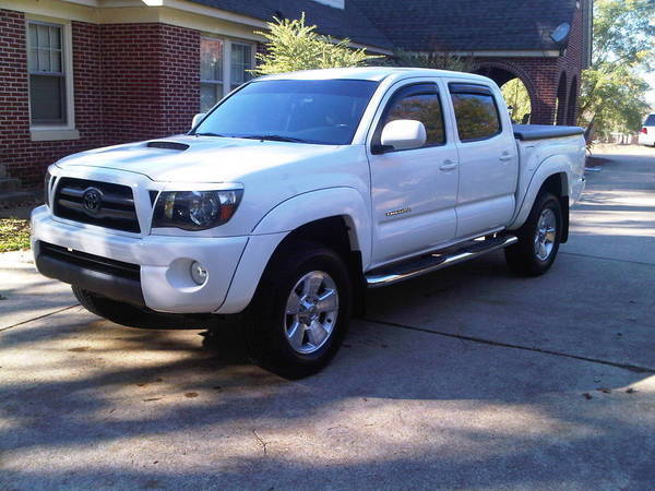

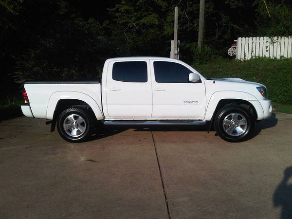

    Day 2, Pinstripes removed, windows tinted (20% on front roll ups, 20% overlaid on all rear windows, 40% on windshield (later removed)).
    TRD Sport decal removed.

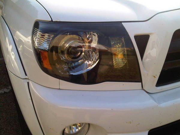

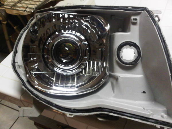

    Morimoto D2S mini retrofits installed, BHLM, Spray on bedliner on valance, Emblem blacked out.

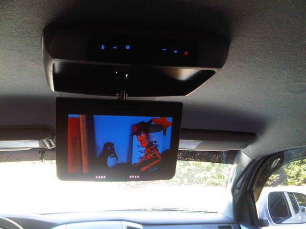

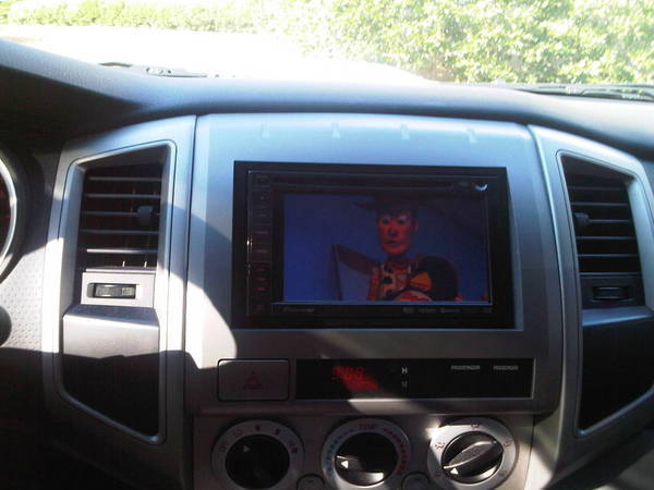

    Pioneer Avic X920BT Installed, rear Power Acoustic 9" overhead monitor

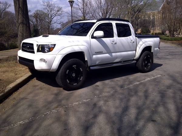

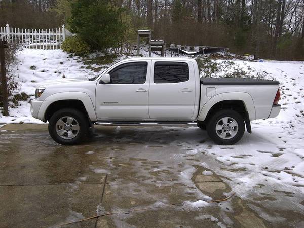

    Front 5100s Installed (set at .85" with 1/4" Toytec spacer on driver's side, rear stock 3 leaf)
    Eye Lids Installed

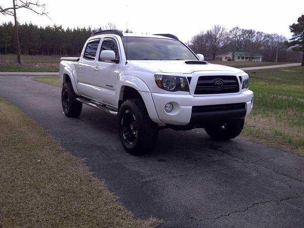

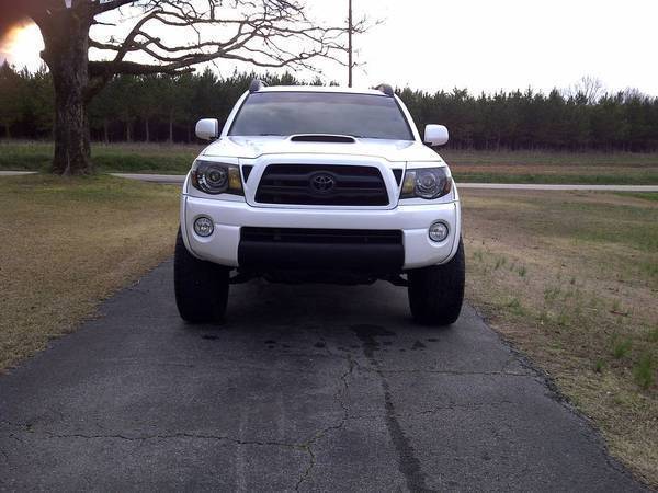

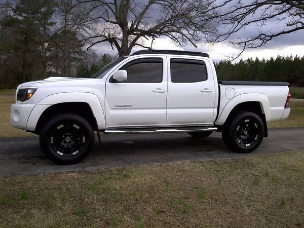

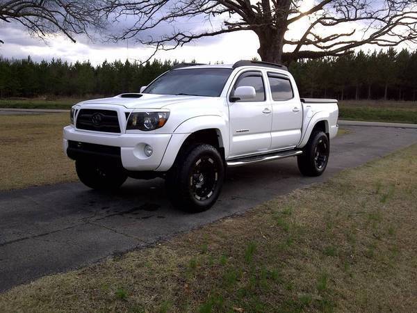

    Front 5100s set at 2.5", Icon 3 Leaf AAL in rear.

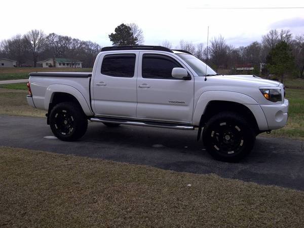

    New Wheels and Tires (Moto Metal 951, 18x9, 285/65/18 Terra Grapplers)
    Roof Rack installed

    Very nice Sir!! The more projector retros I see the more I wana do mine, quite sharp!

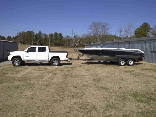

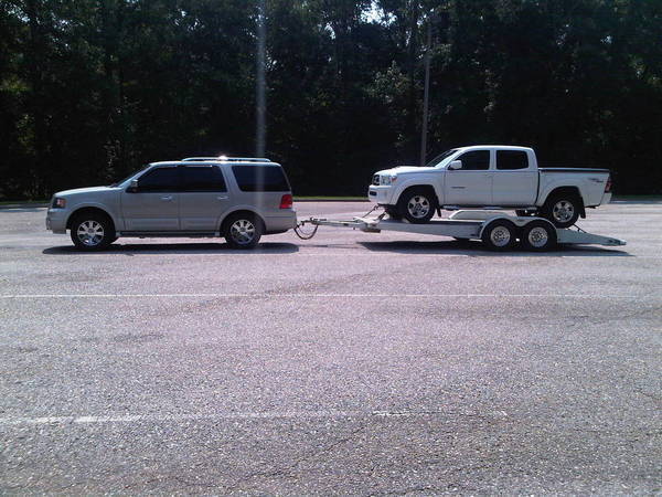

    Looks like you got a lot of lift out of those Icons. Did you just add them to a standard, non-TSB leaf pack? Do you tow or haul with it, just wondering how they handle when loaded up. Nice truck, BTW!!

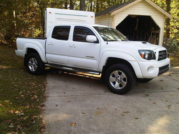

    Thank you sir. I added them to the standard 3 leaf pack. I removed the overload spring from the 3 leaf and added the Icon 3 leaf pack, for a total of 5 leafs now. I towed my boat which has about 300 tongue weight and it handled the load fine. It squated a little. Picture below. I have toyed with the idea of adding the factory overload leaf back to get about a 1/2" more lift in the rear. I know there is someone on here running a Wheelers 3 leaf along with the factory overload leaf without any issue.
    EDIT: Here is the thread where a guy put in the Wheeler's 3 leaf along with the factory overload leaf. http://www.tacomaworld.com/forum/suspension/117238-installing-wheelers-3-leaf-aal-question.html
