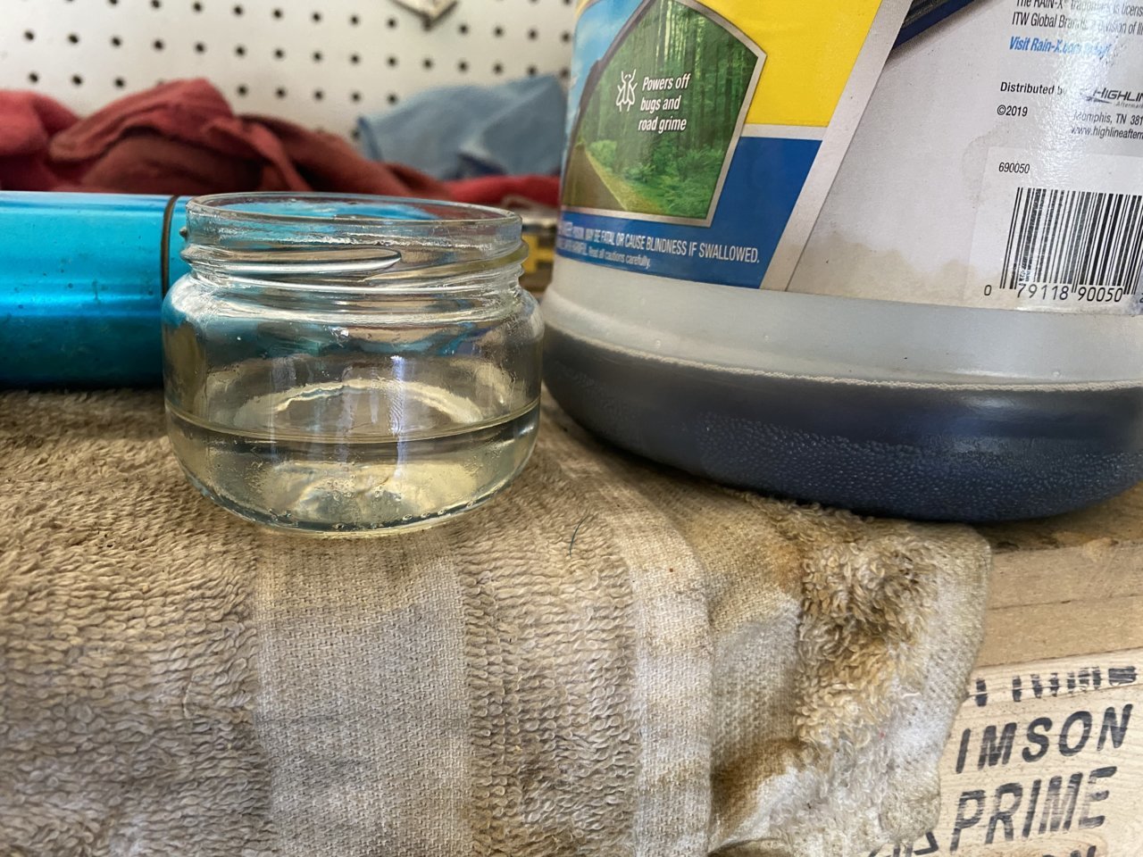

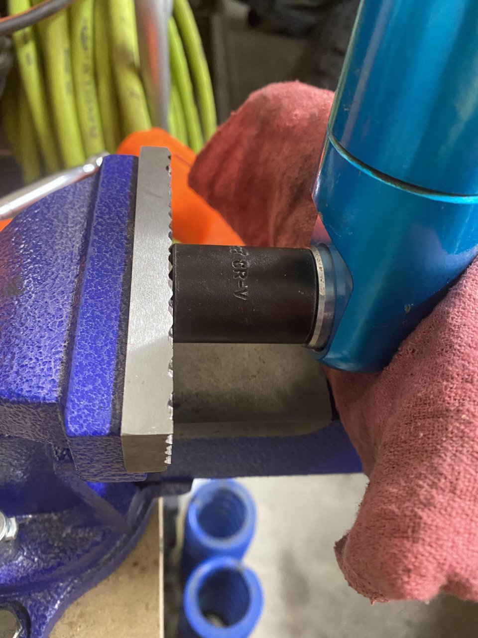

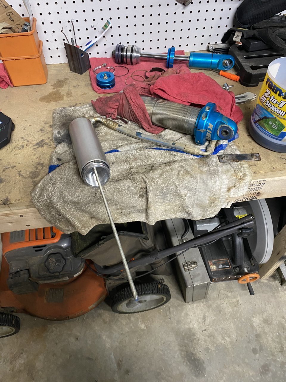

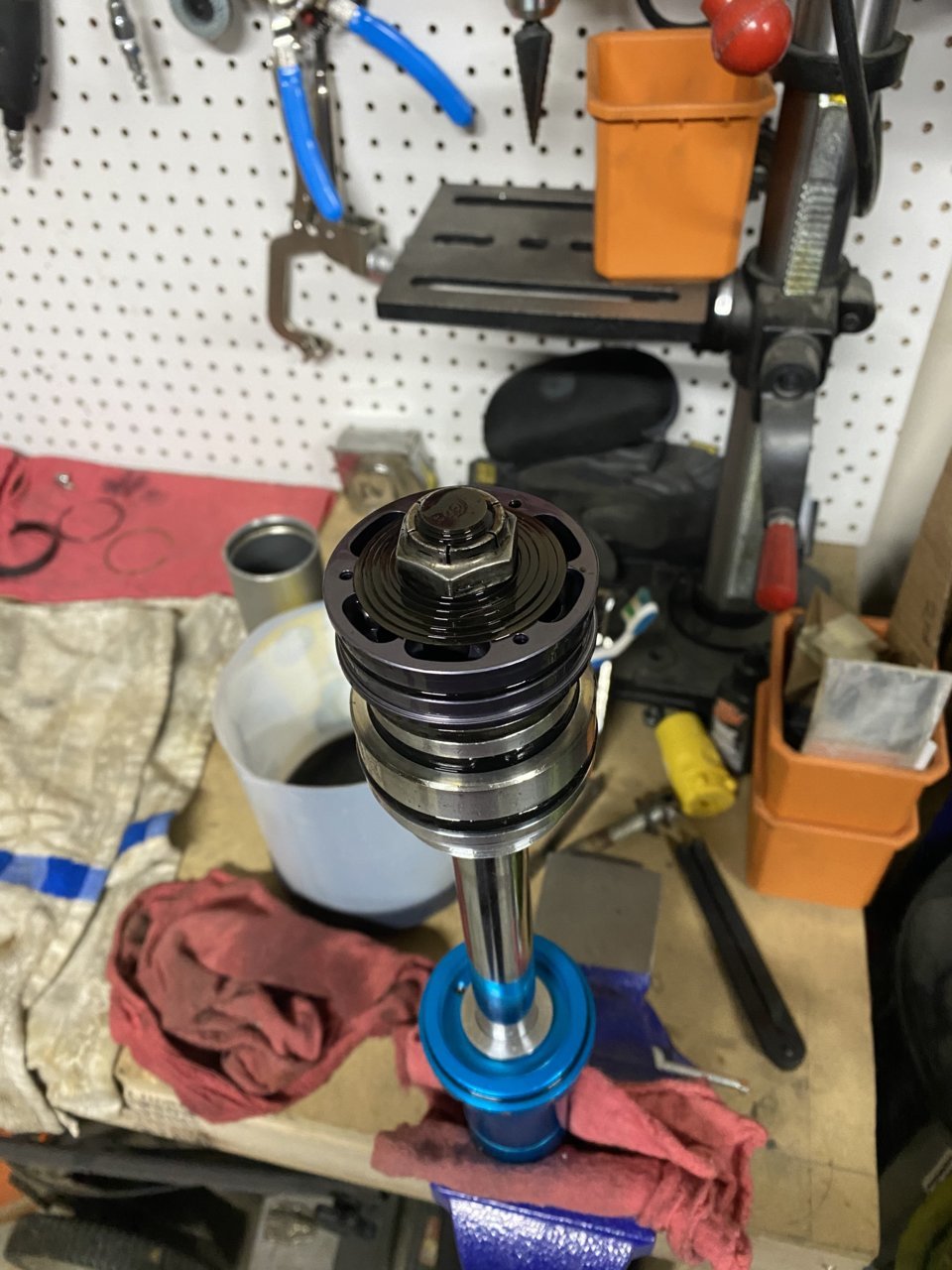

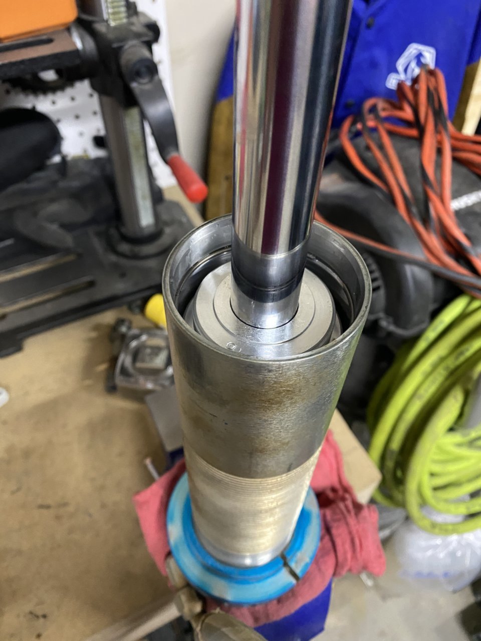

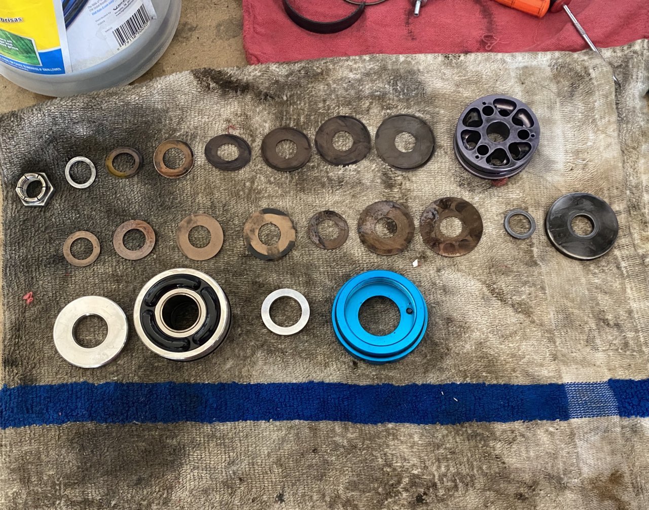

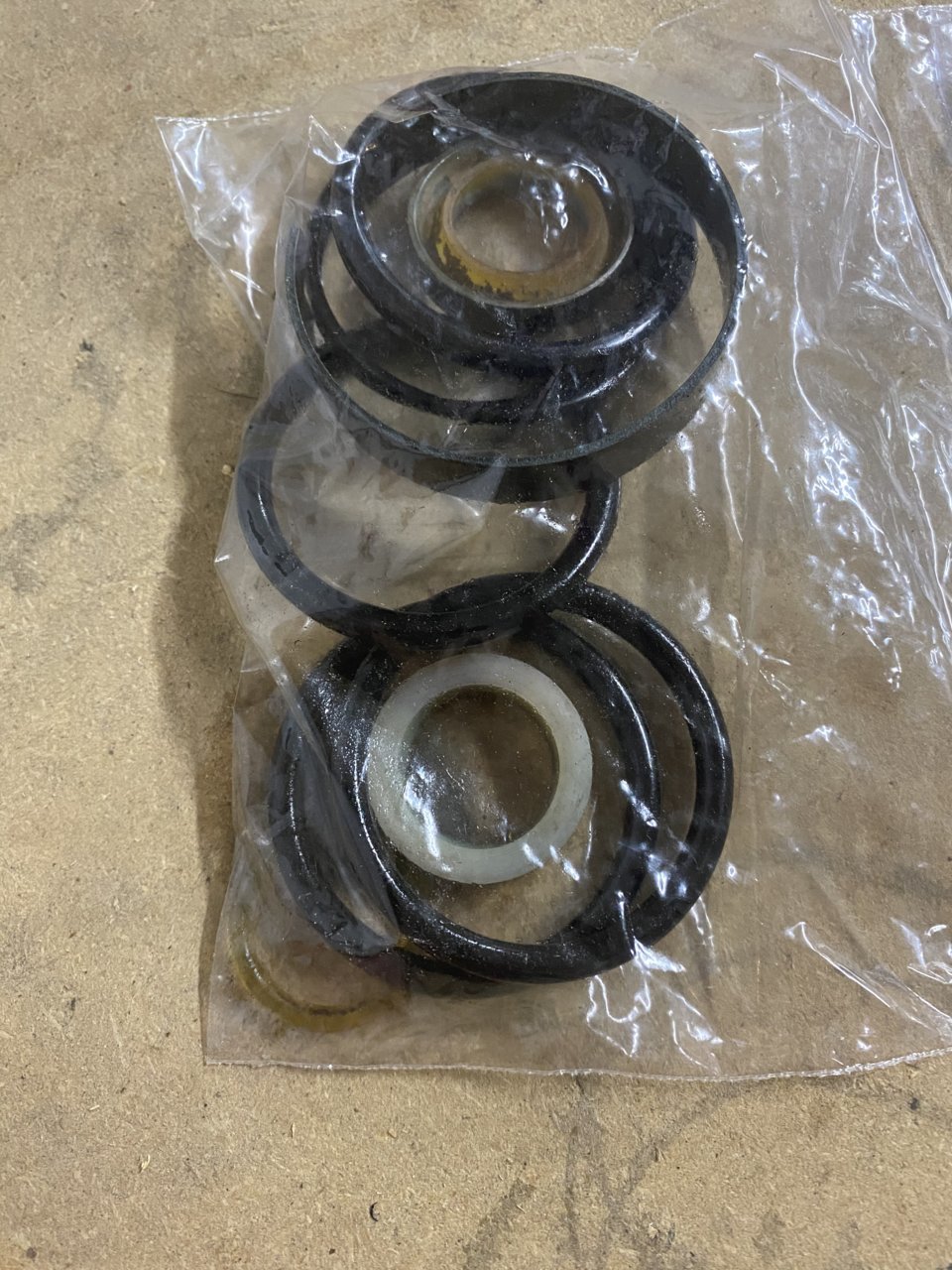

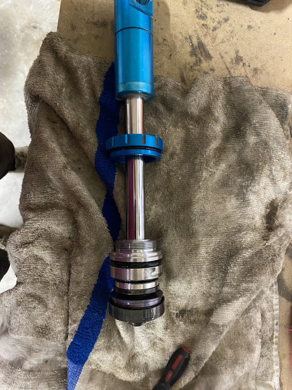

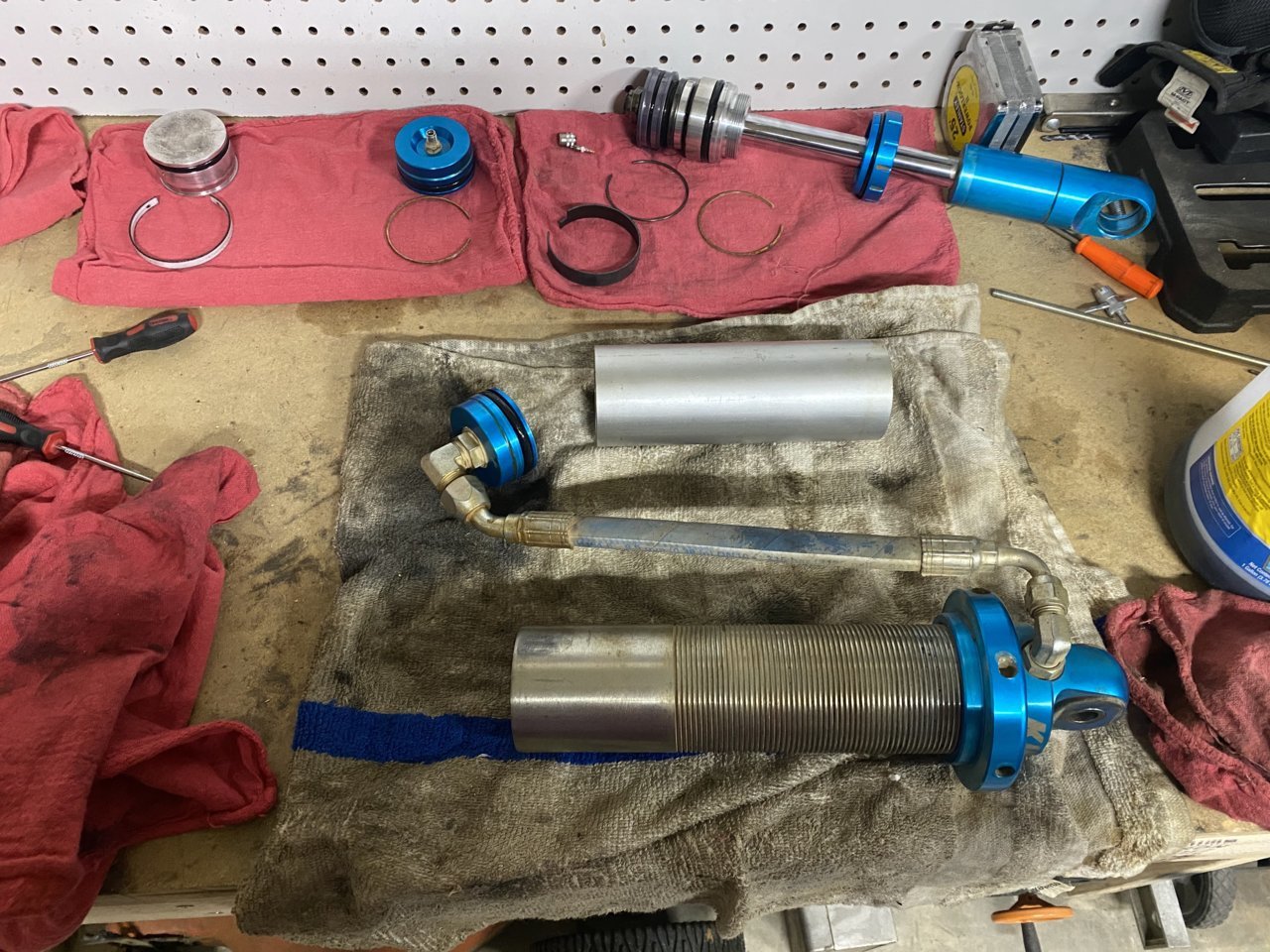

    New spherical bearings, Reseal, and new oil in the kings.
    1) wiper cap removed to expose the seal cap.
    2) shaft removed from shock body
    3)removing IFP from reservoir
    4)disassembled the reservoir for new seals
    5) reverence photo for disassembly
    6)piston, Shims, and valve stacks laid out
    7)these are the old seals from one shock.
    8) pressing in the new spherical bearing
    Cred92 and cubie like this.
  11. Aug 19, 2020 at 6:17 AM
    #191
    BamaTaco56
    BamaTaco56 [OP] Well-Known Member
    Mar 25, 2017
    #214383
    10,306
    Trey
    Old shock oil vs new

    Did you order parts from poly performance? And how much oil to buy?

    everything was ordered from poly performance. I ordered a gallon of oil but didn’t need all of it.

    King seal kits are universal by shock body diameter and shaft diameter. You can tell them what you have and they will work up an invoice for you or I can send you what I got when you get ready.
