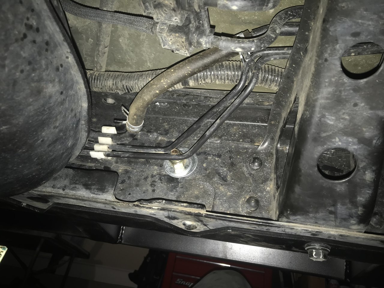

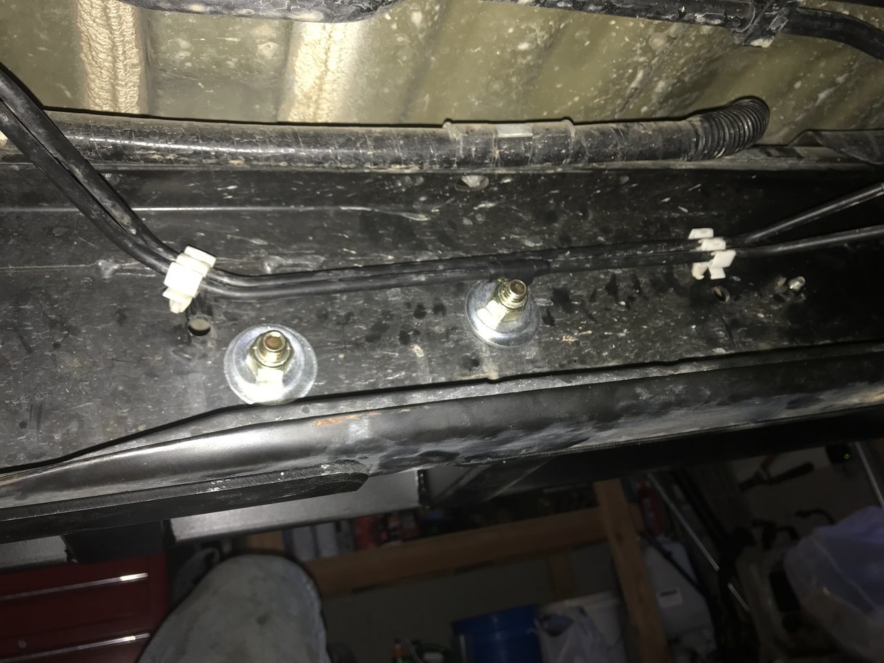

    I need to figure out the best way to secure these brake lines around the slider bolts. @JimboAnz ideas?
    I’ve seen folks use a 3/4” gromet as a spacer on the clip, but that won’t come close to getting the lines to clear the bolt inside the frame.
    JimboAnz and ChadsPride like this.

    I think what I did was slit some fuel line and wrap the brake lines, and hose clamp it so it does not wiggle / slide away. my lines may not be in their clips anymore

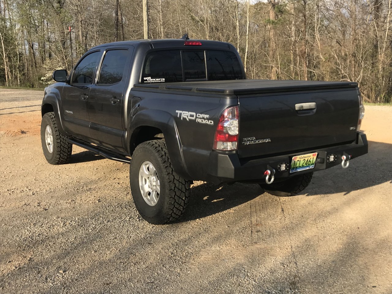

  8. Mar 24, 2018 at 11:54 AM
    #48
    BamaTaco56
    BamaTaco56 [OP] Well-Known Member
    Mar 25, 2017
    #214383
    10,308
    Trey
    Crappy slider pic while I crawl through the asphalt rock garden
    Ngneer and ChadsPride like this.

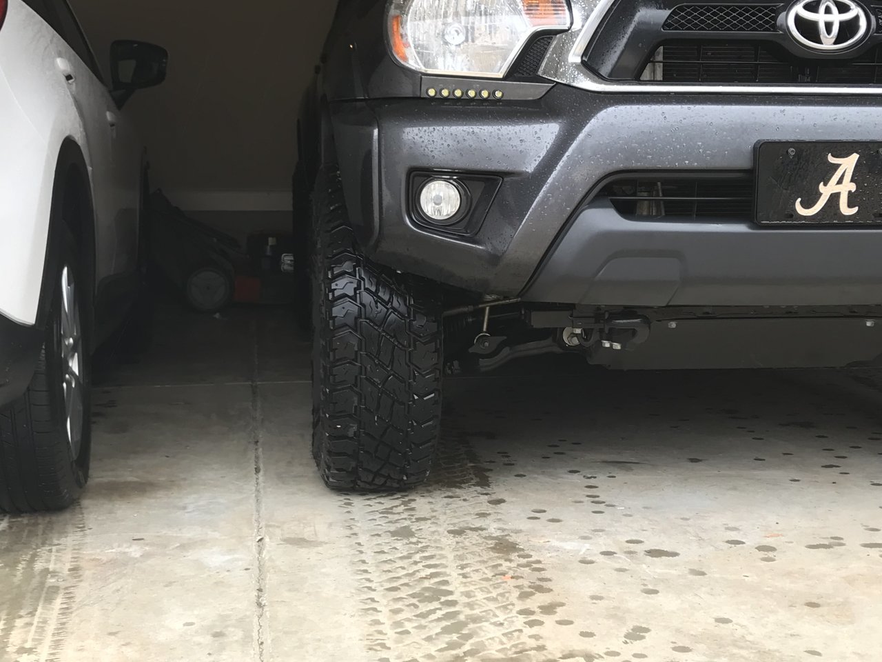

    I’m about to put some 1.25” spacers on my OR wheels myself. This looks great. While my tires aren’t as beefy as yours, this gives me a good idea of what to expect.
    Good lookin truck man!
    Ngneer likes this.
  10. Mar 29, 2018 at 6:12 AM
    #50
    BamaTaco56
    Mar 25, 2017
    #214383
    10,308
    Trey
    Thanks brother. She does look good from the back, but i only run the spacers out of necessity. Make sure you get some good quality hub-centric spacers (like spidertrax).

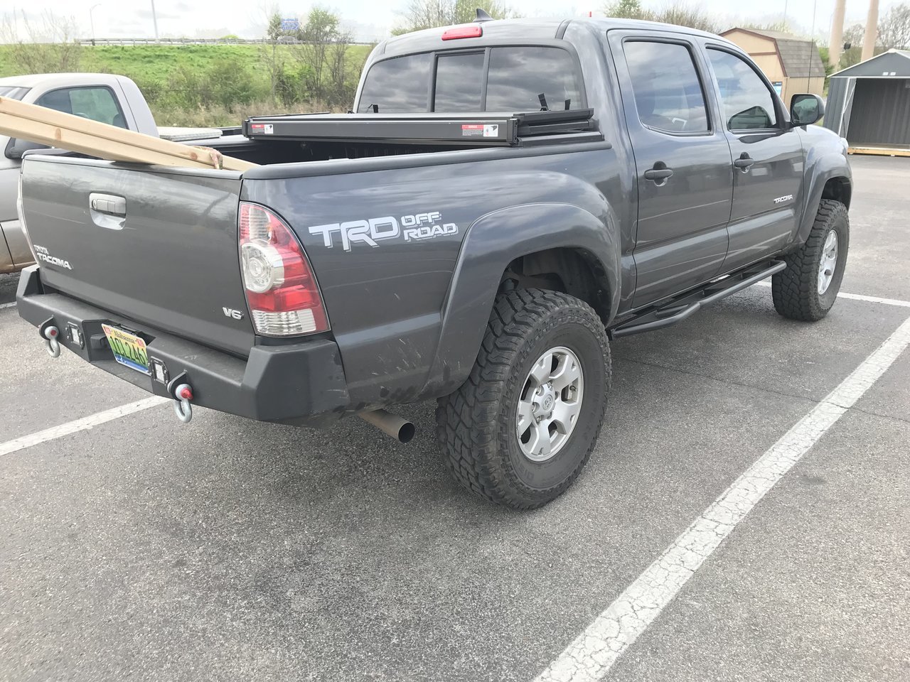

    Gotcha! I was going to wait for my tires to run down, but ended up being forced to buy quicker.
    Found this on the way to the interview for my current job.
    Ngneer likes this.
