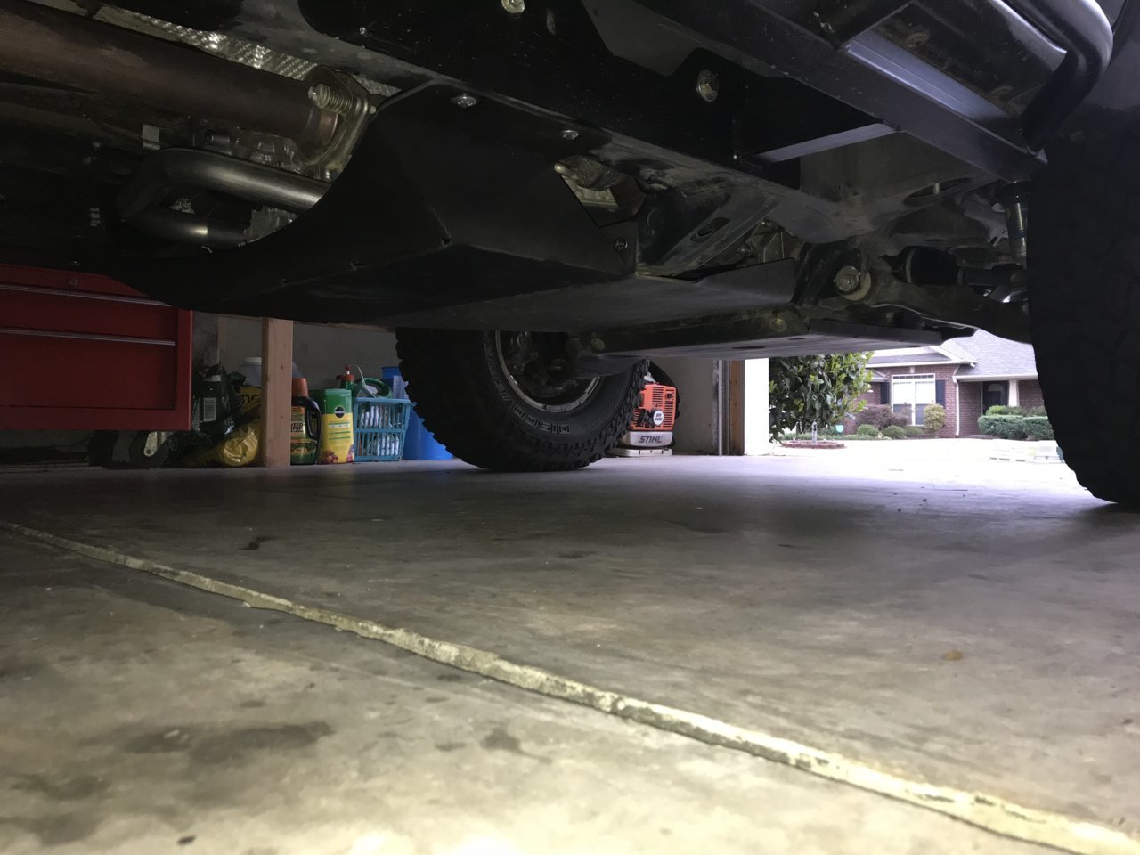

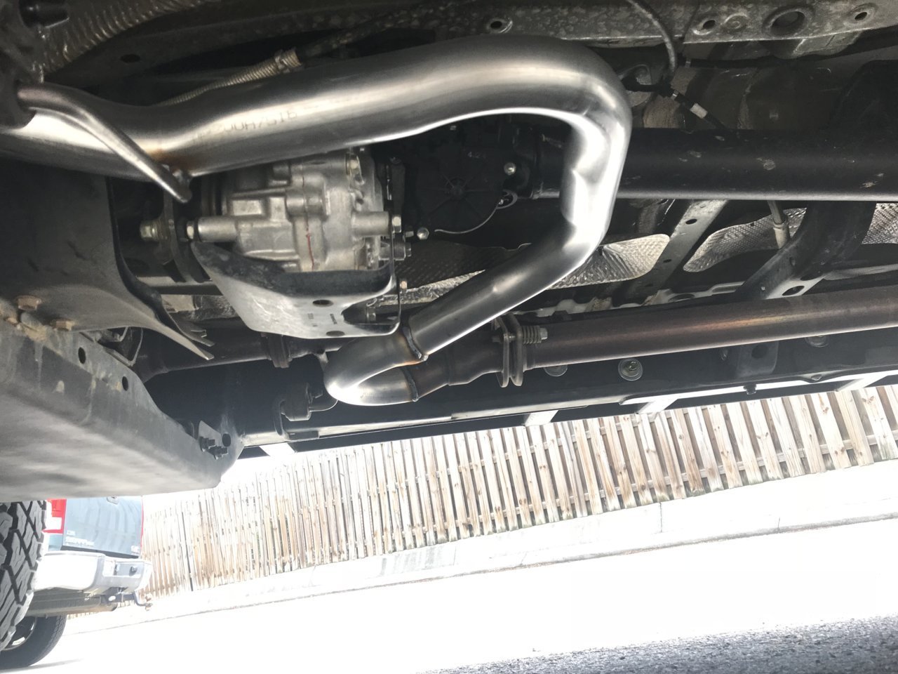

    Got the Exhaust rerouted today. Transfer case skid going on soon.

    Got the transfer case skid on.

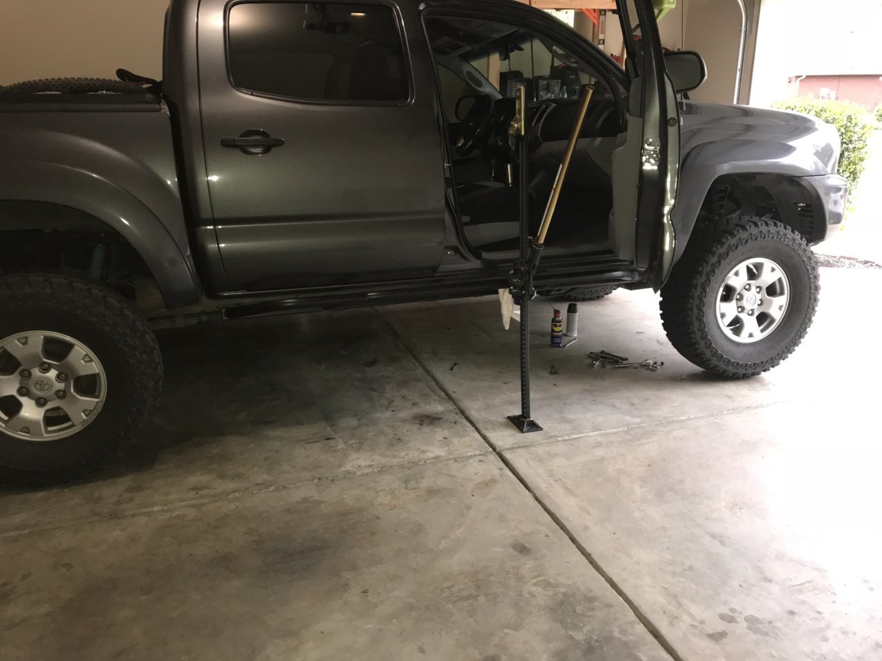

    Also tested out the sliders as a jack point with a hi-lift. Only went up enough to get the front tire off the ground.

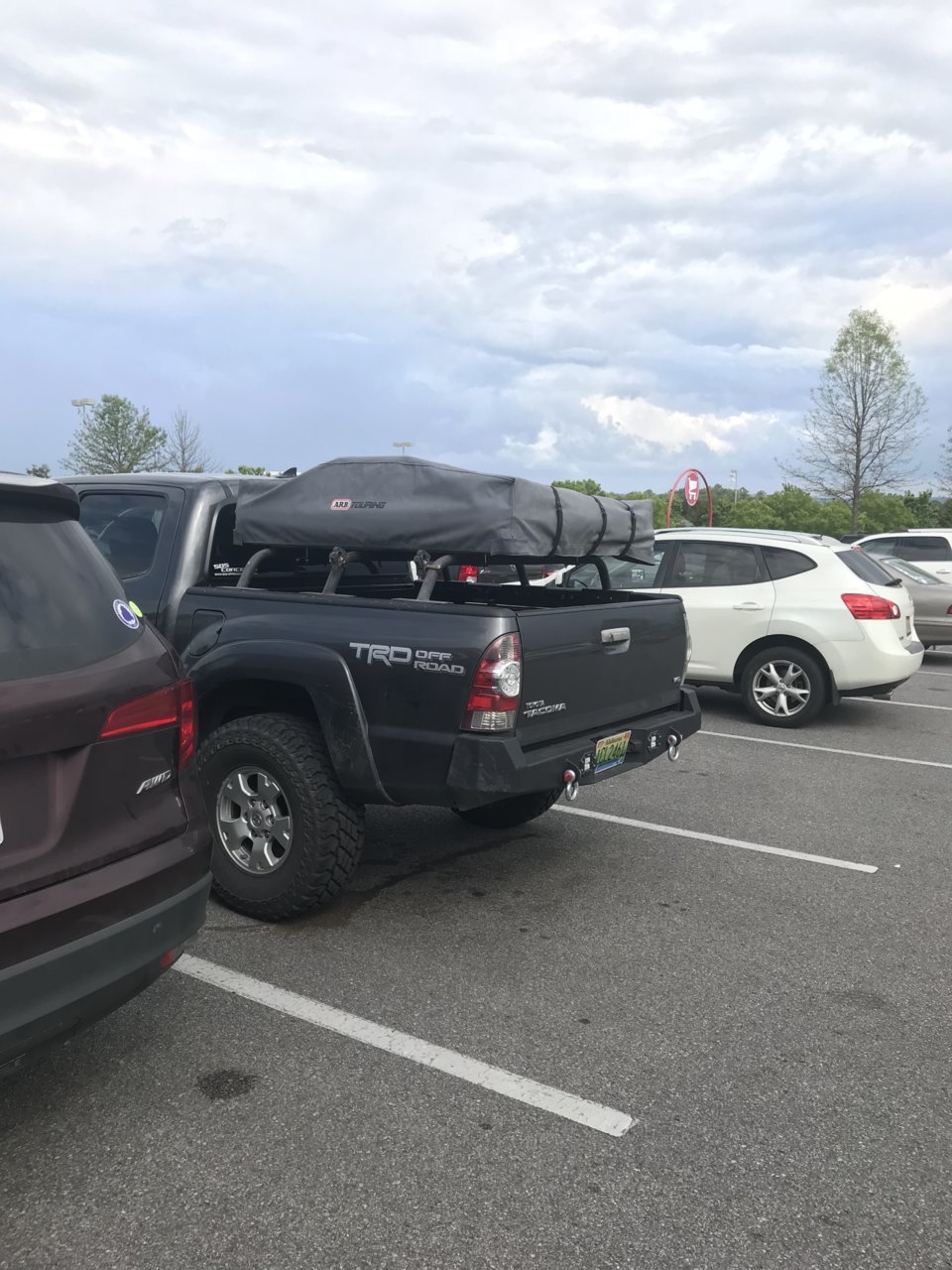

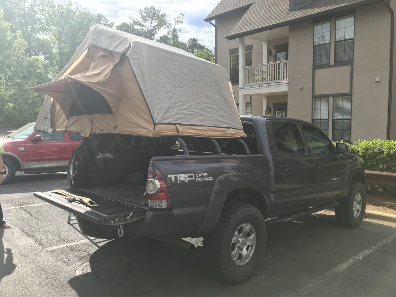

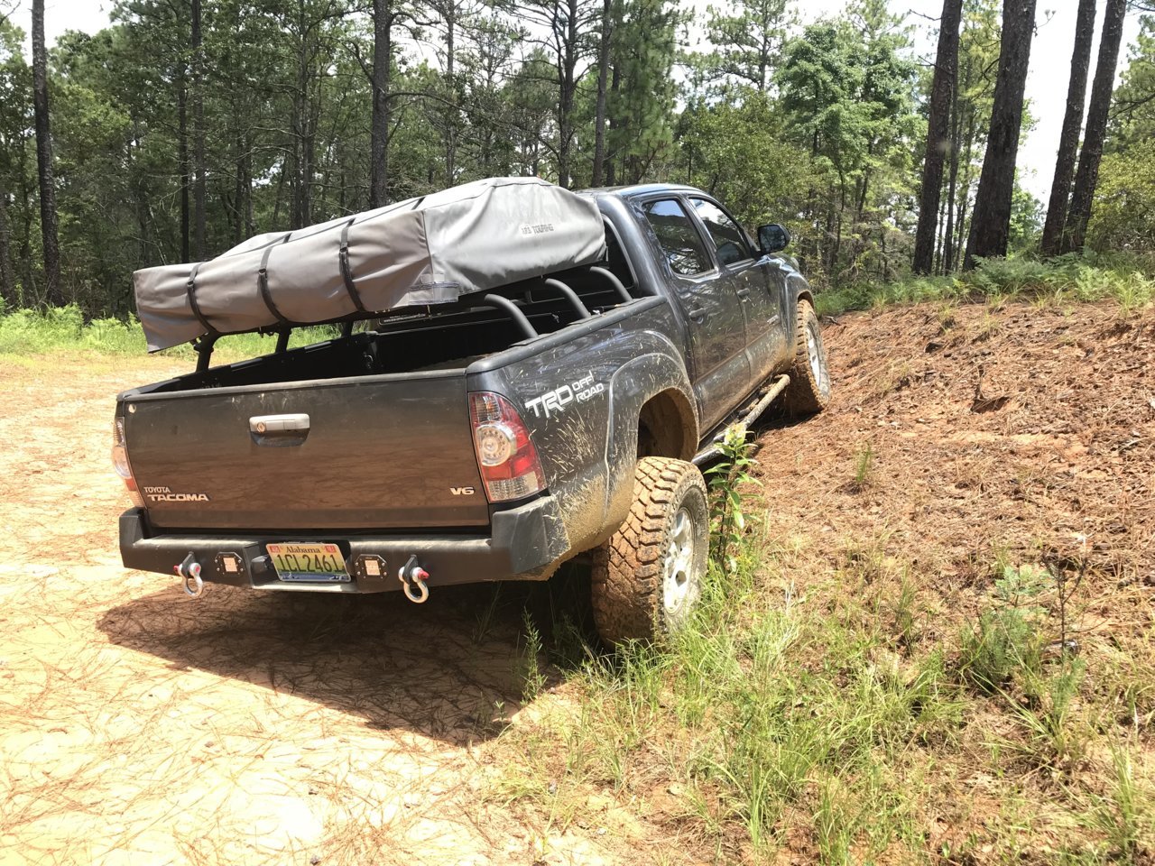

    Also picked up an ARB Simpson III over the weekend. I might as well sell all my armor now because #overlander.
    Have to include the picture in the target parking lot. :rofl:

    what bed bars? thought you were doing KB voodoo?
  9. May 8, 2018 at 8:07 AM
    #69
    BamaTaco56
    BamaTaco56 [OP] Well-Known Member
    Mar 25, 2017
    #214383
    10,308
    Trey
    The KB Voodoo bed bars were from another deal that I wasn’t able to make work out due to timing last weekend.
    The tent is sitting on 3 All Pro bed bars.

    I originally wanted the KB Voodoo bars so I could run the tonneau cover under the tent. However, I now think it would restrict the access to the bed way too much. With the locking tail gate, I can secure my stuff in larger storage containers that wont be able to fit through the openings to get them out of the bed.

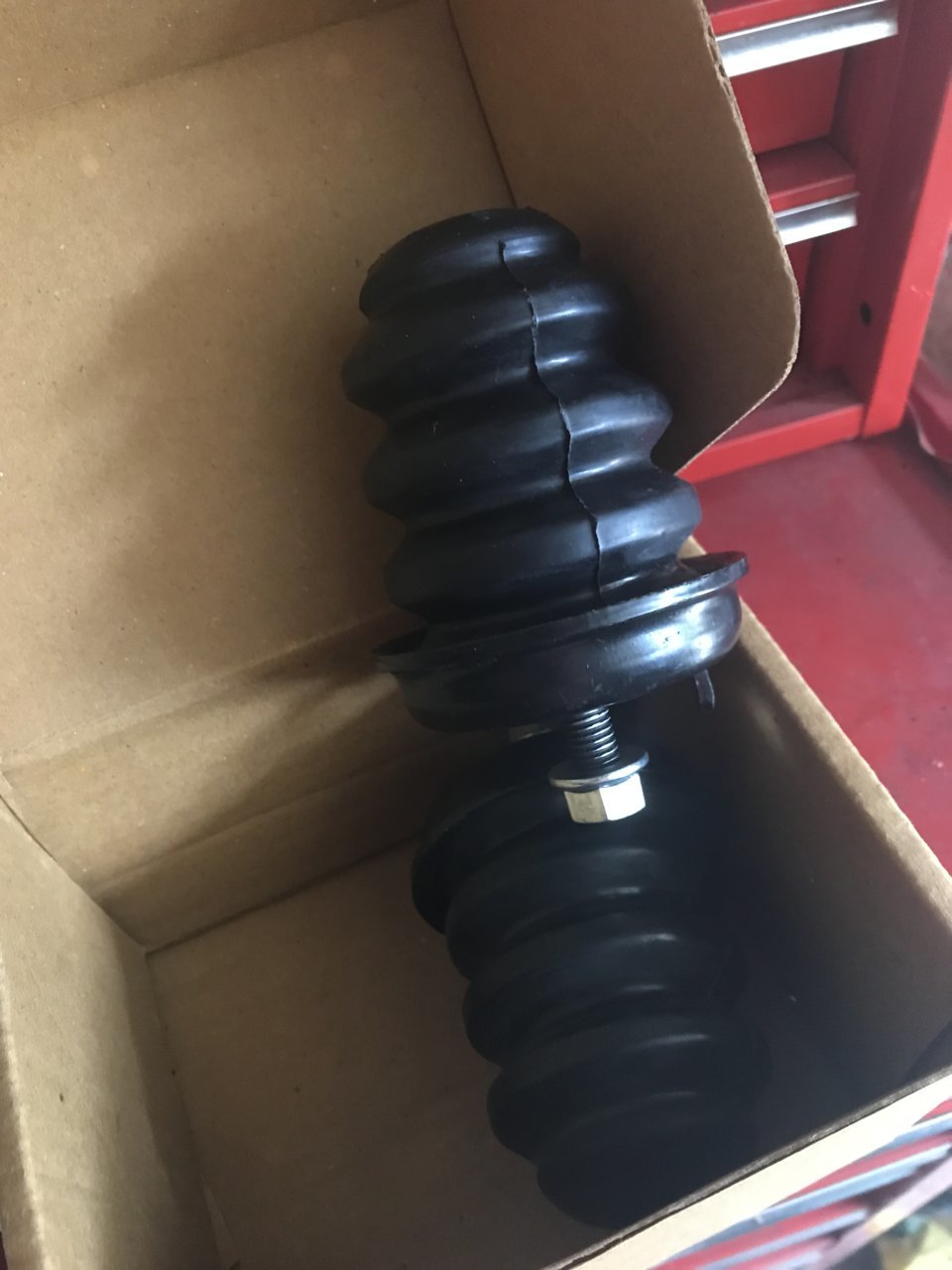

    Finally got the Silverado bump stops for the top down setup in the rear. With some minor adjustments, they should keep an 11” shock from bottoming out and keep my tire off the fender flare at full stuff.

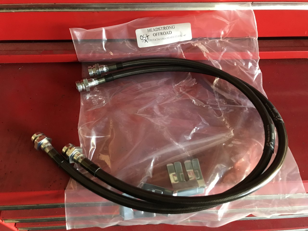

    Extended brake lines came in yesterday.

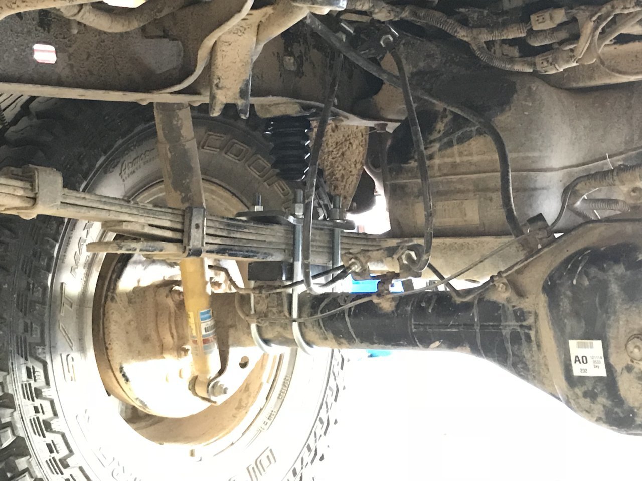

    Busy Sunday.
    Switched from OME 885 to 886. Installed extended rear brake lines and a temporary 1” block until I get a new leaf pack.

  16. Jul 5, 2018 at 8:04 AM
    #76
    BamaTaco56
    Mar 25, 2017
    #214383
    10,308
    Trey
    Wheeler's U-Bolt Flip and Silverado bump stops installed yesterday. Thanks for the great customer service @Wheeler's Off-Road Inc !

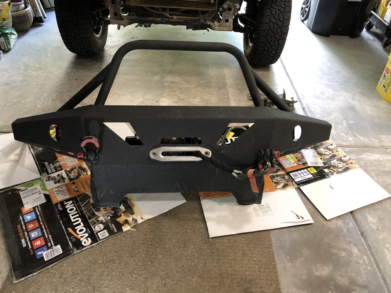

    Coming soon.....

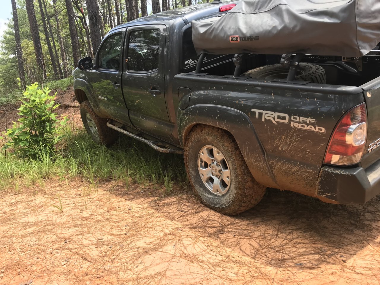

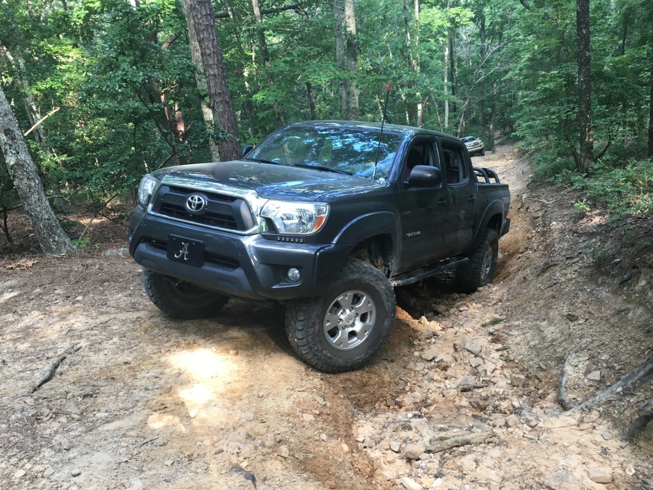

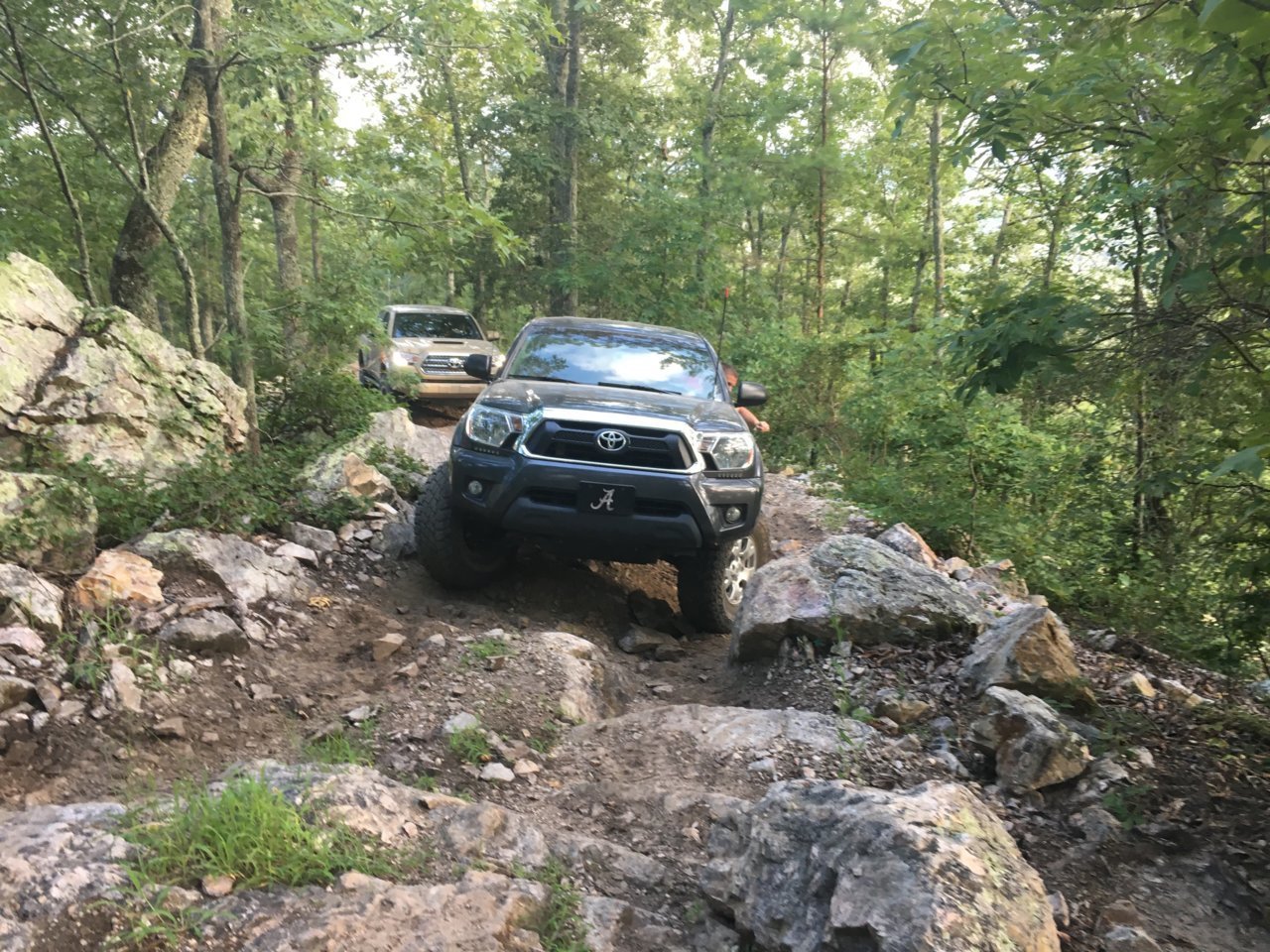

    Choccolocco Mountain 7-14-2018

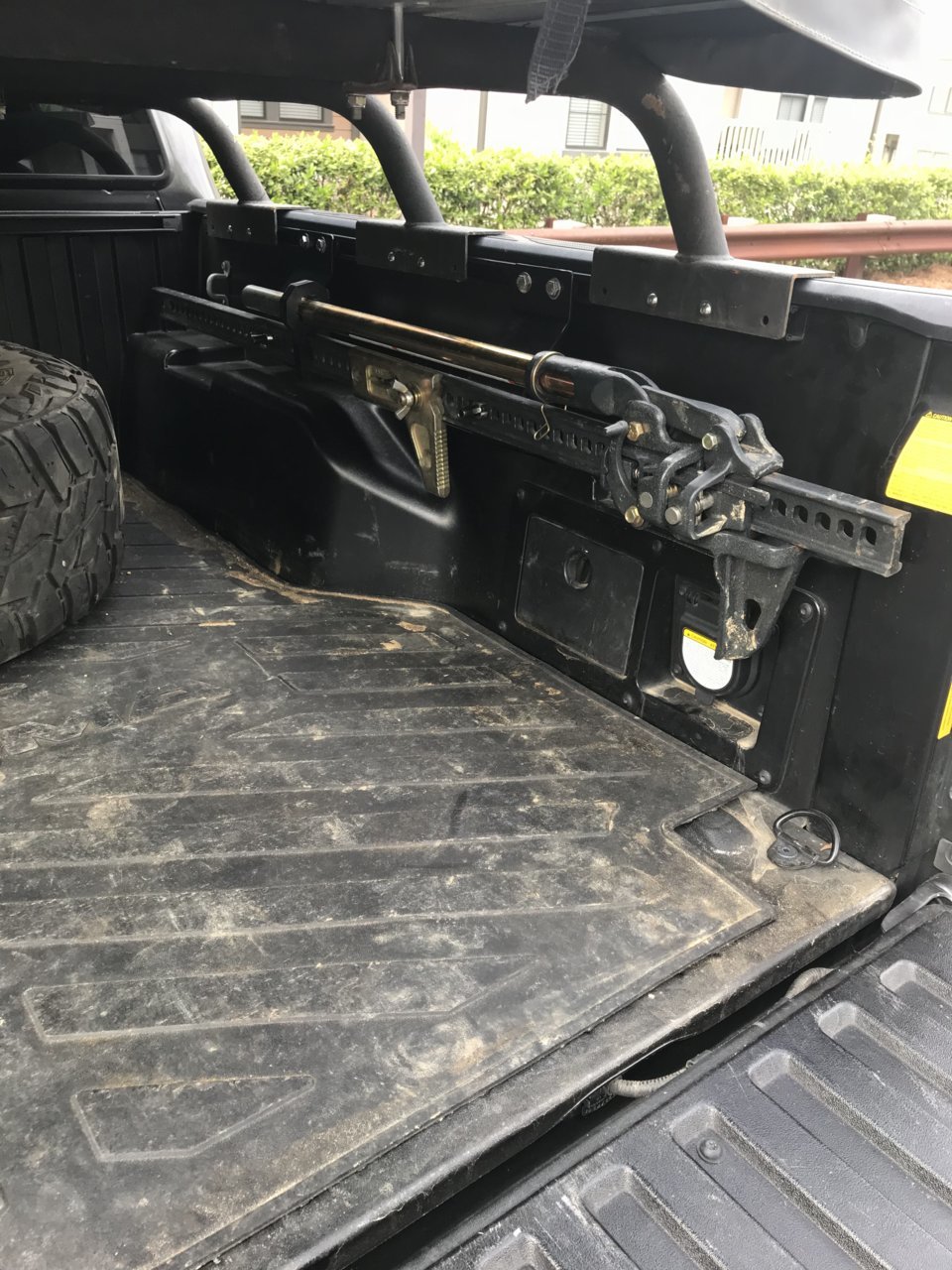

    Late update to the thread. the 60" Hi-Lift fits perfectly in the bed stiffeners from At the Helm.
