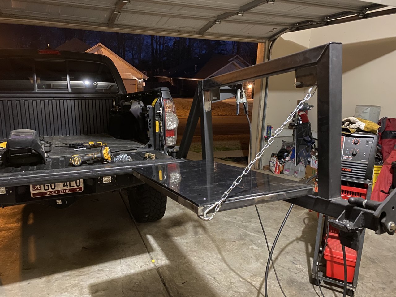

    Thanks!

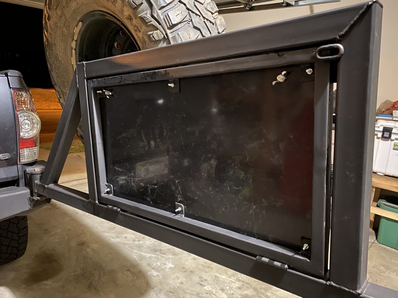

    there will be a 5 gallon can for water and a 5 lb propane tank beside the tire, and a fold down table on the other side.

    Ready for paint

    Did you finish it up?

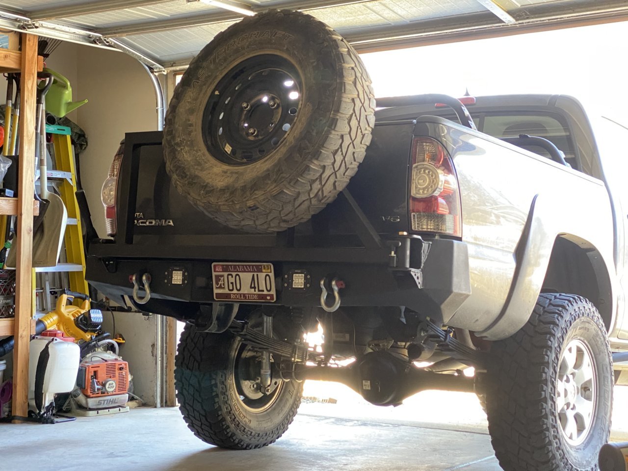

    I did! Don’t have great pic of just the finished product, but here is what I have. Had to reinforce the bumper so it would t flex with the weight of the swingout, but it’s a tank now.
    ignore Matt’s stove....

    Man looks great buddy. Great Job. Hopefully one day ill be able to make some cool stuff lol.

    Thanks! I redesigned the table 3 times while I was building it. I was supper happy with how it sits inside of the main frame of the swingout and adds no width when it’s closed.
    you will be able to! Just play around with it until you figure it out. I have only been welding for just under a year and still have a lot to figure out. Being able to make accurate cuts makes the world of difference, and was the biggest game changer for me.

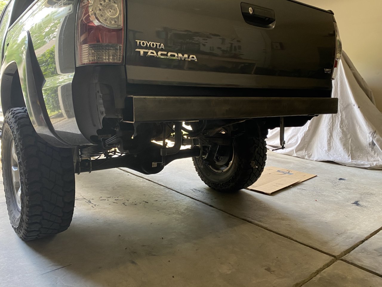

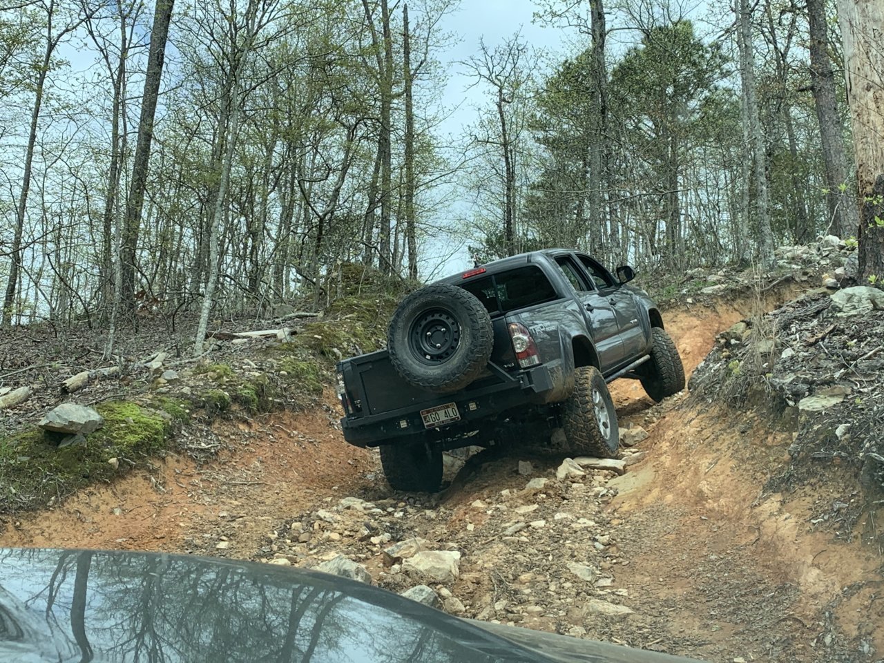

    Apparently my swingout didn’t move at all while bouncing around choccolocco. I’ll take that as a win for my welding abilities.
    Thanks for watching my rear all day Scotty....

    it was purdy. that thing didn't move a bit.

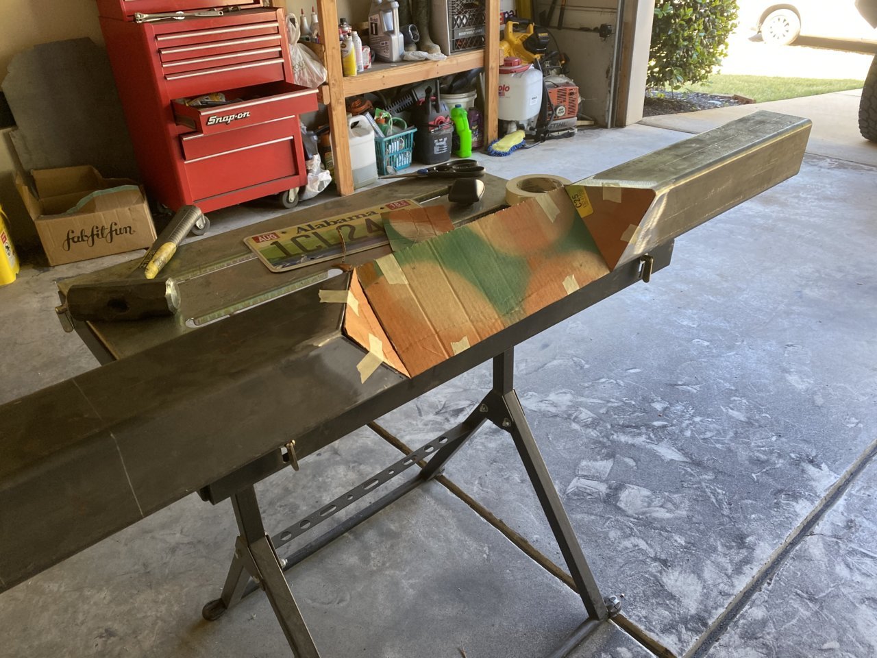

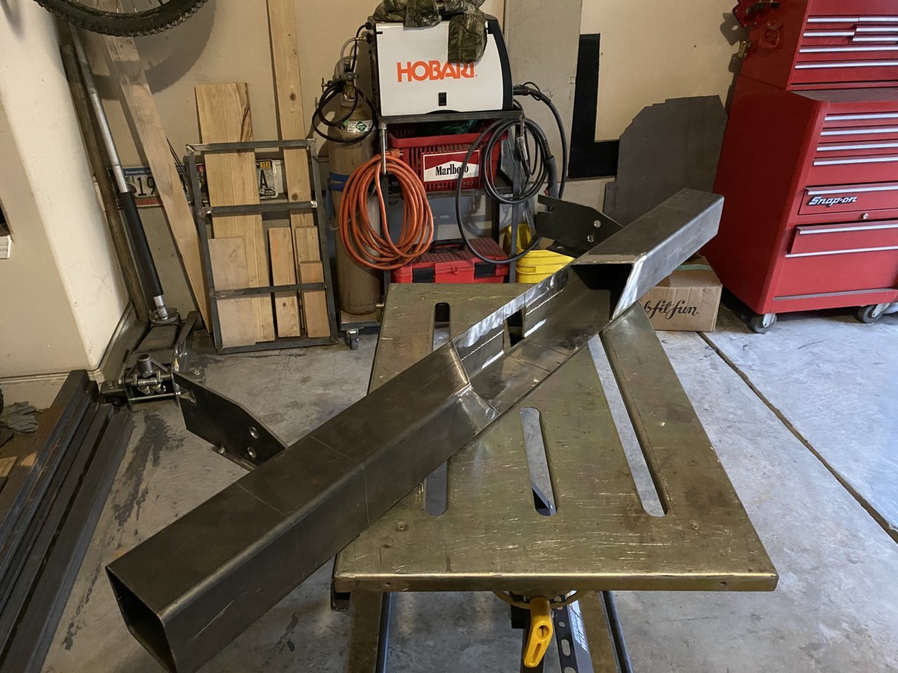

    High clearance bumper progress.

    Nice! Is the main beam a 4"x4" tubing?

    Yes. That seemed to be the standard for building a bumper. Makes it very easy to line up.

    I am meeting someone to sell my current bumper on Saturday, so I have to get something part way finished before then. My nights after work are pretty much 100% focused on this build.
    I wanted something a little different than others have built, so the design work takes a little longer
