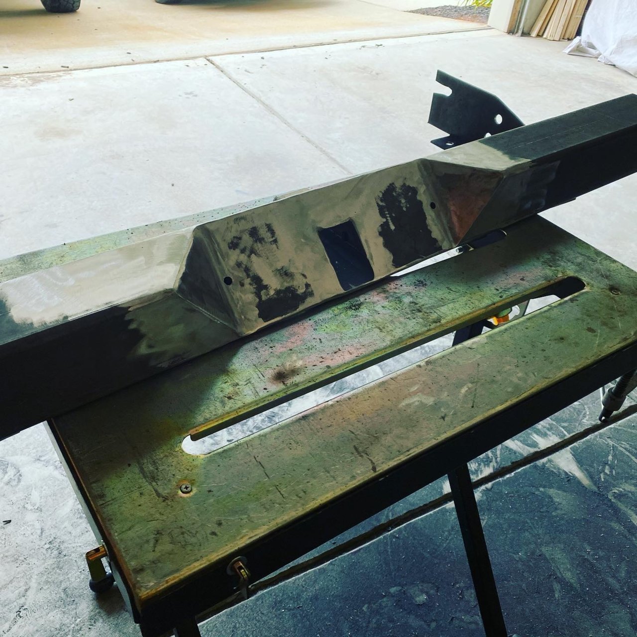

    Update

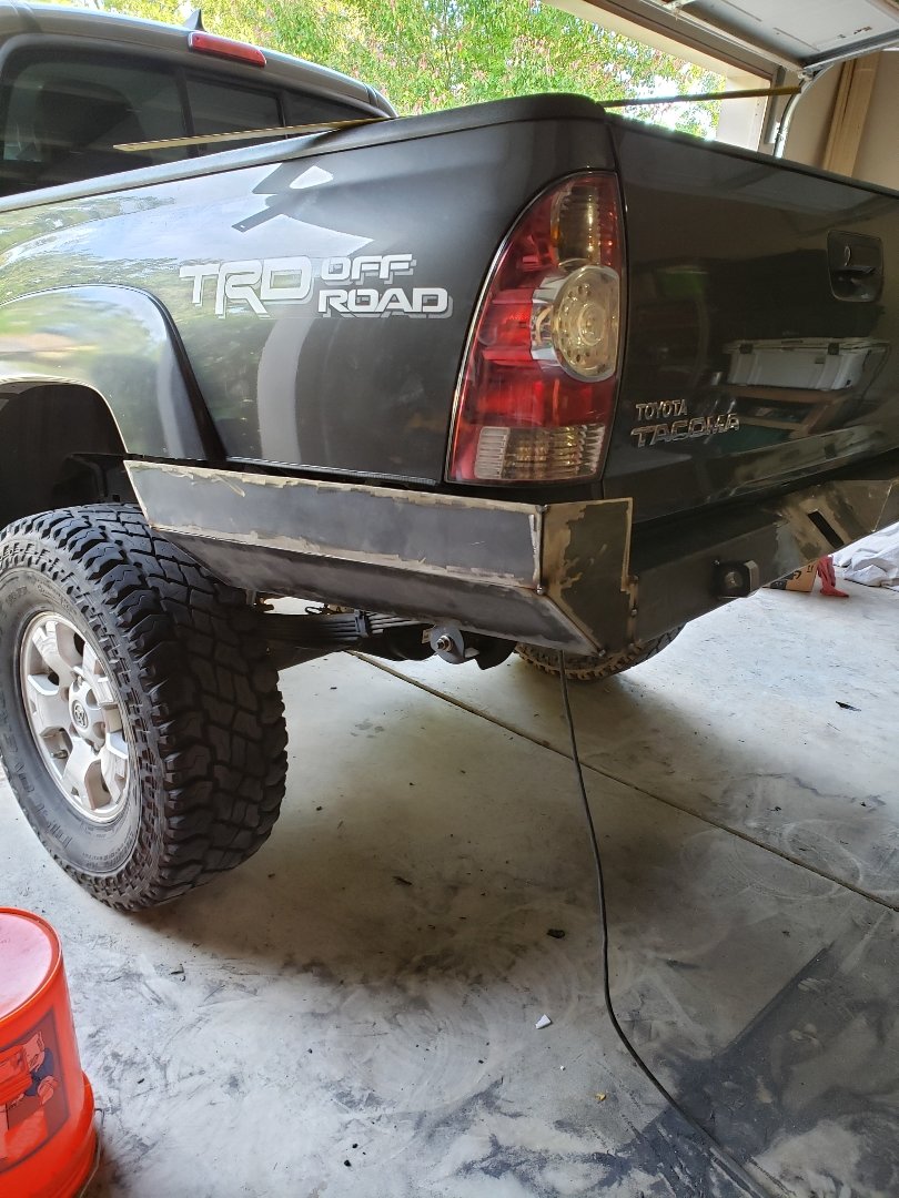

    That's a different spin on a rear bumper. I like the triangular shape to it!

    Don’t need negativity in here
    It is mostly square. The tag is just angled to not rob ground clearance.

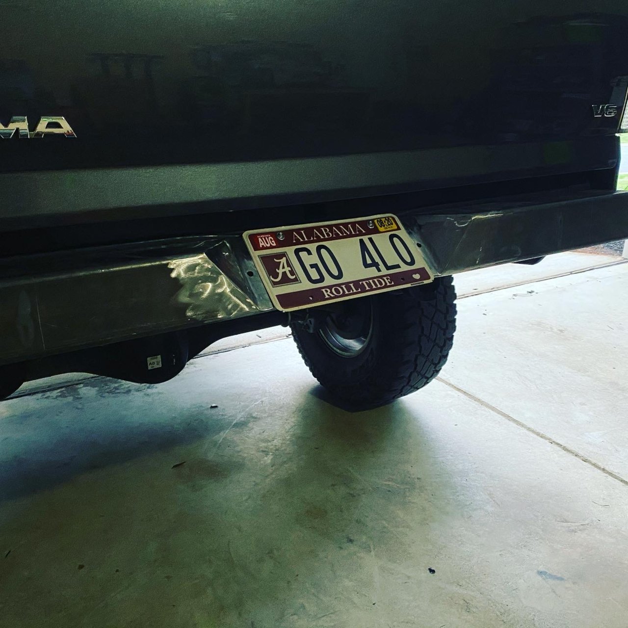

    Are you doing a swing out? If so why not just mount the tag to that?

    Not at first, but eventually I will. I don’t want to have to put tag lights on the swingout.
    the tag area also sits my bumper apart from all the ones similar to this design

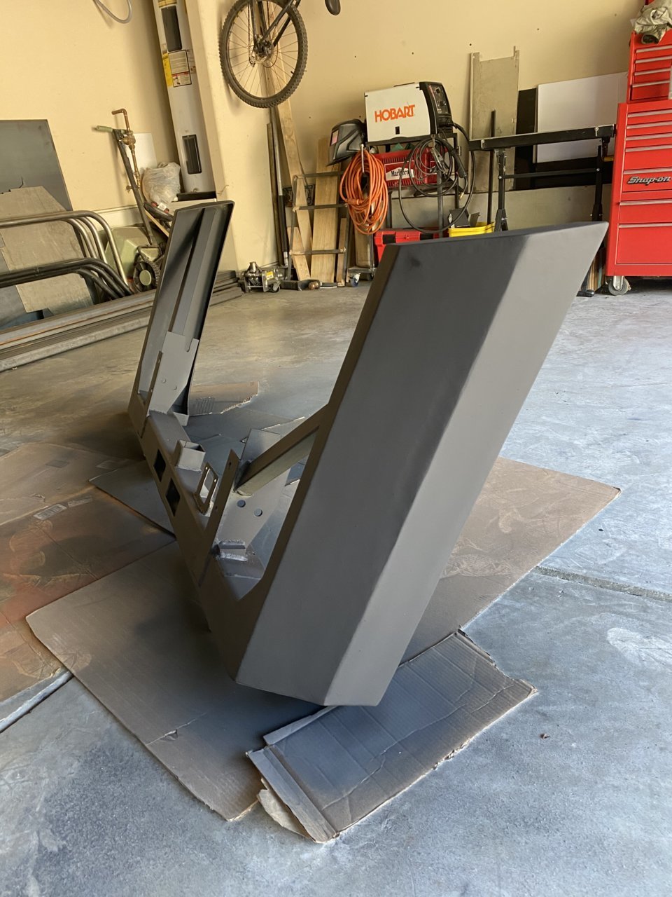

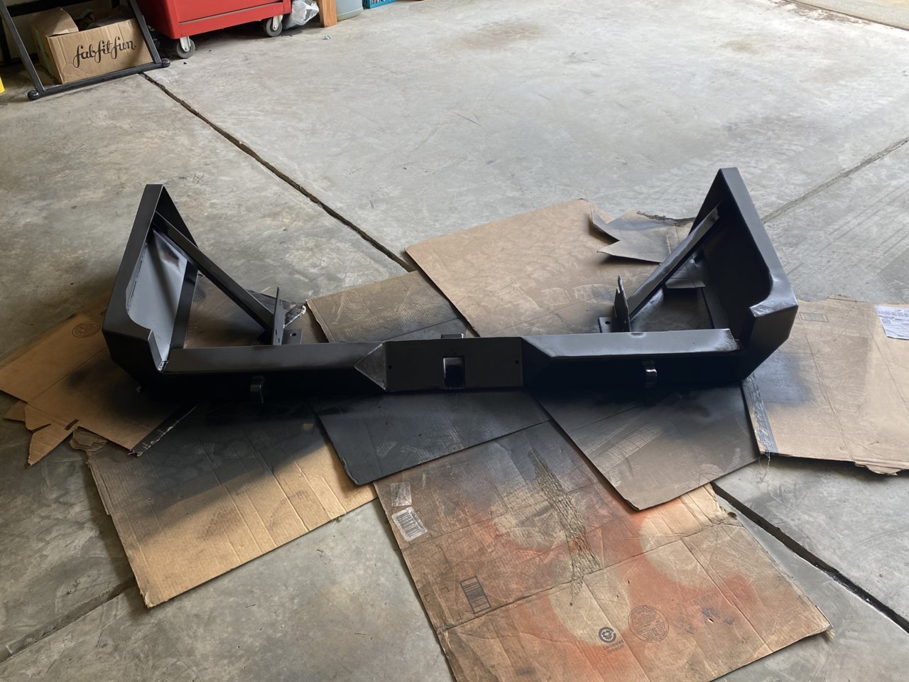

    More bumper build pics

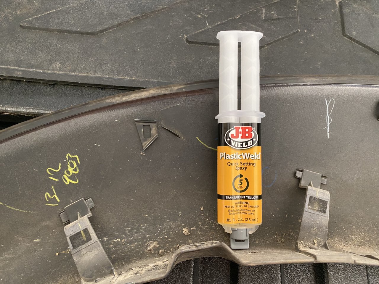

    Jacked up the fender flare and had to JB weld it back together. I have heard of people breaking the clips but not the actual fender flare clip retainers.

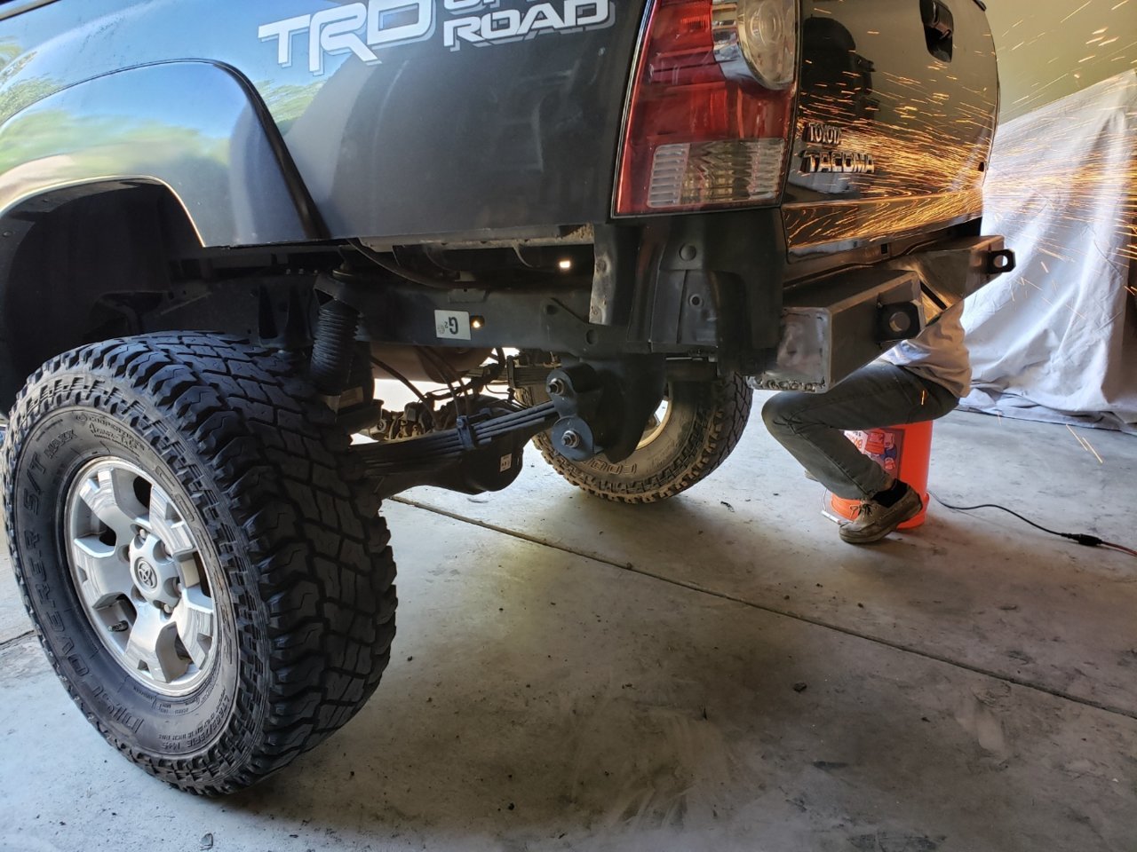

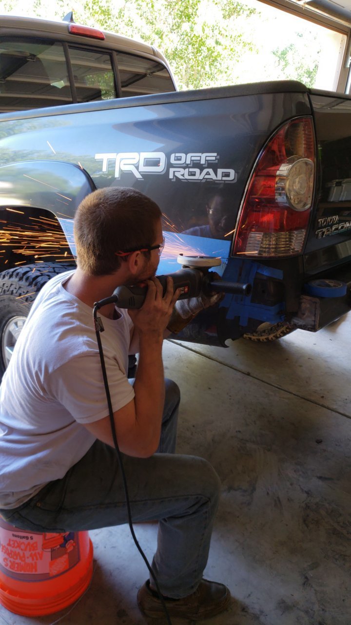

    Looks awesome bud, good job!!! How did you measure for your cut?

    I marked a point 1/4” below the tail light and took that measurement from the top of the bed rail (came out to about 17 3/8”). I had someone holding a straight edge with a level ontop of the bed rail and measured from the bottom of the level straight edge.

    Bumper is looking killer there Trey, nice job!

    Thank you! I’m just waiting for my wife to help me put it on the truck

    How heavy is it?

    I honestly don’t know. I can lift it myself pretty easily, but I can’t get it aligned without help.
    maybe 100-120
