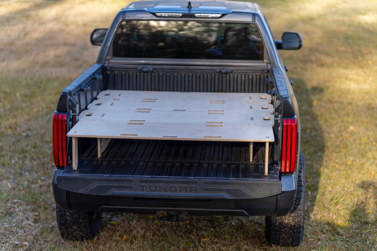

    3rd Gen Tundra Platform just Released! This platform has a very precise fit, thanks to a super straight and square bed profile from Toyota.
    Lead Times 1-2 Business Days, Shipping is Included in all of our Prices
    Order Here: https://bambeds.com/products/bambed-tundra-22-present-1
