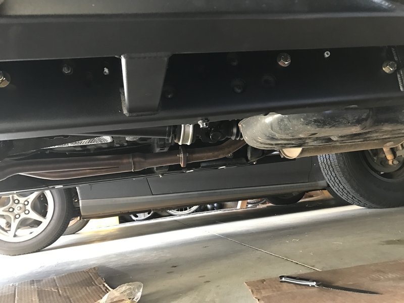

    I only found spots for 5 1/2x1.5 bolts along the frame (not including the front legs), so I used 12 total (of 16 packed). Doubt it's going to go anywhere, but I can't see where the extra bolt goes on either side. Attached are pics of driver side.

    I can see one that your missing right above that lower bolt on the frame inside the crossmember there should be a spot for one more.

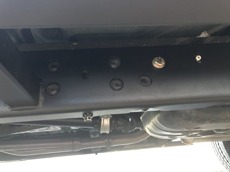

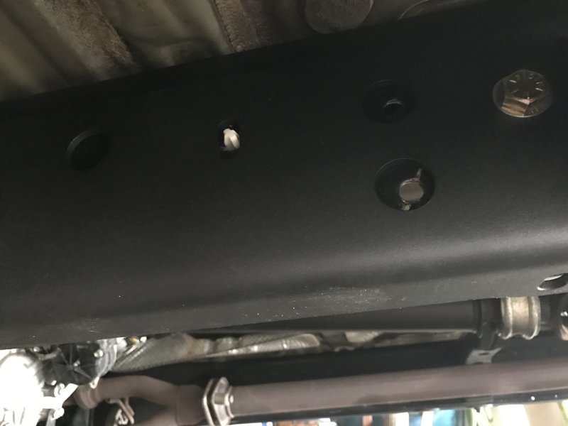

    Drivers side. Parked on top of my roommate m currently, I'll get passenger side shots later. There are holes lined up on that side, but the larger bolts don't feed through.

    I lost track thousands of dollars ago.
    It must be a mid year change on removing that hole I don't think the 2017's have it as well.

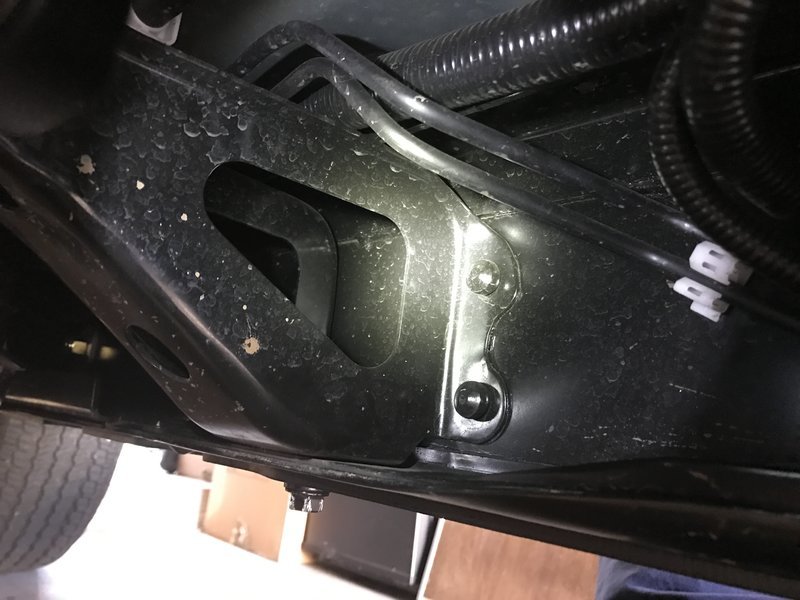

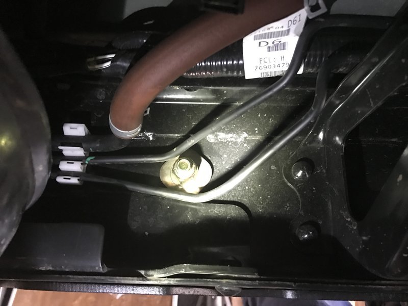

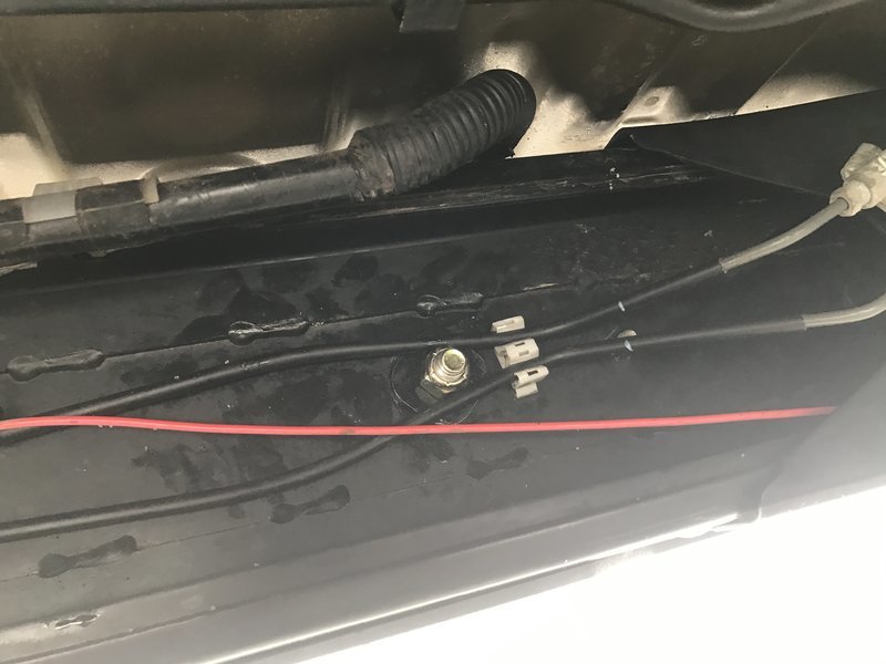

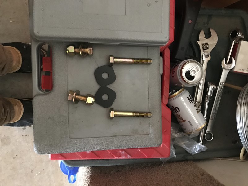

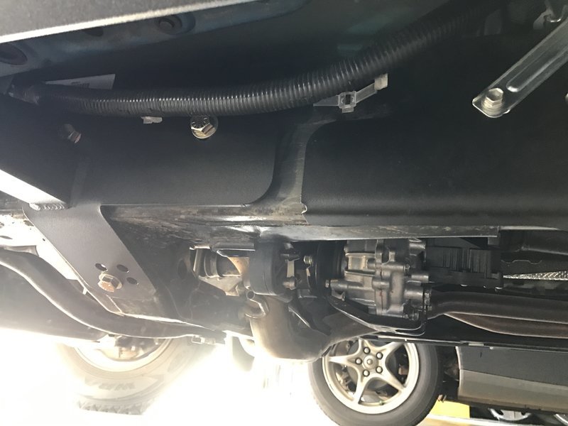

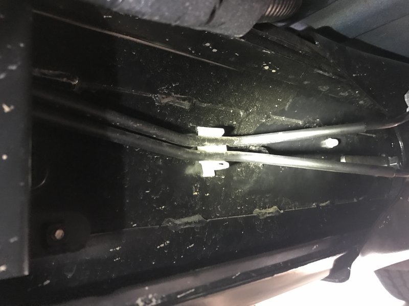

    Finally got around to installing these things and they are sweet!IMG_0777.jpgFew questions on the install just to make sure I did everything correctly. For the long bed how many total bolts are on each side? Right now I counted 9 per side but still have extra bolts here:IMG_0789.jpgI can't seem to find anywhere else for these bolts, especially the long ones. Is there supposed to be one on the bottom next to the factory crossmember bolt:IMG_0778.jpgOr this looked like a spot for one but it's just solid frame behind the opening to the left and the bolts don't fit through the other two:IMG_0787.jpgFinally, just wanted to make sure these brake lines look ok to you, the bracket seemed very close to the bolt and wasn't sure if rubbing is an issue:IMG_0785.jpgThanks!

    The long ones should be in the rear of the slider if you have a 2010+ truck the others might of just been extra that lower hole pictured is for the crossmember it's in that location on the 2WD.

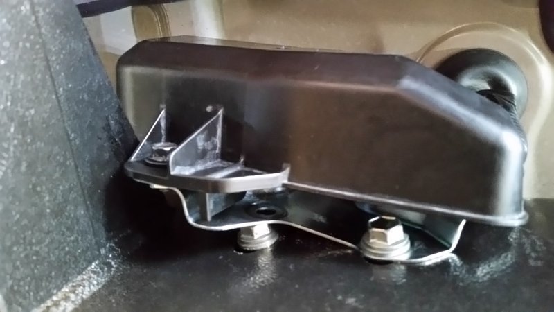

    Do this before taking out the bottom bolt, so you won't mess up the bolt when taking it out. Please see picture. I did not and bolt seems a little damaged but useable.

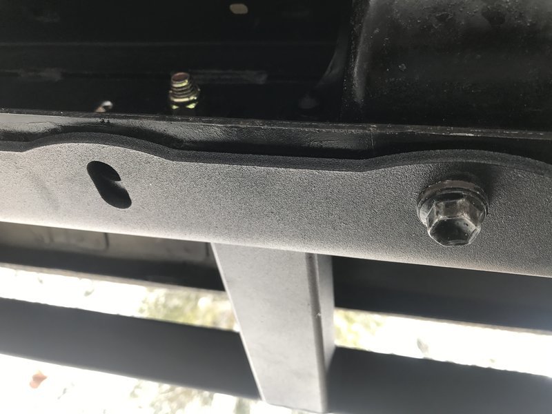

    Does this look acceptable? I just changed the angle a little bit so the black box could fit. The bolt helped to push the bracket a little.

    That should be fine we normally recommend moving it forward but that is fine as well it's just a plug and a bracket.
