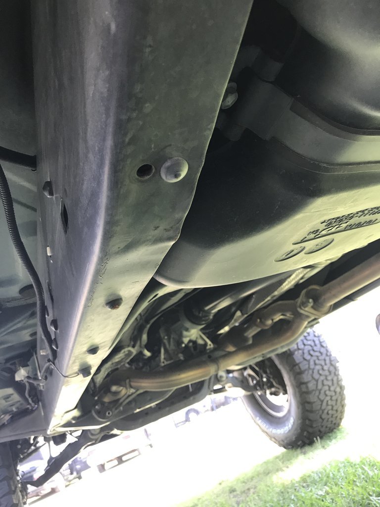

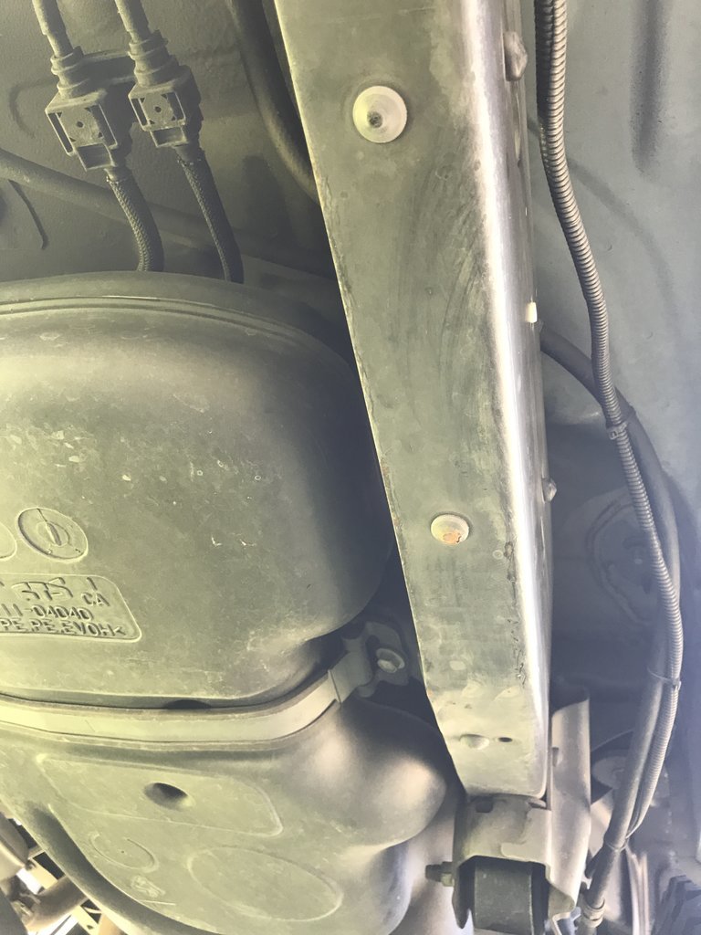

    So since I have an 08 and have the three rivets rearward on my frame, I'm gonna have to drill out holes on the freshly powdercoated sliders? I'm afraid to grind down the rivets where they are flat with the frame.
    My sliders just arrived at my house today.
    Edit: were changes made where I can expect holes to already be on the sliders or do you recommend using a cutoff wheel to grind the three rivets flat with the frame?

    I think it's only the 05 on the DCSB that needs to modify them. The quote above was a DCLB slider

    These are the 3 rivets on my frame on both sides. 08 DCSB 2wd.

    Fit the slider up before you cut or drill anything I'm pretty sure the 80" sliders clear those rivets.

    Roger. I'll test fit one tonight when I get home and get back to you!

    Just realized I never posted back, the 80” sliders cleared all rivets. Still holding up strong, I love em! Had a couple people open their doors into em and get pissed :rofl:

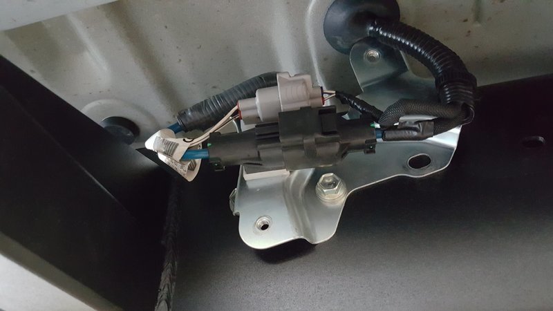

    I just installed the passenger side 80” slider on my early ‘16 (Nov 15 build) DCSB. Fit was perfect. No weirdness with extra holes, rivets etc. Really, the job was about as easy as could be expected for a 65 pound 80” long hunk of steel, installed by a 60 year old guy, by himself, stock height truck sitting on its tires. Crawling in and out to get the tools I set down out of reach was probably the hardest part. I did make a slight mod to the black plastic box that covers the wiring harness connection on the passenger side. When I moved the bracket forward and position it so the cover could be reinstalled, I felt the tab at the top end of the bracket was making too much contact with the grommet where the harness passes through the floor. It’s pretty clear in Jerry’s photo:
    So I cut the tie wrap which gave enough slack in the harness to rotate the bracket down, and also trimmed some of the black cover away to clear the harness, and re-tied the harness in it’s new position. I’m very comfortable with just one screw attaching the bracket to the frame, but felt the tension in the harness and contact of the sheet metal edge against the grommet might cause problems down the road without my mods. With that change, and my generally slow and steady work, the one side took me about 2 hours. Yeah, I probably wouldn’t last long in a flat-rate shop. Tomorrow, driver’s side.
