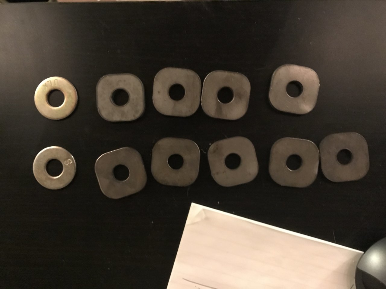

    I only got round washers and no square ones when my sliders arrived a coupe of months ago. When I asked I was tolds that it didn't matter. Seems a bit inconsistent.

    I don’t mind the new hardware, these new square washers seem way beefier. I just want some clarification from @JLee like do I have all the parts? and where to use the square washers vs fender. One each bolt side and nut side? What about the 2 larger fender washers.

    Yes you have everything im assuming your the guy from the TW Express drop off. We were out of the fender washers so we just gave you some of the old washers we had laying around. And yes you need to at least prime all bare metal parts.

    I agree that they look beefier. I'm disappointed that I didn't get them. Seems like they ran out and just tossed whatever they had in the box until they got more. Now I wonder if I should source some myself. I shouldn't have to, but I might.

    You dont need the old washers they have not been used for years. We ran out of grade 8 fender washers so we gave him old washers that we no longer make so he could install his sliders.

    Got cha. From your instructions looks like the fender washers go on the bolt side and square washers go on the nut side. I counted 5 bolts on each side that would need a washer on the other end. So since I only have 9 steel washers, I should just use one of the larger fender washer on that remaining bolt side?
    Does that sound right?
    Thanks Jerry, slider build quality is amazing!

    Yep that's it if you have any more questions you can always email pics and and I walk you through it.

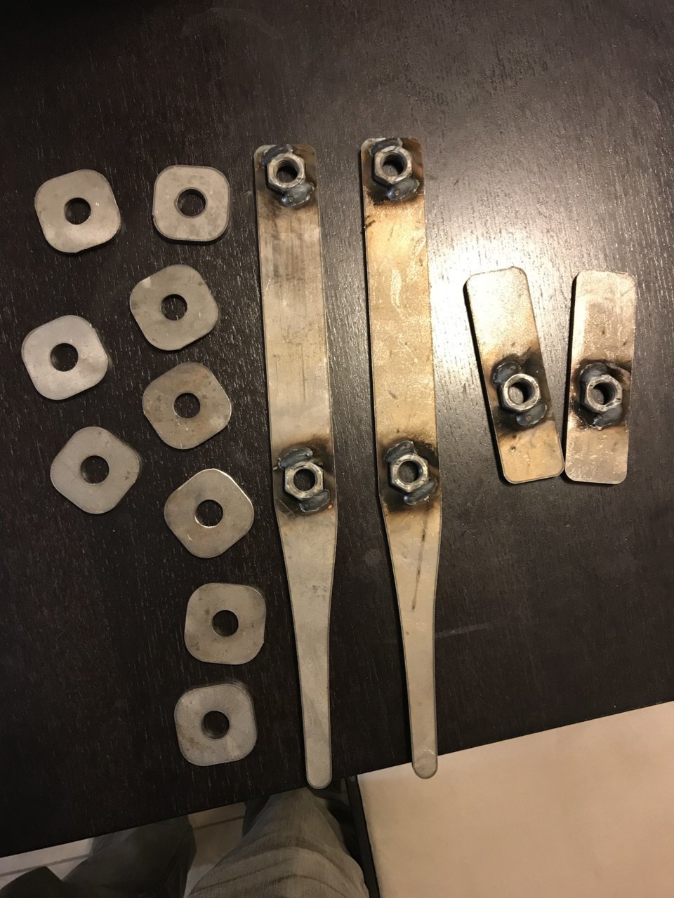

    So I finally got around to installing them today, went on pretty easy but I have 4 bolts left over. Is that normal @JLee ?
    I used 12/16 of the longer bolts.

    Yes it is the bolt packs are the same for 05 to 18 the older trucks have a few more holes.

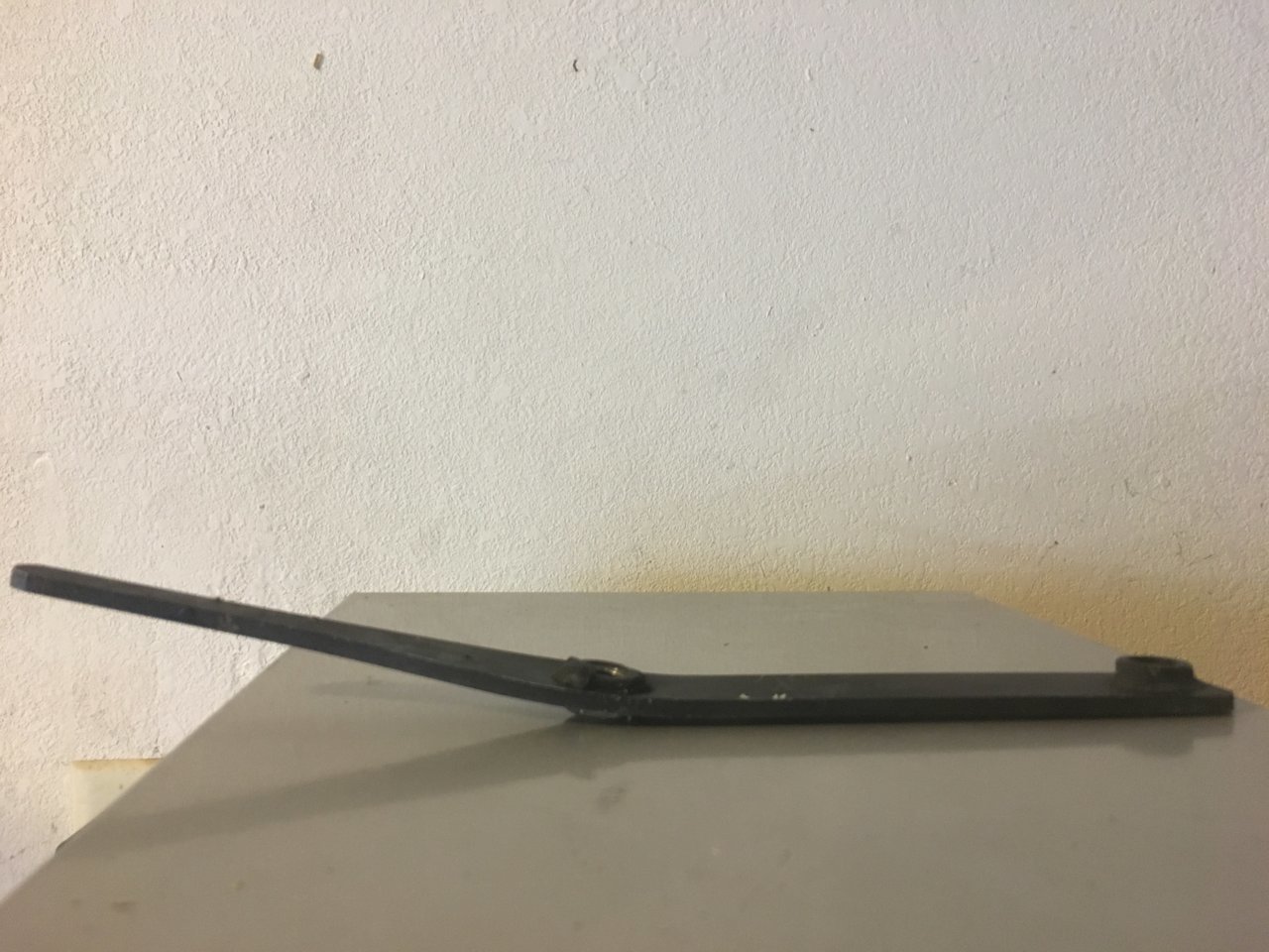

    You guys ship replacement parts? I need a new welded piece with the two top lock nuts. I'd be willing to swing by and pick one up as well if shipping a piece like that is a headache.

    You can come on by and grab one next week if you want.

    What happens when you don’t snug both bolts on the metal piece before torquing.
    Thanks @JLee for the replacement piece. Learned my lesson.
