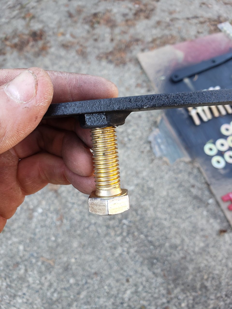

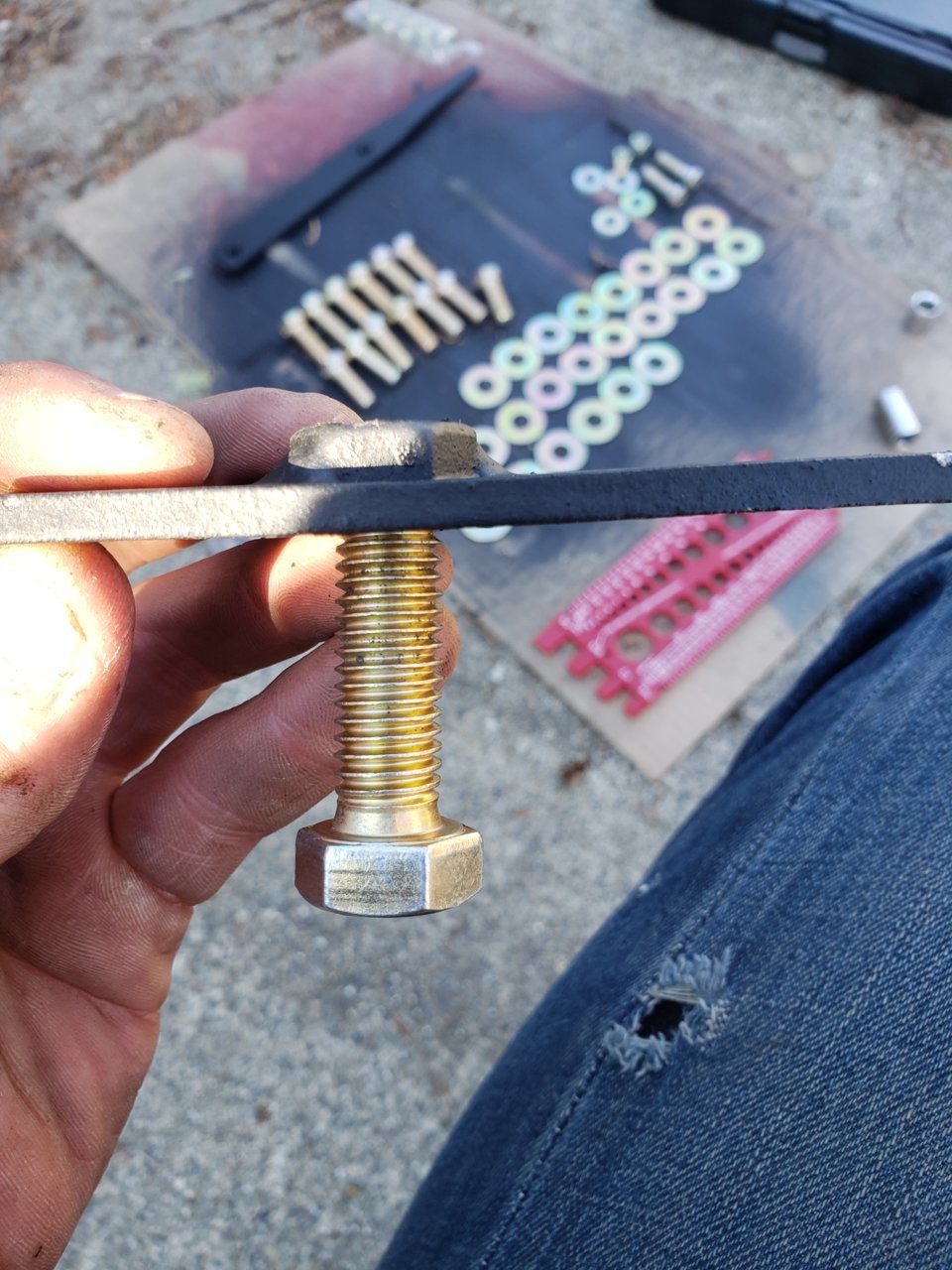

    The cross member welded washer part has 4 holes, does it matter if the welded nut it flush or extended facing the bolt for the slider ?
  18. Feb 26, 2019 at 1:29 PM
    #98
    JLee
    JLee [OP] The Man! Vendor
    Jul 20, 2010
    #40461
    19,606
    Jerry
    Benicia, CA
    02 Extra cab SAS Linked front and rear
    I lost track thousands of dollars ago.
    You want the steel plate to be flush with the crossmember. So the second picture is correct.

    Thanks for the quick response about to have at her again and turn it around
