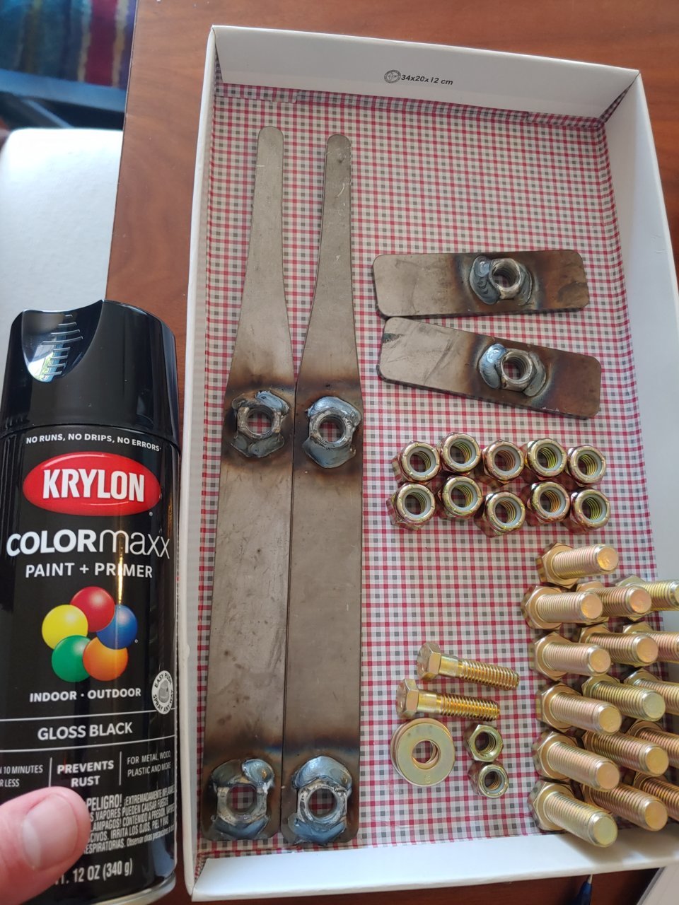

    K & N Intake, Gibson Catback (chopped), Weathertech floormats, 285/70/17 Ridge Grapplers, Black Rhino Glamis wheels, Kicker Key, Kicker Hideaway, Infiniti Speakers, OV Tune, 888's, 5100s X 4, HS 3-leaf, LR SPC UCAs, Diff Drop, Carrier Bearing Drop, OEM Bed Mat, Morimoto HID low beams, Morimoto LED 2 Stroke High Beams, KC 336 LED bar, KC C3 LED pods for rear, KC LED 6'' SlimLites ditch lights, N-Fab Steps, Auxbeam Interior Blue Lights, 7r41lbr34k3r Shift Knob, Wet Okole Seat Covers, Diode Dynamics SAE Pro Fogs, Cali Raised ditch light brackets, hidden light bar brackets, tailgate light brackets.
    Should i rust proof any other hardware other than washers?

    JLee
    JLee [OP] The Man! Vendor
    Jul 20, 2010
    #40461
    19,606
    Jerry
    Benicia, CA
    02 Extra cab SAS Linked front and rear
    I lost track thousands of dollars ago.
    The only thing that needs painted is the raw steel parts.
    Anderson and grubburg[QUOTED] like this.

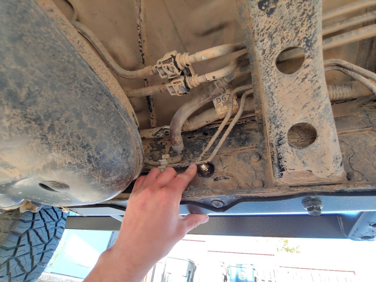

    Any problem with these lines rubbing against this bolt over time? 2020-03-26 18.20.13.jpg
