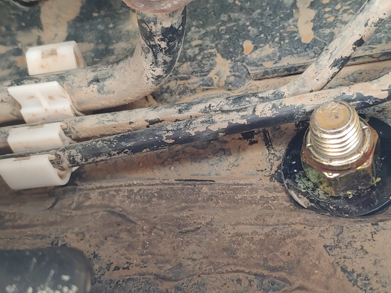

    how do you bend hard brake lines?
    hack saw tip of bolt off?

    You could of went outside and done it already by hand that's not necessary. And you would most likely need to pull the lines off the truck to use that.

    +1 to this, you should be able to just bend them enough out of the way by hand. easier than you think

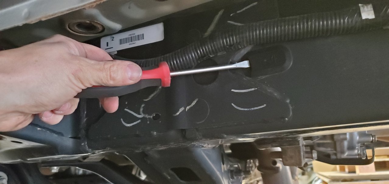

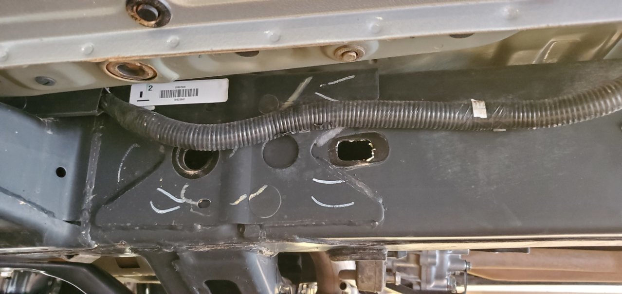

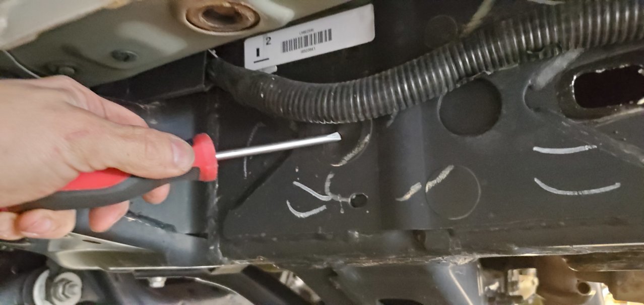

    I might be missing something, but it seems as though my 2016 does not have holes in the side of the frame towards the front. Is this a common thing with 2016s? As far as I can tell, I'm going to have to mock them up and trace out the hole, take em back off and drill two holes.

    You have a sticker and plastic cap blocking them.

    That black plastic cable hose is in my way, am I supposed to cut the zip tie and move it?

    Yep, I was too dumb to see that. Thank you, sir.

    They are held in the frame with a little clip no need to cut anything. Just pop it out and install the slider.

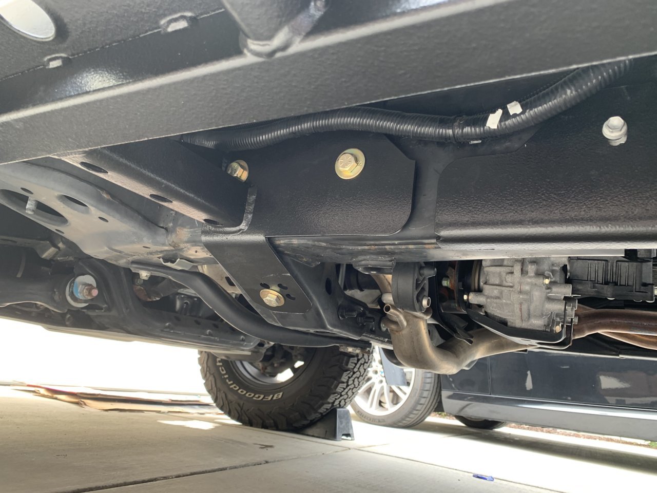

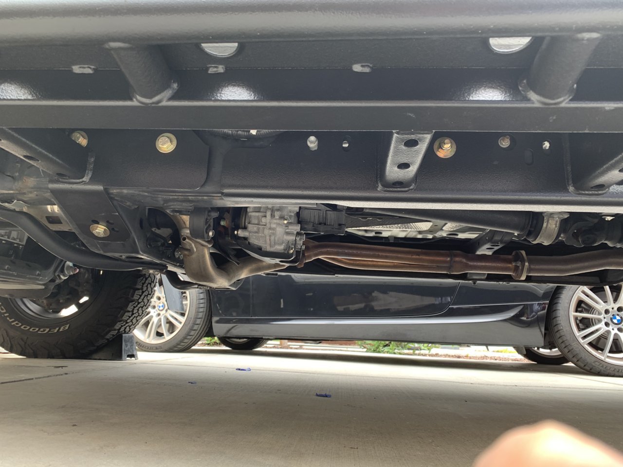

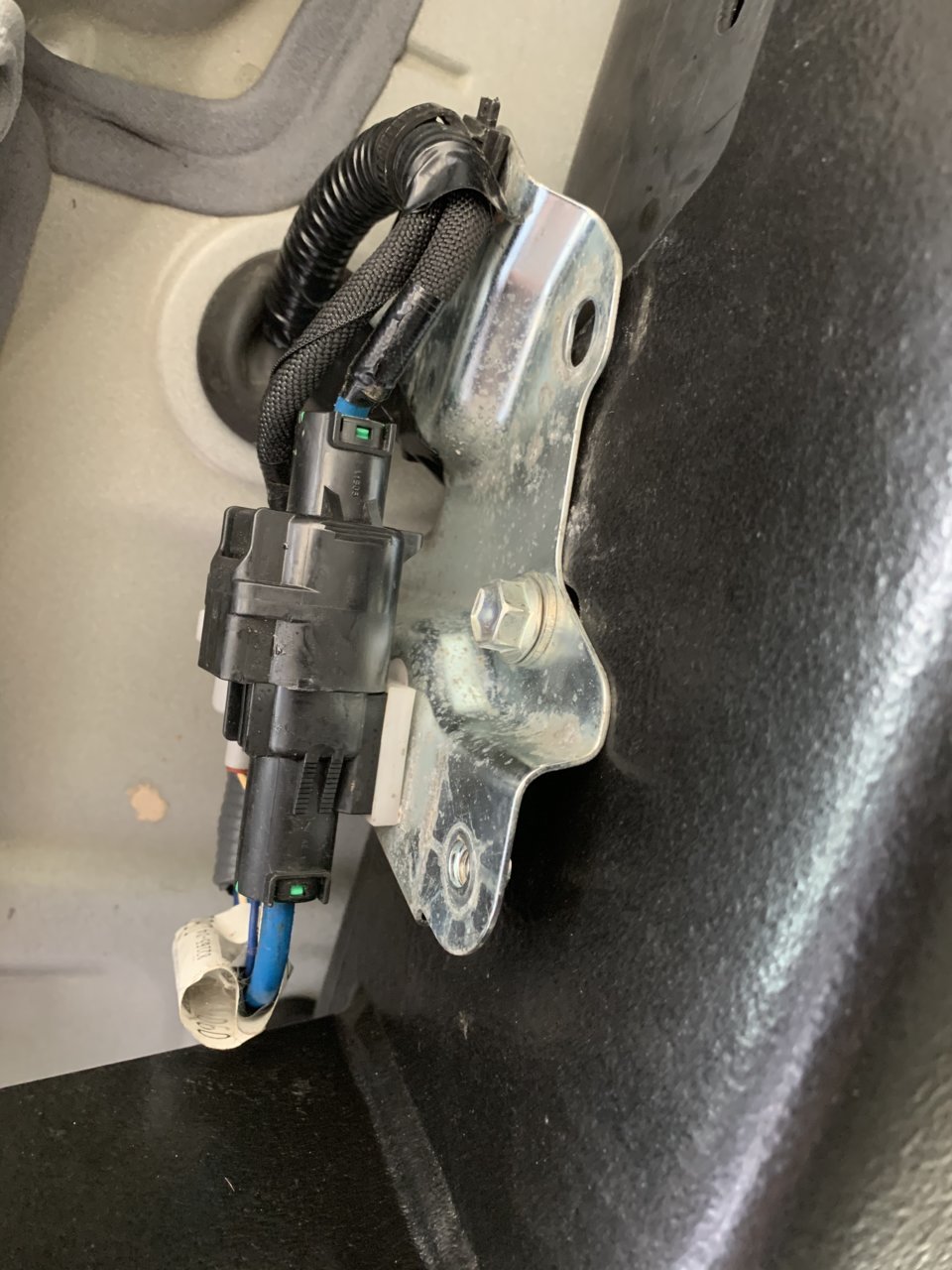

    How many bolts are supposed to be used for the driver side?
    I have three 1/2 inch in bolts for the front, two 1/2 inch bolts for the middle and one 3/8 bolt for the very rear.
    There is a slot for one more bolt in the second picture, however there isn’t enough space to fit a 1/2 inch bolt.

    You just put a bolt in the holes they fit into, if the bolt doesn't fit it's not intended for that location. The amount varies 05 to 07 are odd ball frames sometimes a rivet needs trimming sometimes it's not there. 08 to 15 will use all the bolts, 2016 plus will use less most likely 2 on the 16/ 17, And 4 1/2" bolts left on the 18 plus 3rd gens. Not sure what you mean not enough space for a 1/2" bolt all the bolts should be loosely fit before tightening.

    Cool cool. What I mean is that there is a hole for a 3/8 bolt but not 1/2 inch bolt. I could buy one extra to put in that space but doesn’t seem too much better than leaving it empty.
    I cut up the plastic box covering the cables in the passenger side of the truck so I could mount one of the bolts.
    I got around 6 bolts on the passenger side as well.
    i jumped on the sliders a bit and there seems like a tad bit of flex but I’m sure this will hold you everything I can throw at it and then some.
    Anyways I’m done, and it looks extra cute. Thanks @JLee !
