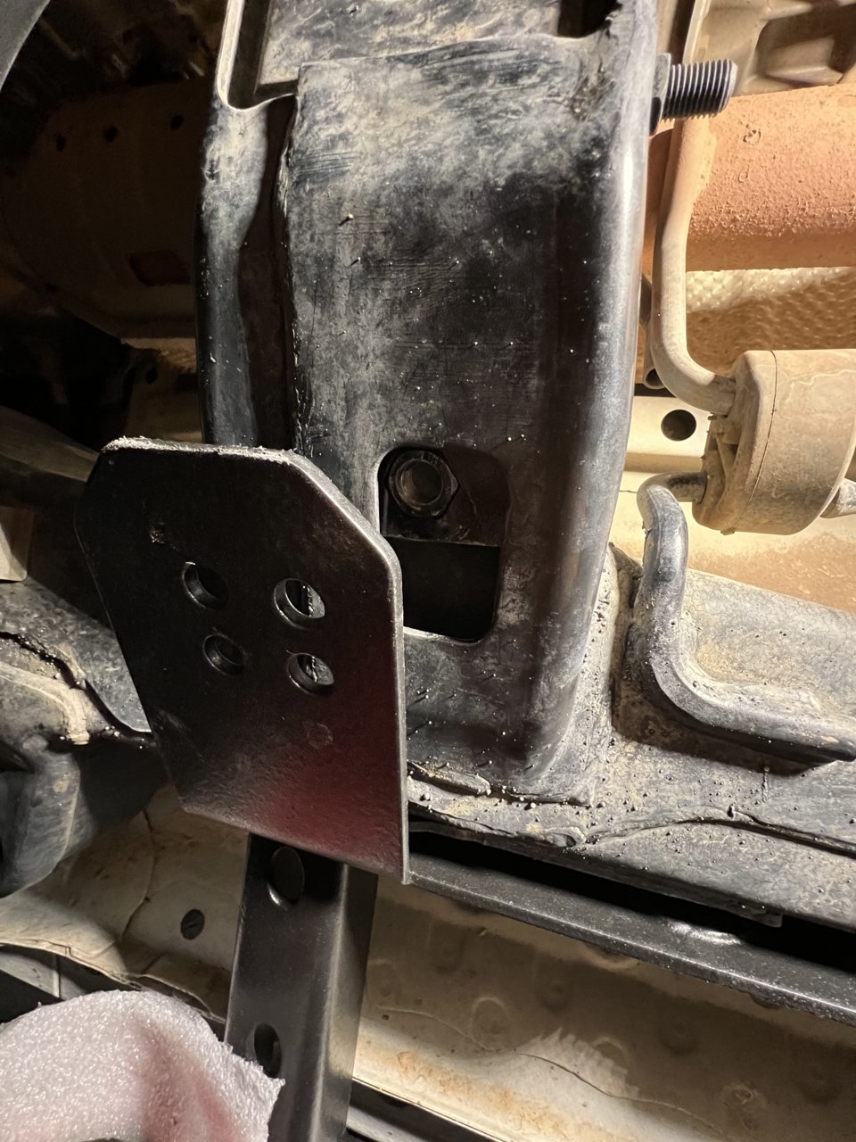

    Maybe I missed something but I can’t get this to line up I installed the center bottom bolt first. This is passenger side. Haven’t touch the driver side yet. Any ideas what I’m doing wrong?

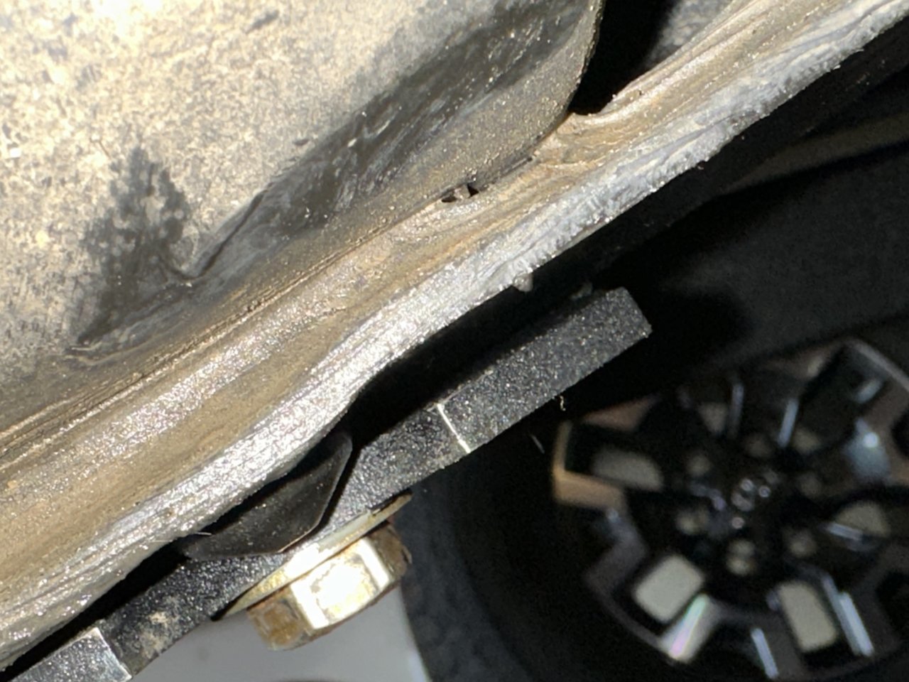

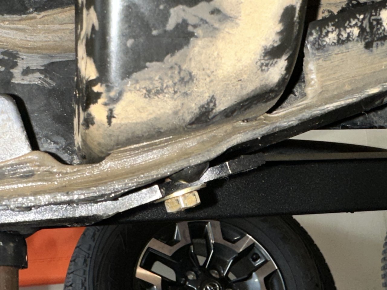

    Started installing mine today. My passenger side has a gap in the rear between the bracket and frame where the rear-most 3/8" bolt goes.
    Everything else lines up perfectly. Just thought I’d check if this is common/acceptable or if I should take it off and try reinstalling.

    As I started tightening the other bolts down the gap actually closed up a bit, but there is probably still about 1/16-1/8". It looks like it might be slightly hitting the rivet which is causing the gap.
    With everything tightened up I don’t expect it to be an issue, but just want to make sure I do it right.

    i had to grind some clearance for the rivet

    Installed the driver’s side slider today and had that same small gap at the rear most bottom bolt. Not concerned about it since everything lines up perfectly and flush. Some of the 1/2" washers started caving into the holes in the frame so I may add a few extra bolts to the smaller holes that don’t have hardware. I’d have to double check, but I think I ended up using 6 1/2" bolts and 1 3/8" bolt on each side.

    Hi, I checked mine but got distracted about replying. I have the same gap and I like I said, no issues with loosening or deflection in four years. If I remember right, I did use Loctite. Though to be honest I’ve only actually “used’ the sliders a few times. Mostly just a few weeks ago up in Goler Wash and on Mengel Pass in Death Valley.

    +1 on the small gaps at the 3/8" bolt location on mine. I briefly considered shimming it with washers to prevent the bolts from taking bending loads, but decided it wasn't a significant issue.

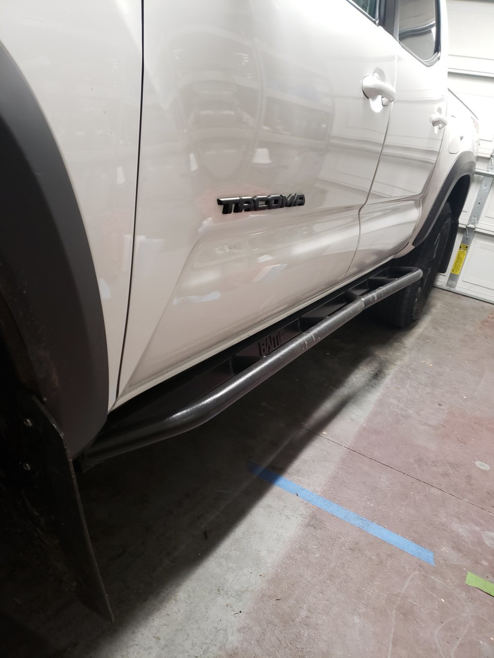

    Here’s a pic of them installed. Very happy with these sliders. Not so much with my paint job :rofl:. I got a few paint runs and chips from installation that I’ll be touching up.
