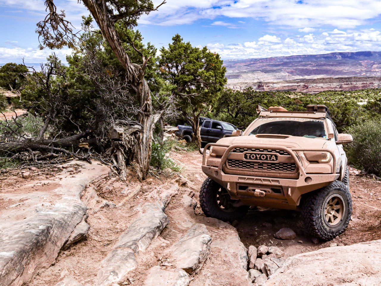

    I think this portion was an option and the other side had a main trail and bypass right next to it. I had a harder time getting up this portion you went through while my buddies had an easier time with the main trail. The angle was pretty awkward and hard to get a good line. It looked easier to do than the other part but it wasn’t lol!

    Yeah it sucked doing it solo, glad I had the reinforcement brackets because the winch struggled to pull me up.

    I just turned front and rear locker on and crawled up lol

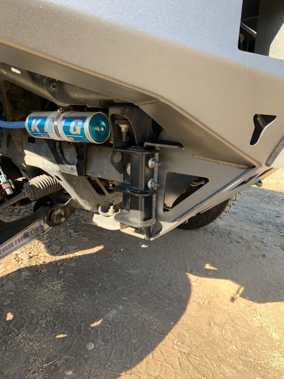

    So this is the DV8 front hidden winch bumper...
    Looking at the design of both I doubt that this will be a match. Thoughts?

    Doesn’t look like that’s going to work with the brackets.

    Not even close and I would not pull from that mount. You will most definitely damage your frame horns with how that's mounted.

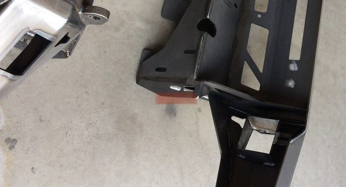

    Fits @At The Helm bumper with a little trimming, just had to narrow the plate that mounts to the frame horns (red highlighted area) took about 1/4”off
    It already has a hole for the lower thru bolt, so that helped a lot
