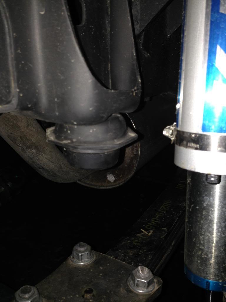

    I would get bumps in there before you try and rework the lower mounts.

    I'm running the front bump in the mean time, which is only for looks ha 4605022D-C5C9-4A01-A4CB-4D52A85C6BA3_697f2f2bbb4c1b49fa47fd0cbc812d03b426c7a1.jpg

    Ahh I see , just get them bumps in there before you start cutting stuff out.

    So it's 6inches up travel about right for my spring set up? I know I can't expect much without going SUA

    I couldn't tell you that the go fast guys are going to say stop it when the leaf gets flat. Crawlers will go all the way to negative arch. Its all in what your trying to to. Seeing that your a Prerunner I dont see you doing much crawling. So I would set your bumps to stop your springs right as they flatten.
