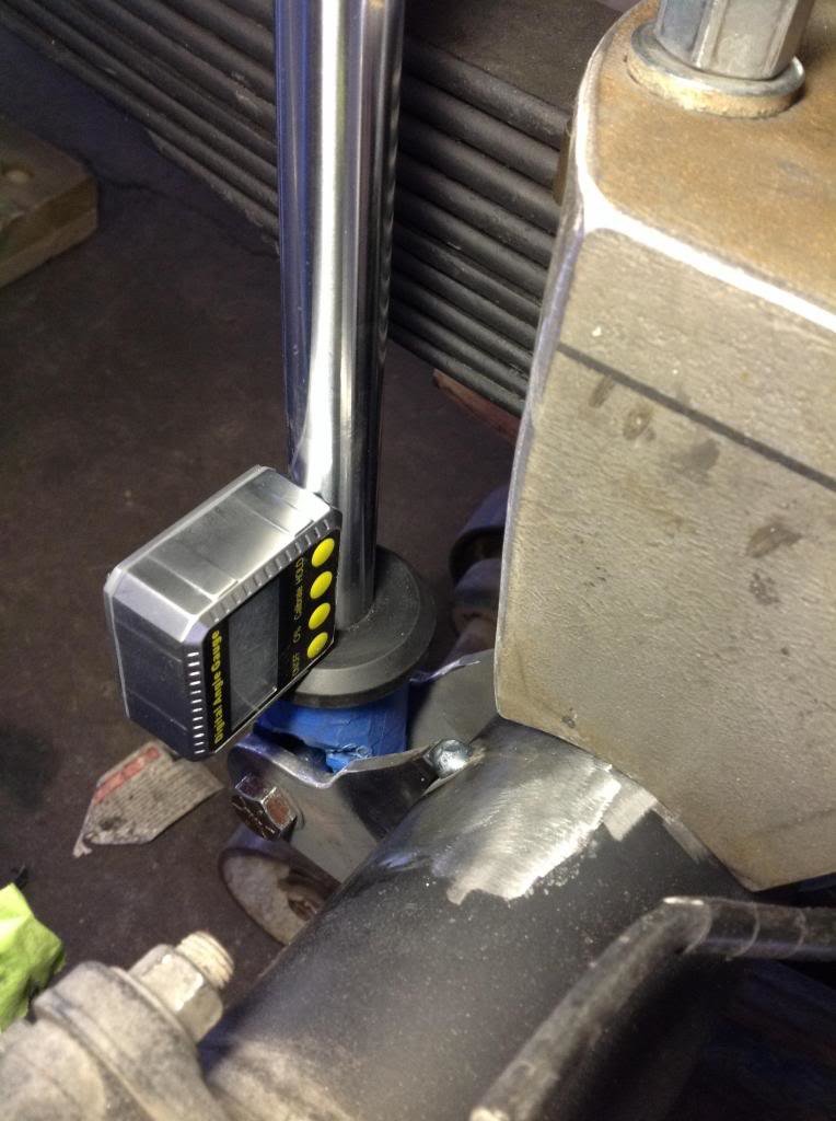

    Then we tacked the mounts to the frame and axle. The shocks are mounted and 90* from side to side and 9* forward
    Question for you guys who have installed the kit.
    What did you measure off of to get the 9* forward angle?

    Grass valley CA
    02 Extra cab SAS Linked front and rear
    I lost track thousands of dollars ago.
    Angle finder to get the degree.

    #550
    347
    Gotcha, I was over thinking it.

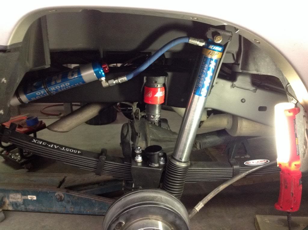

    So I finally got this completed. Used the BAMF kit to fit some 2.5 12" King IBP shocks, modified parts of the kit slightly and here you go.
    Understand these modifications were done to allow for a 2.5" shock. The kit is really nice and perfect for a 2.0 shock.
    The clearances were very tight with the 2.5. I had to modify the lower mounts, removing material for shock eye clearance during suspension cycling. Also had to space them with washer to help with clearance and allowed me to mount them lower.
    Also put the rear vertical side in the brake and added 3-4* brake across it to provide additional clearance during cycling (this would not have been needed if the bucket was set to maybe 12-14* instead of 9*.
    I will report back with more pictures and field test observations, will be performing retrieval for the SNORE Rage At The River this weekend ;)
    Thanks Jerry for a great product !
