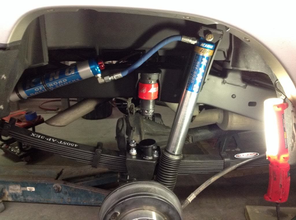

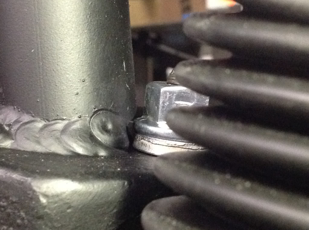

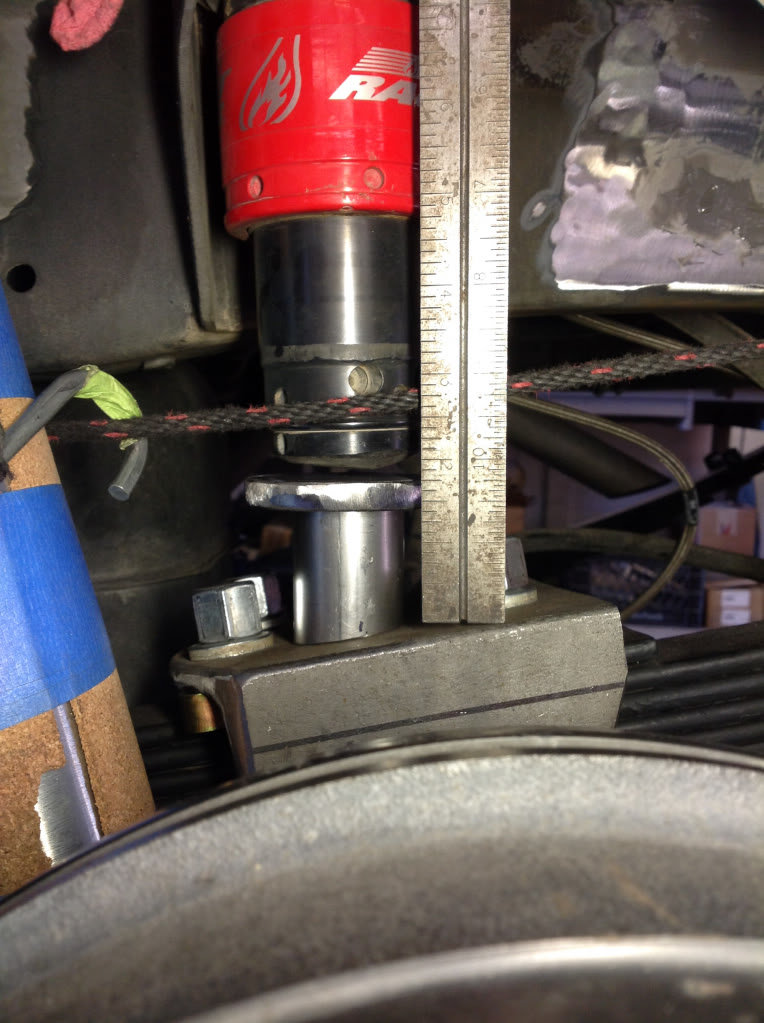

    Just to update my experience with the brackets, they have held up very well.
    1.5" spacers on the rear with OEM FJC wheels and no rubbing between the tire and the 2.5" shock body.
    After LOTS of compressed/extended testing, multiple measuring and lots of eyeballing this was where I found the bottom mounts needed to be.
    Tight clearances on my targets.
    Came together really well.
    What a great kit at a great price, thanks again Jerry!

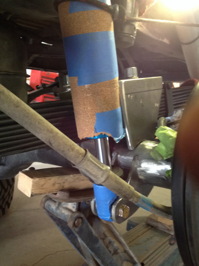

    Right but I figured out if I spaced the lower mounts with thick washers, one on each side of the misalignment (inside the mounts), that the lower portion of the shock cleared without contact. Then I tacked the mounts in place.
    Now Jerry needs to come up with a bolt on skid for these lower mounts so we can buy them from him. Can't mark up the anodizing ;)

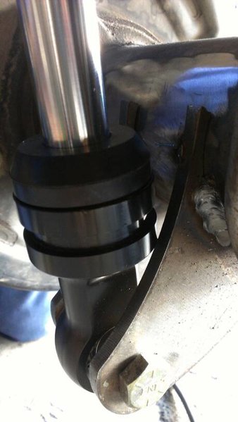

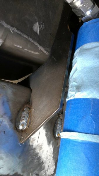

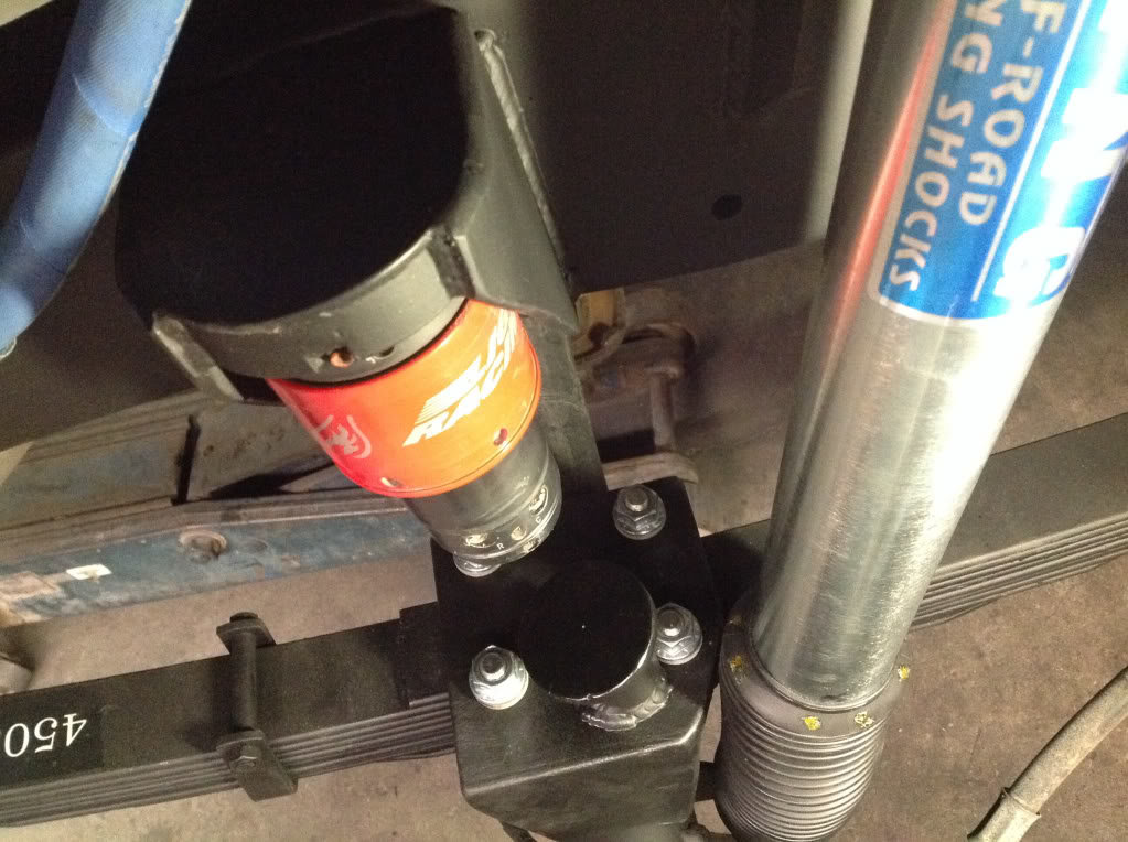

    Yes sir. I had to cut the uppers and lowers. The 2.5 shock body damn near takes up the whole inside of the upper mount so I had to cut the edge down about 1/4" where the hole is cut for the resi tube. When the shock pivots it was gonna hit it. I actually ended up cutting it twice but I got it right. Haha I also moved my lower mounts about as far out as I could to get the shock body out away from the upper mount. It works out since the mount sits straight up, the edge of the mount is cut tappering in towards the frame starting from the top and moving down, and the shock is slightly angled outward.
    This was the top mount before I trimmed it ......
    Bottom mount I had to trim off some of the edge because it was contacting the rod end. I trimmed it twice also, first time I was clearing so I did a test drive around the block and came back to a small gouge in the rod end so I trimmed it some more
    This was the bottom mount before I trimmed it .....

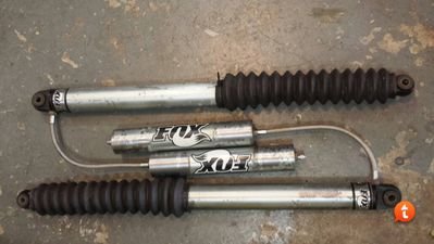

    Selling a set of fox shocks that I used with this setupqumyneda_0f0183df4c7d7c35afa66d92a55f180f4102927b.jpg
