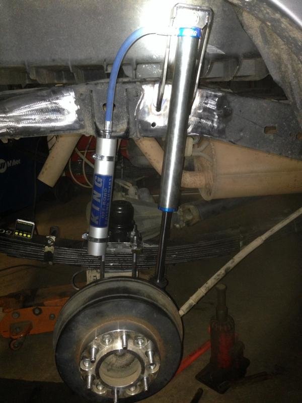

    #272
    Basikbiker
    Basikbiker Well-Known Member
    Sep 21, 2013
    #112968
    3,981
    Trav
    09 AccCab 4x4 spaceship
    My doors are the only stock things left besides the headlights
    So far so good, so glad I went this route instead of making my own, saving me a lot of time and beer cans, it's all straight and parallel, 90* to axle and 9* rake! picture is a funny angle

  13. Jun 6, 2014 at 12:42 AM
    #273
    Basikbiker
    Sep 21, 2013
    #112968
    3,981
    Trav
    Took it for a rip down a pretty baby head rocky rough road, and god dang big shocks are nice, time to crank the fronts up a little more

  15. Jun 11, 2014 at 7:30 PM
    #275
    Basikbiker
    Sep 21, 2013
    #112968
    3,981
    Trav
    Ruff Stuff makes weld on resi mounts, they're for 2.5's but a little squeeze on em and they fit tits, I can take pictures in a couple weeks,( I'm at work) but they ended up with the bottom bolt about flush with the bottom of the axle, honestly tho everyone is going to put them in a different spot, I measured with the axle bolted up to the springs and bumps tacked in, then measured from the bump strike pad to the metal base of the bump(where it could theoretically squish too) added about 3/4" to the measurement, set the shock shaft stroke to that and tacked the mounts in. All said and done I got in the end 3/4" buffer on bottom out and plenty of shaft travel for flex and droop. I tested it too, I hit sum shit in my truck at speed that definatly bottomed shit out, checked how much stoke I used and it's spot the fuck on, jerry makes a badass little kit

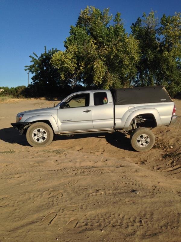

  20. Jun 18, 2014 at 7:56 PM
    #280
    Basikbiker
    Sep 21, 2013
    #112968
    3,981
    Trav
    Almost full flex bout 1" from full flex, 265/75/16 stock wheels 1.25" spacers and about 1" gap from tire rubbing shock body on pass side, shout out to jerry on makin this sweet kit available
