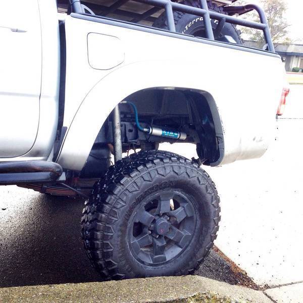

    These thing are real nice.. makes the rest of my rear stock suspension flex super nice.. plus with the bilstein 5100 it rides way smooth (within my budget) $100 for both brand new condition! Some guy sold them after test fiting a 1sg gen with about 7-8" of lift and poor guy still couldnt fit these in there. Thanks to BAMF and 2" lift they almost seem short. The axle shock tabs I had to weld horizontal with the bolt hole 1/4" above center of the axle. For now with the stock suspension its what limits the shocks... flexed all the way up and down with about an inch or two more to go in the shock. When I have a better budget I can get some 14" shocks and cut and reweld the lower mounts 2" or so below the axle

    MJonaGS32
    MJonaGS32 MJ on a GS
    Apr 14, 2009
    #15949
    12,415
    MJ
    SF Bay Area (East)
    07 LT 4x4 DCSB 6spd Vagabond
    Drifter wedge camper, Dual battery, OBA, ARB locker, 4.56 gears

    Nice MJ.. like your shocks :)
