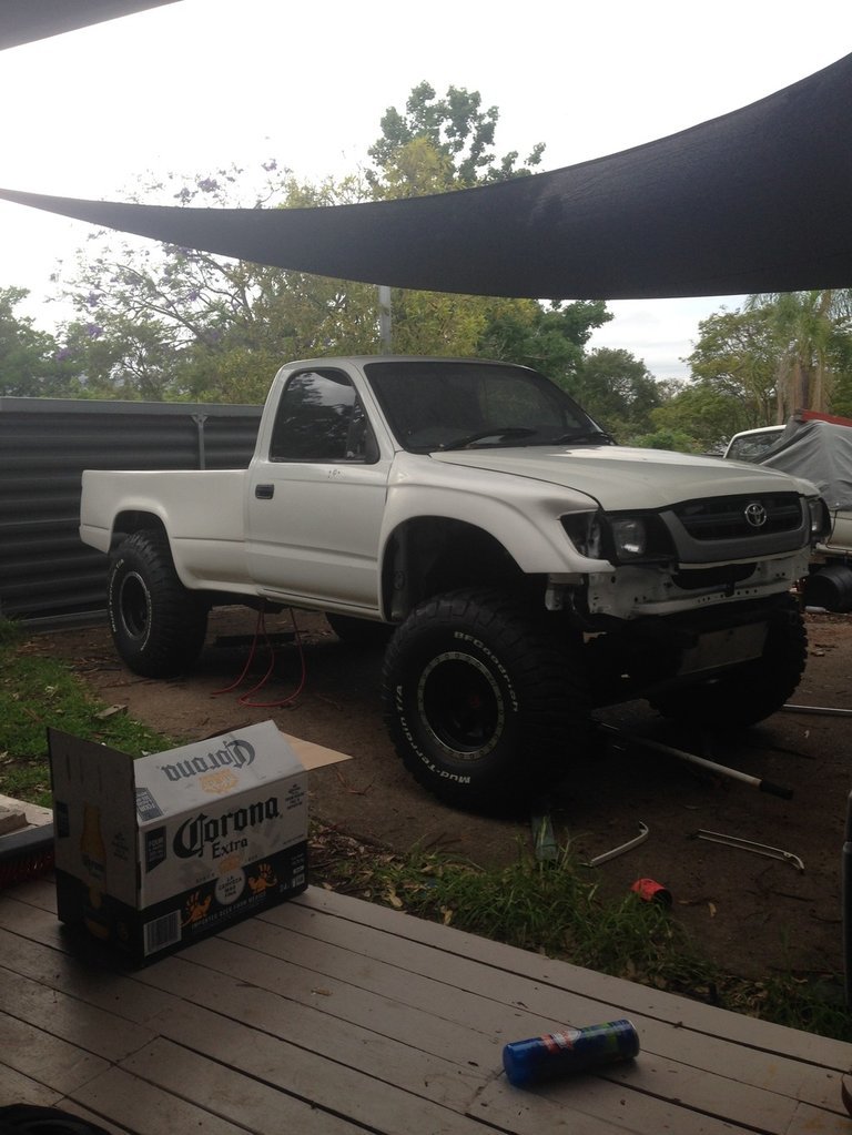

    Hi gents, can anyone with 1st gen experience tell me if this kit will work on the previous model?
    (It's actually an Australian LN167 Hilux :crapstorm:)
    Diff is 0.75" narrower each side than the 2nd gen from what I can find, wondering why it wouldn't work....
    I've got -44 15x10s on 35" tyres, if that makes a difference
    It's my first post, with a different truck, from a different place, don't let me get away without a burning!
    EDIT: vehicle in question
