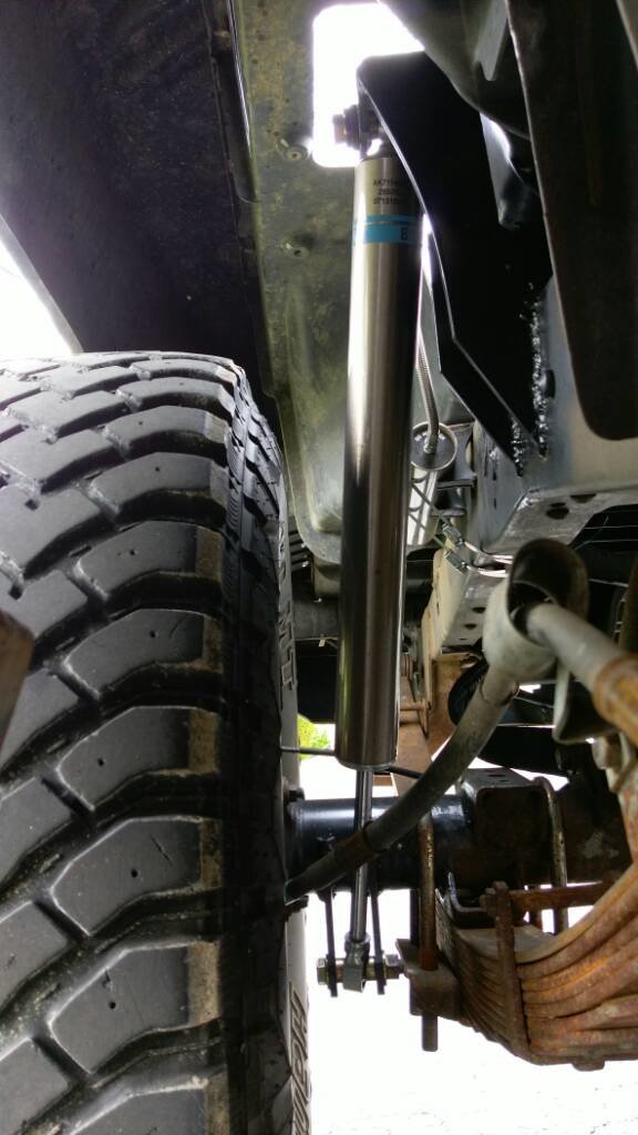

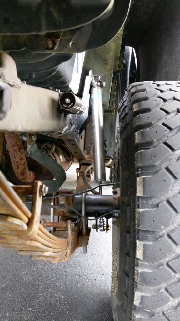

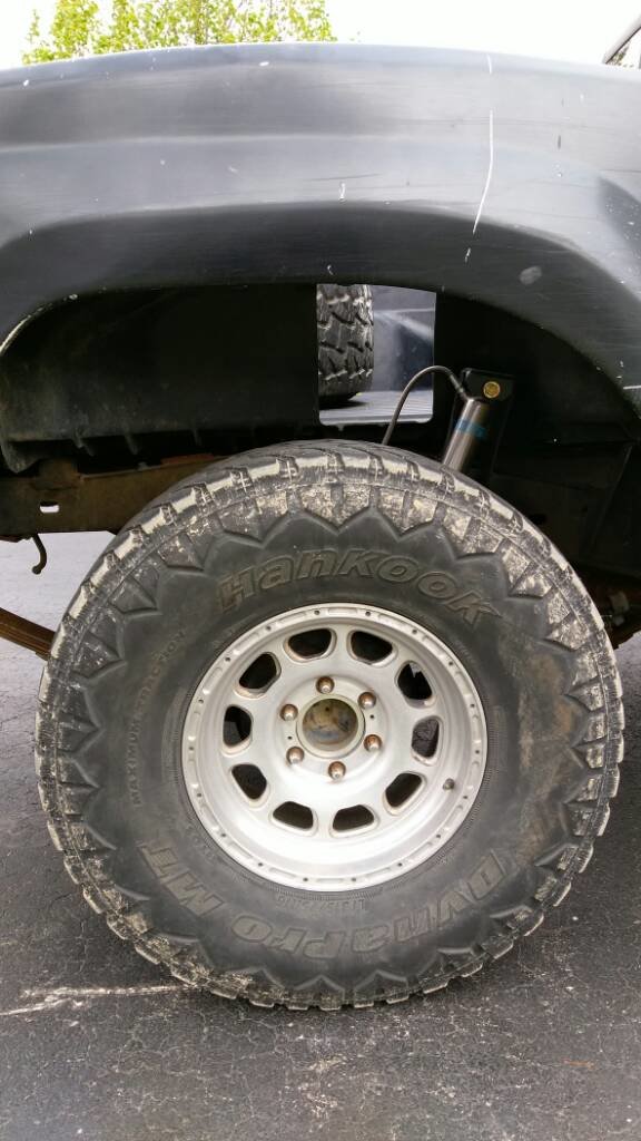

    Finally got around to taking some pictures. I pushed the shocks as far forward as possible.

    Maybe you said it already, but why?
