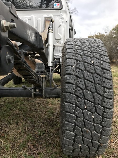

    2010 PreRunner 1981 Pickup
    Used Icon 13" universal shock

    Do you happen to have a part number for the ICON universal shock?
    Edit: Nevermind. Found it on their site.
