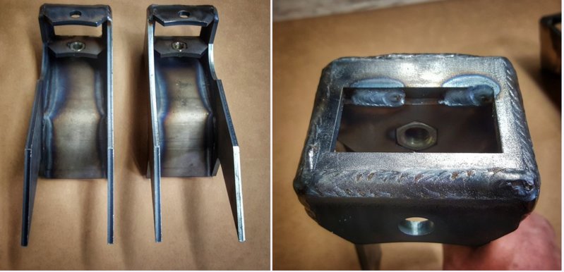

    The shock kits got a little refresh tabbed for easy assembly.

    Are they any noise/movement issues with the shock in upper mount?
    I say that because, on the nut side, the nut/bolt isn't clamped to the mount. It is just sitting in this hex cutout. The bolt should be clamping the mount on both sides of the shock mount ideally (like how the lower mount is).
    EDIT: Looking at it more, the nut appears to be welded to this piece. Which would fix this concern.

    Yes the nuts are welded in place not just loosely in there.

    Got my first one welded up, good stuff and easy to assemble.
    One question: why doesn't the plate for the nut had a tab that goes half way through the side plates? Would make alignment easier and would make that weld easier to get good person penetration.

    The Tab will be added to the next batch we cut. We cut tons of them before we started tabbing the kit.
