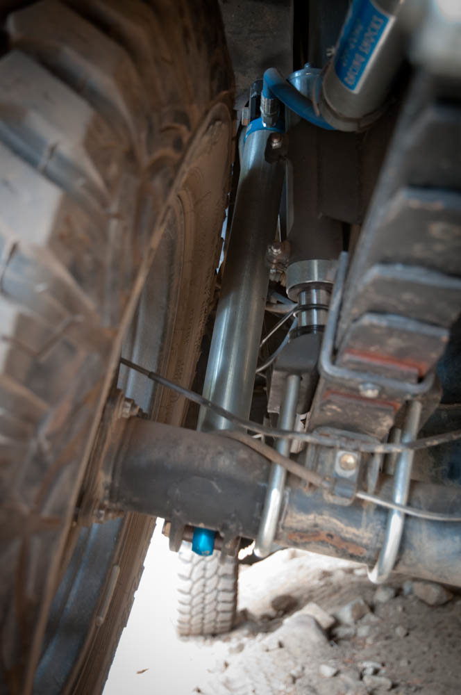

    Real soon were doing some off road testing of the kit on Sunday and if everything go's as planned and I'm sure it will I'll be burning out a few sets and get the parts up on the site.

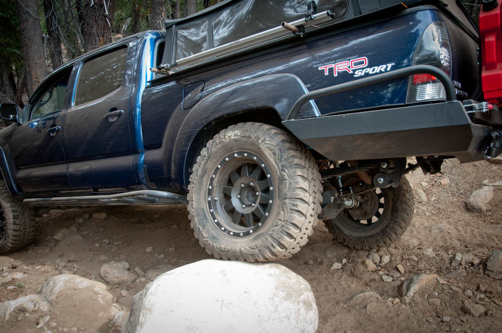

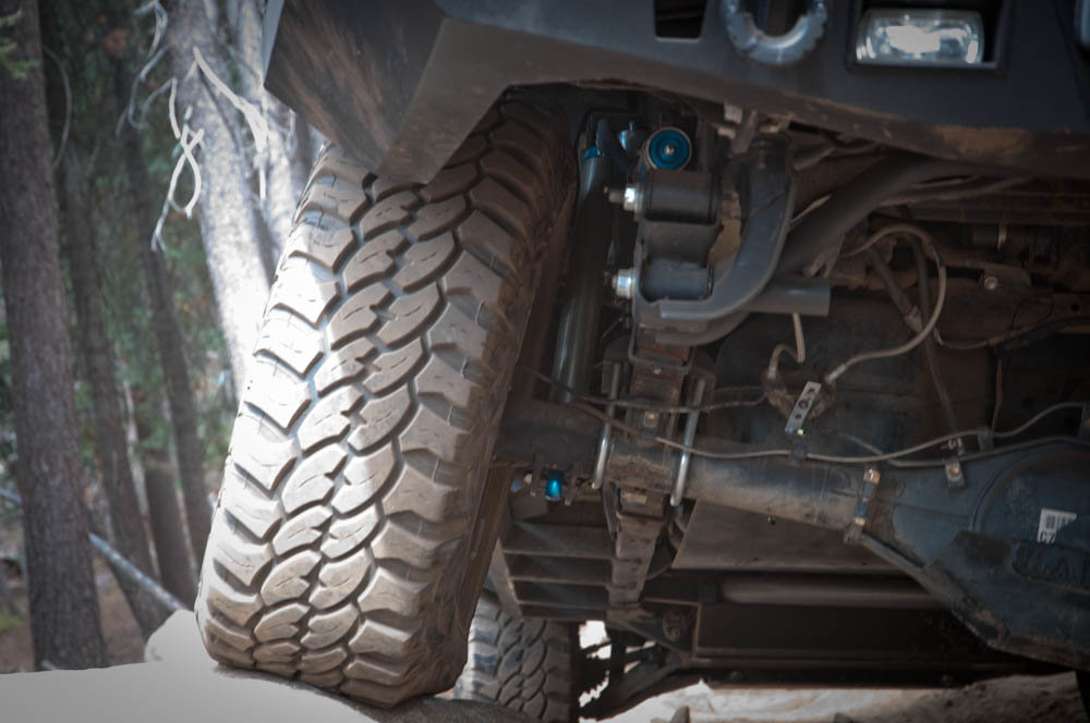

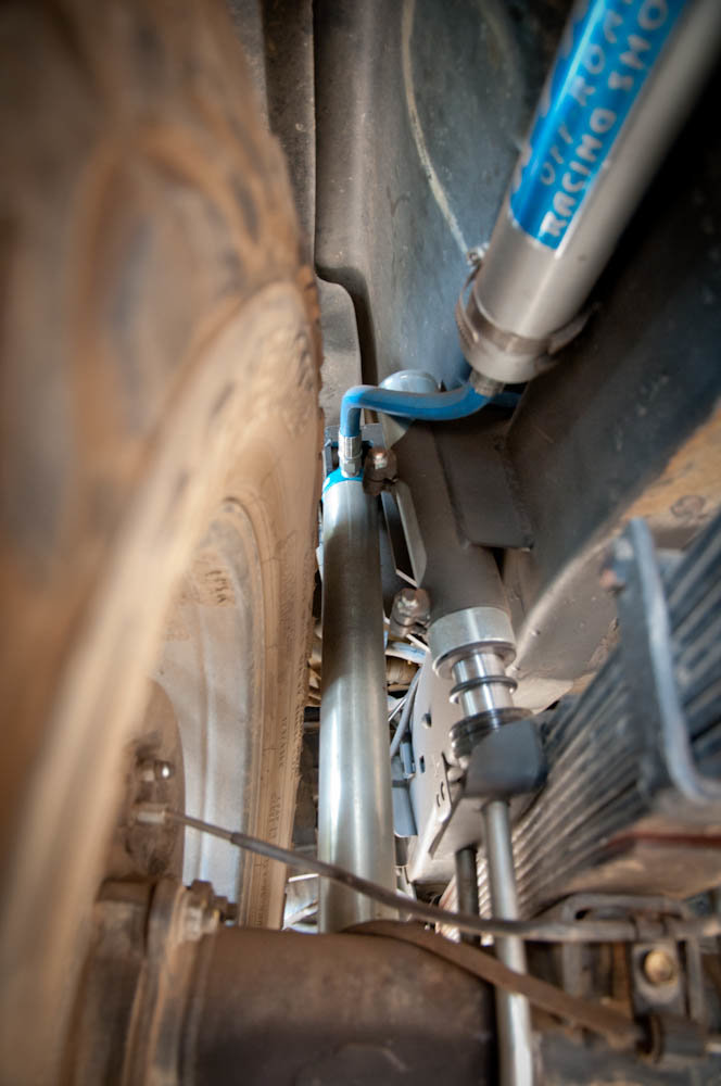

    So we did some real world trail testing yesterday and I'm going to be making a few changes to the shock bucket before I put these in the site. I want to raise the bucket about 2.5" where it sits now we couldn't get the tire all the way stuffed in the wheel well before bottoming out the shock. I'll post some pics later tonight or tomorrow. Other then that these are working awesome he never once hit the lower shock mounts on the rocks and he destroyed his drive line yesterday so he was hitting rocks :eek:
    Some time this or next week were bringing the truck back in the shop to install the new buckets and we should be good to go :cool:

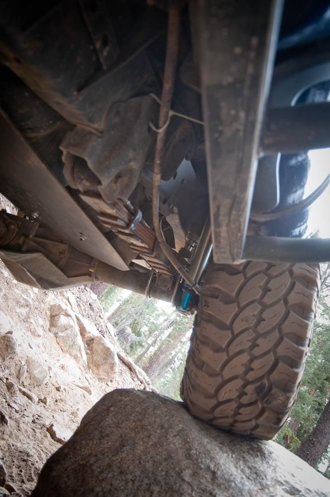

    JLee
    JLee [OP] The Man! Vendor
    Jul 20, 2010
    #40461
    19,606
    Jerry
    Benicia, CA
    02 Extra cab SAS Linked front and rear
    I lost track thousands of dollars ago.
    Pics

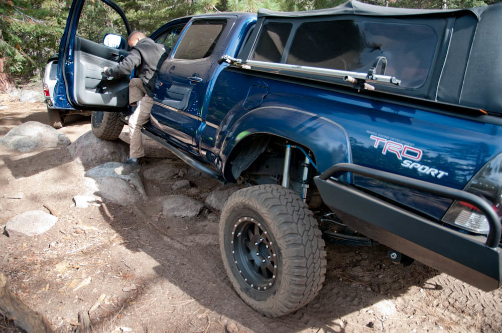

    That's as far as he can stuff the rear tire and it's not enough for me. I want fender ripping tire rubbing going on :D
    RobertOchoa3 and AbunaiTaco like this.
  7. Sep 24, 2012 at 3:31 PM
    #47
    allmotorrex
    allmotorrex Grove St. Fab
    Aug 29, 2010
    #42441
    16,746
    Gideon
    Memphis 901
    08 SR5 4wd 2.7
    NWF crawlbox, 5.29s, rear Detriot, front Harrop, 37" SXIIs, 17x9" KMC Grenade Crawl beadlocks, Dirt King 3.5" LT kit with King shocks, Fox 12" smooth body RR, BAMF shock kit, AP 3" springs, ext. brake lines, custom 1 piece driveshaft with .135 wall tubeing, GSF front rock crawling bumper, GSF rear bumper, Relentless Fab ifs skid, BAMF k/o sliders, X2O 10K comp. winch, TP glass fenders, OKled 20"bar, EBS dimpled/slotted rotors, EBS green pads, custom K&N CAI, LCE headers, FM Super 44 w/h turn down, URD MAF, Spec clutch, LCE heavy flywheel, URD short shifter, TMPer M1 Abrams shift knob, Amsoil oil, Cobra 75wxst w/h 4' firestix, Grillcraft, FXR TRS, T1 eyelids, custom ADV Monster 60 lights, bed lights, speedo light mod, Glow Shift volt/oil pres gauges, Glow shift 2g column pod, Optima yellow tops dual battery setup w/h IBS system, Pioneer DEH-P7200HD head unit, Pioneer 600W 4ch & 350w 2ch amps for doors and sub, Wet Oakle covers
    Yeah that looks a little less then stock mounting points
  8. Sep 24, 2012 at 3:37 PM
    #48
    JLee
    Jul 20, 2010
    #40461
    19,606
    Jerry
    Benicia, CA
    Yeah i want it about 2.5" higher in the wheel well.

    Using stock bump stop mounting point?
  10. Sep 24, 2012 at 4:45 PM
    #50
    JLee
    Jul 20, 2010
    #40461
    19,606
    Jerry
    Benicia, CA
    He doesn't have stock bumps but depending on the springs you chose you may need to replace your bumps.

    What bumps is he running? And I didn't mean the bump stop itself, I was referring to the location of it. Basically when he flexes, what is he bottoming out on.
  12. Sep 24, 2012 at 6:23 PM
    #52
    jberry813
    Jan 21, 2011
    #49636
    28,476
    Jason
    Lake Tahoe
    2012 DCSB Sport
    ...too much shit to list.
    Alex has hydro bumps. But that's not what is limiting his uptravel. Shock is fully compressed and is the limiting factor.
    As Jerry already said:
    AbunaiTaco likes this.

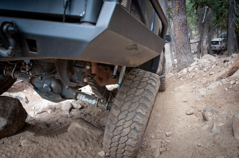

  19. Sep 25, 2012 at 8:04 AM
    #59
    JLee
    Jul 20, 2010
    #40461
    19,606
    Jerry
    Benicia, CA

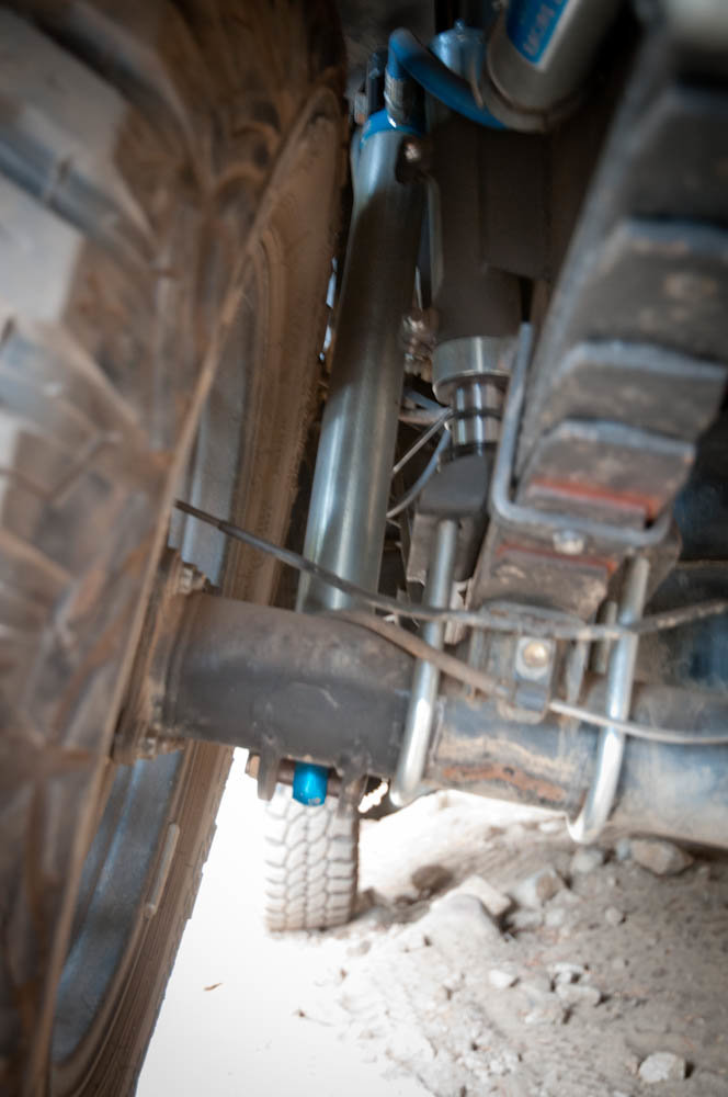

    Here is some more shots.
  20. Sep 25, 2012 at 9:21 AM
    #60
    jberry813
    Jan 21, 2011
    #49636
    28,476
    Jason
    Lake Tahoe
    2012 DCSB Sport
    Maybe it's just the angle of the picture, but the leafs already look like they are at negative arch :notsure:
