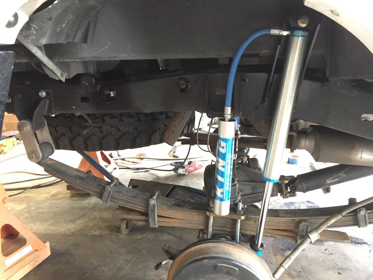

  4. Jan 23, 2018 at 8:52 PM
    #584
    TacoZim
    TacoZim Well-Known Member
    Feb 20, 2017
    #211176
    971
    Bay Area, CA
    2008 DCLB
    -12x2.0 Kings
    -Expo leaf pack
    -Wheeler bump stops (Need bump spacers to limit up travel)
    -AP U bolt Flip kit
    - Crown Extended brake lines

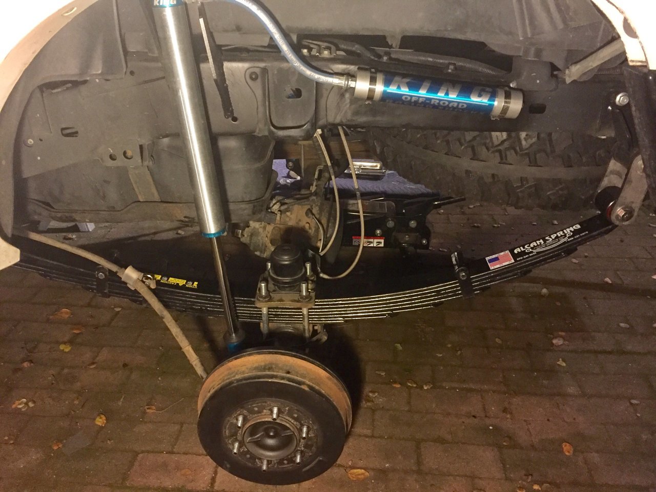

  5. Jan 29, 2018 at 8:38 PM
    #585
    Ripcord
    Ripcord KM6PIM
    Mar 31, 2011
    #54120
    1,464
    Jim
    Northglenn, Colorado
    Spruce Mica 2013 TRD-OR
    Alright, I'm finally gonna get some and take advantage of today's deal of the day on your website.

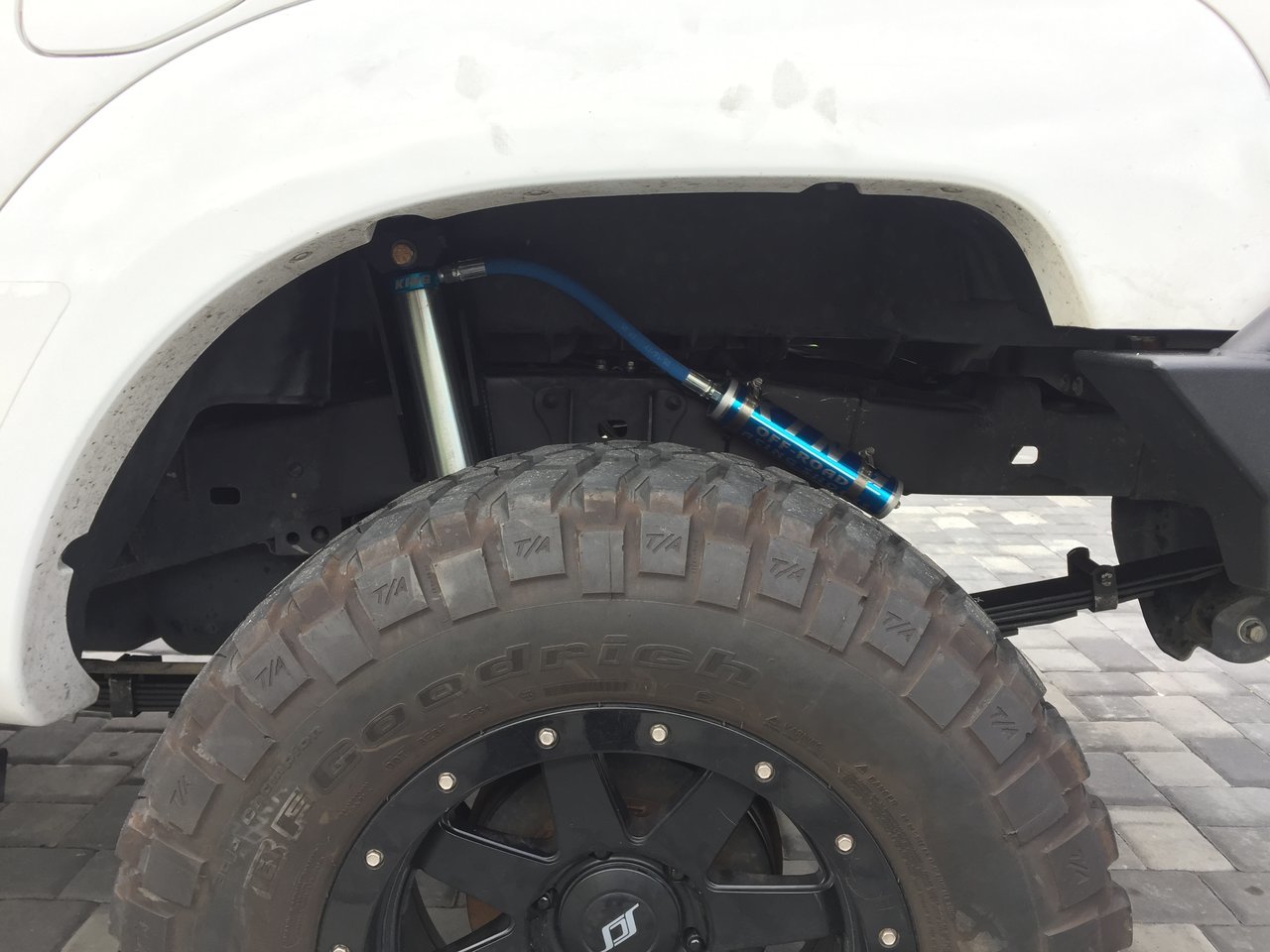

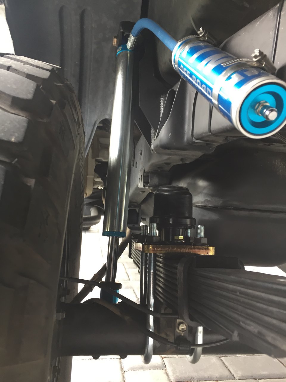

    Anyone have any pictures of this setup with 12" smoothies with adjusters on the reservoirs? Curious to see mounting options...
    MattCowsmasher and TacoZim like this.
  8. Feb 14, 2018 at 9:55 PM
    #588
    TacoZim
    Feb 20, 2017
    #211176
    971
    Bay Area, CA
    2008 DCLB

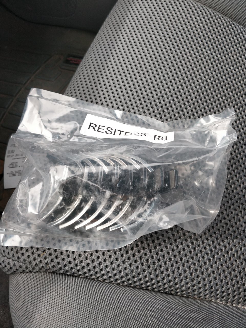

    Reservoir mounting options? Ruff Stuff makes universal mounts that you weld on.

  10. Feb 15, 2018 at 8:02 AM
    #590
    Overlanerd
    Overlanerd Vagabond Outdoors
    May 6, 2012
    #78312
    3,596
    Phil
    Benicia
    09 DCSB 4x4 OR 6spd
    315/75 R16 Falken MT's, SCS Ray 10's, Vagabond Drifter pop-up camper, BAMF sliders, Relentless skids, BAMF bumper, winch, Pelfreybilt rear bumper, Custom Alcan rear springs, King 2.5 coilovers w/ 700# springs, BAMF relocate kit with 12" Kings, Total Chaos UCA's, dual AGM batteries, kitchen sink & toilet (sold separately)
    I don’t have adjusters, but there’s plenty of room to access them behind the reservoir.
    Edit: Here’s an older pre-shackle reflip picture.
    Edit #2: The reservoir mounts. I think they came from Ruff Stuff. Can't remember.
    seoulja99 and Bentrodder like this.

    I just got a pack of 8 Ruffstuff resi mounts. $33 delivered to Texas.
    And Ruffstuff is have a sale until the 19th using code Valentine18

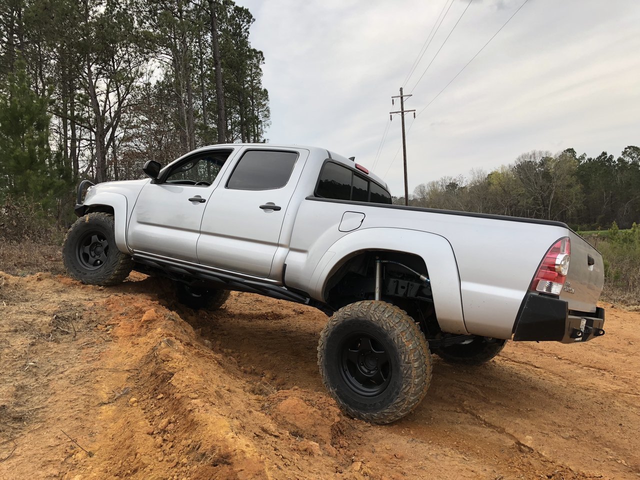

  15. Mar 5, 2018 at 4:19 PM
    #595
    Arcticelf
    Arcticelf Well-Known Member
    Jul 18, 2015
    #159735
    7,654
    Gladiator
    10+ inches of travel, limited by my stock shackles.
    Getting more out of the back let's me fully flex the front, this is the first time my front bumps have ever touched, and I think the shocks still have more to give.

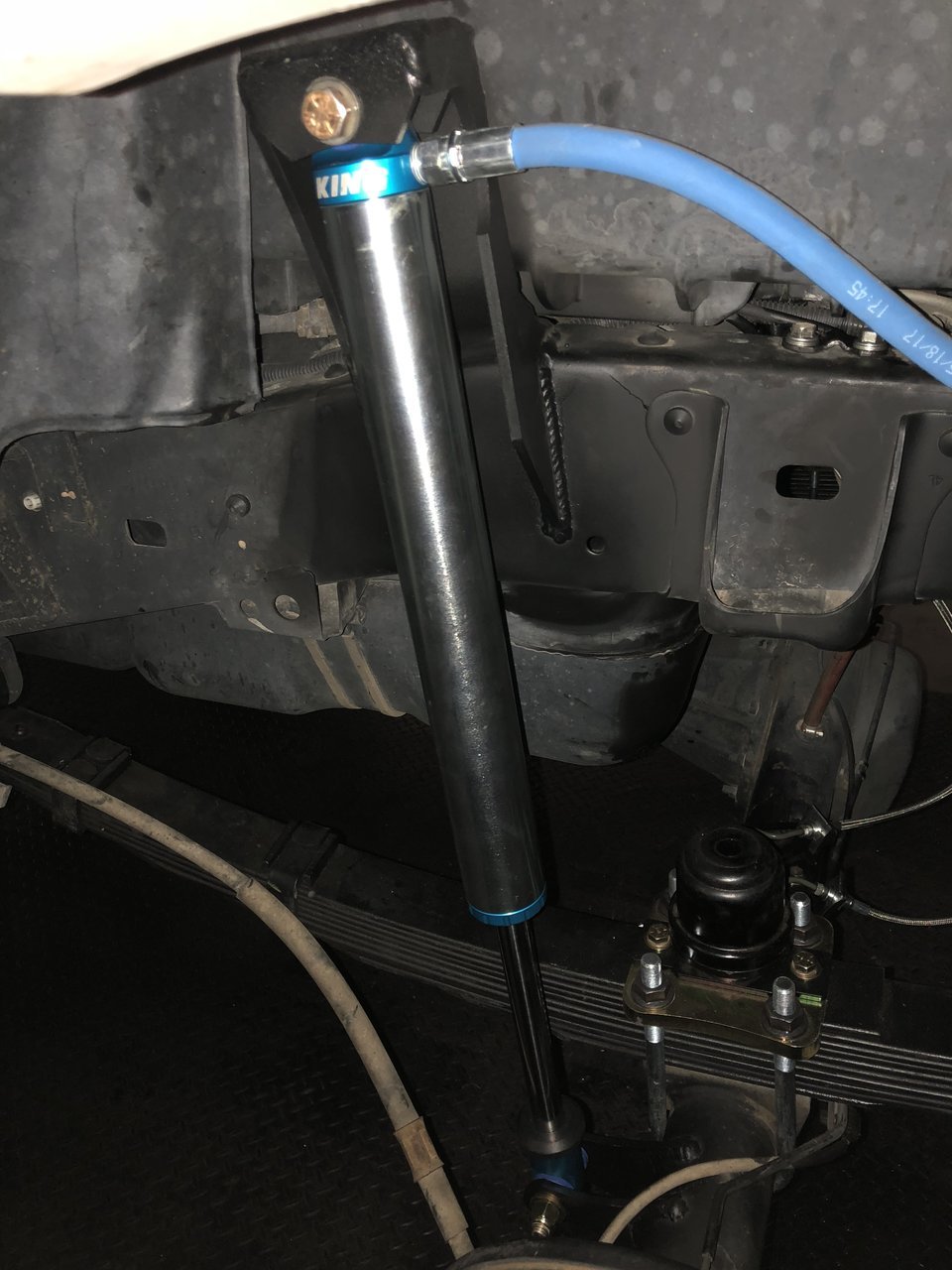

  16. Mar 9, 2018 at 10:37 PM
    #596
    kingk0ng
    kingk0ng Well-Known Member
    May 5, 2015
    #154638
    1,773
    11 TRD OR AC

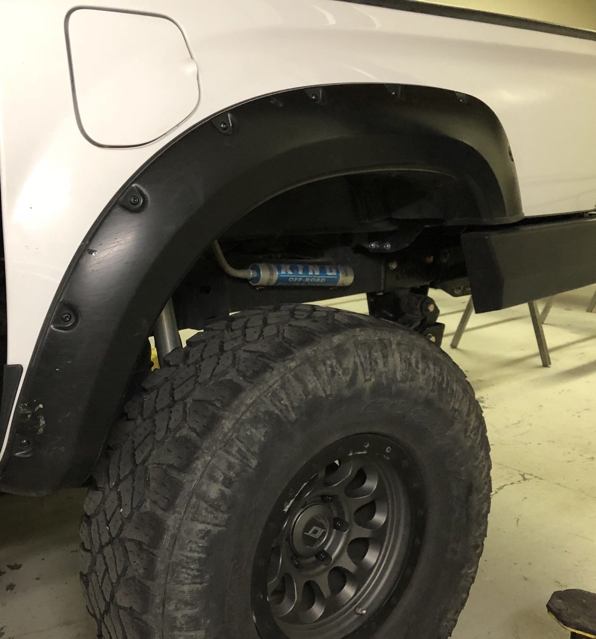

    just a few things.
    I have stock 16in rim with 1.25 spider Trax. My question to you guys is if I install it with 2.5 shock it only rubs if you fully stuff it? But if I don’t stuff it I can still drive on it until I get the correct spacing/ spacer? Just checking because don’t want my truck to be stuck at the Welder’s place after it’s all installed.
  17. Mar 10, 2018 at 2:31 AM
    #597
    MJonaGS32
    MJonaGS32 MJ on a GS
    Apr 14, 2009
    #15949
    12,407
    MJ
    SF Bay Area (East)
    07 LT 4x4 DCSB 6spd Vagabond
    Drifter wedge camper, Dual battery, OBA, ARB locker, 4.56 gears
    What’s the backspacing of your wheels? Either way, you’ll be able to drive no prob after. It really is only at full stuff.
  18. Mar 10, 2018 at 5:48 AM
    #598
    Arcticelf
    Jul 18, 2015
    #159735
    7,654
    Gladiator
    Install the lower shock mounts as close to the spring as possible, and you'll be fine for everything but full flex.
  19. Mar 10, 2018 at 7:18 AM
    #599
    JLee
    JLee [OP] The Man! Vendor
    Jul 20, 2010
    #40461
    19,616
    Jerry
    Benicia, CA
    02 Extra cab SAS Linked front and rear
    I lost track thousands of dollars ago.
    Yeah you will be fine for every day driving. They would only rub when fully stuffed.
    Bentrodder likes this.

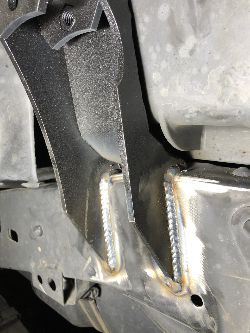

  20. Mar 11, 2018 at 11:35 AM
    #600
    suthrngent47
    suthrngent47 Well-Known Member
    Jun 3, 2016
    #188659
    110
    SC
    2012 Silver DCLB 4x4
    Finally got mine done, thanks JLee
