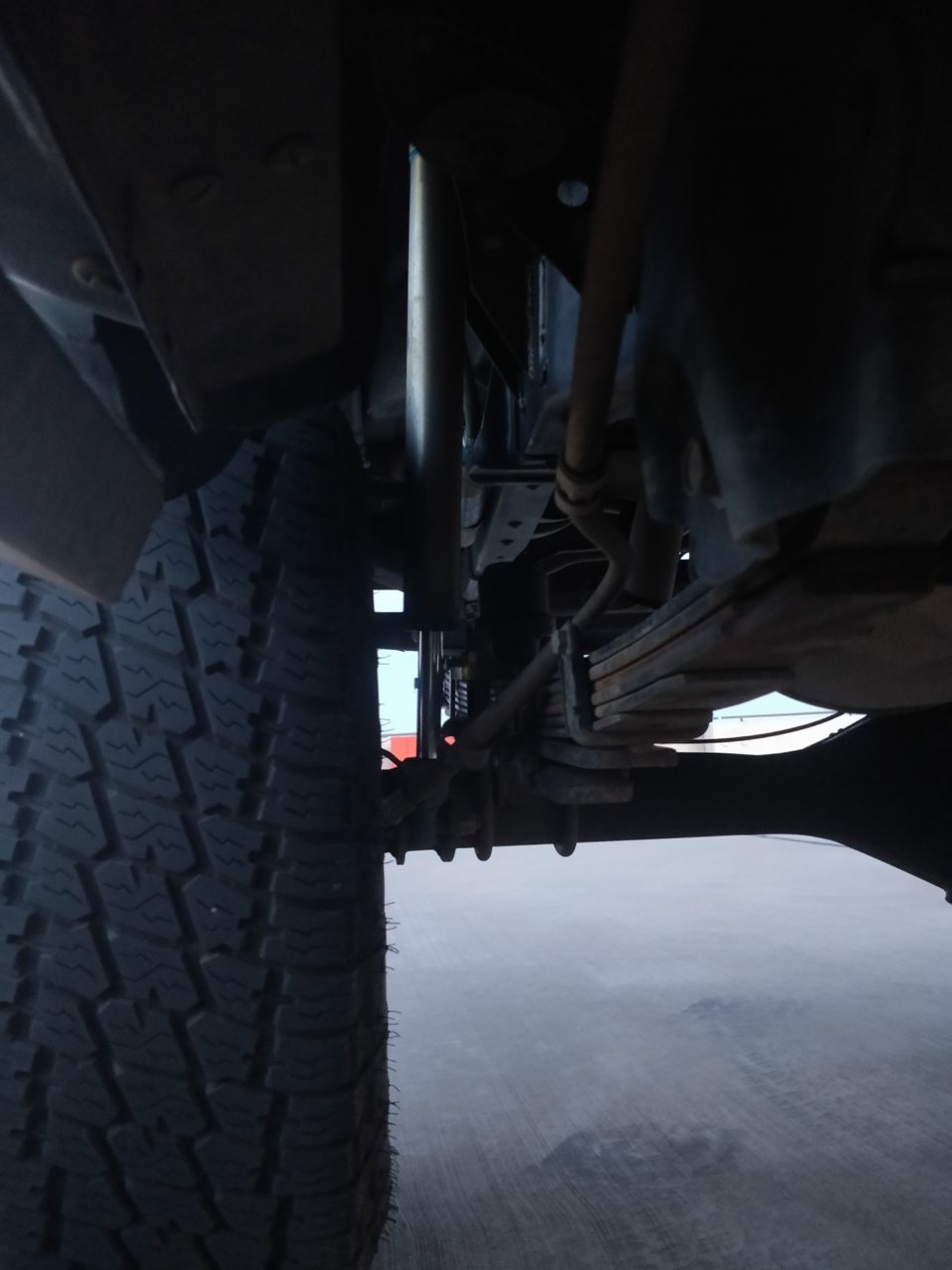

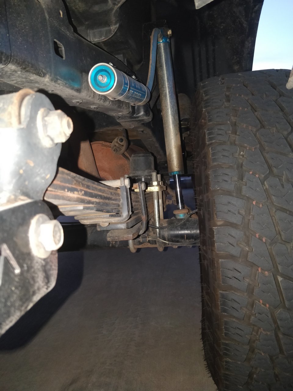

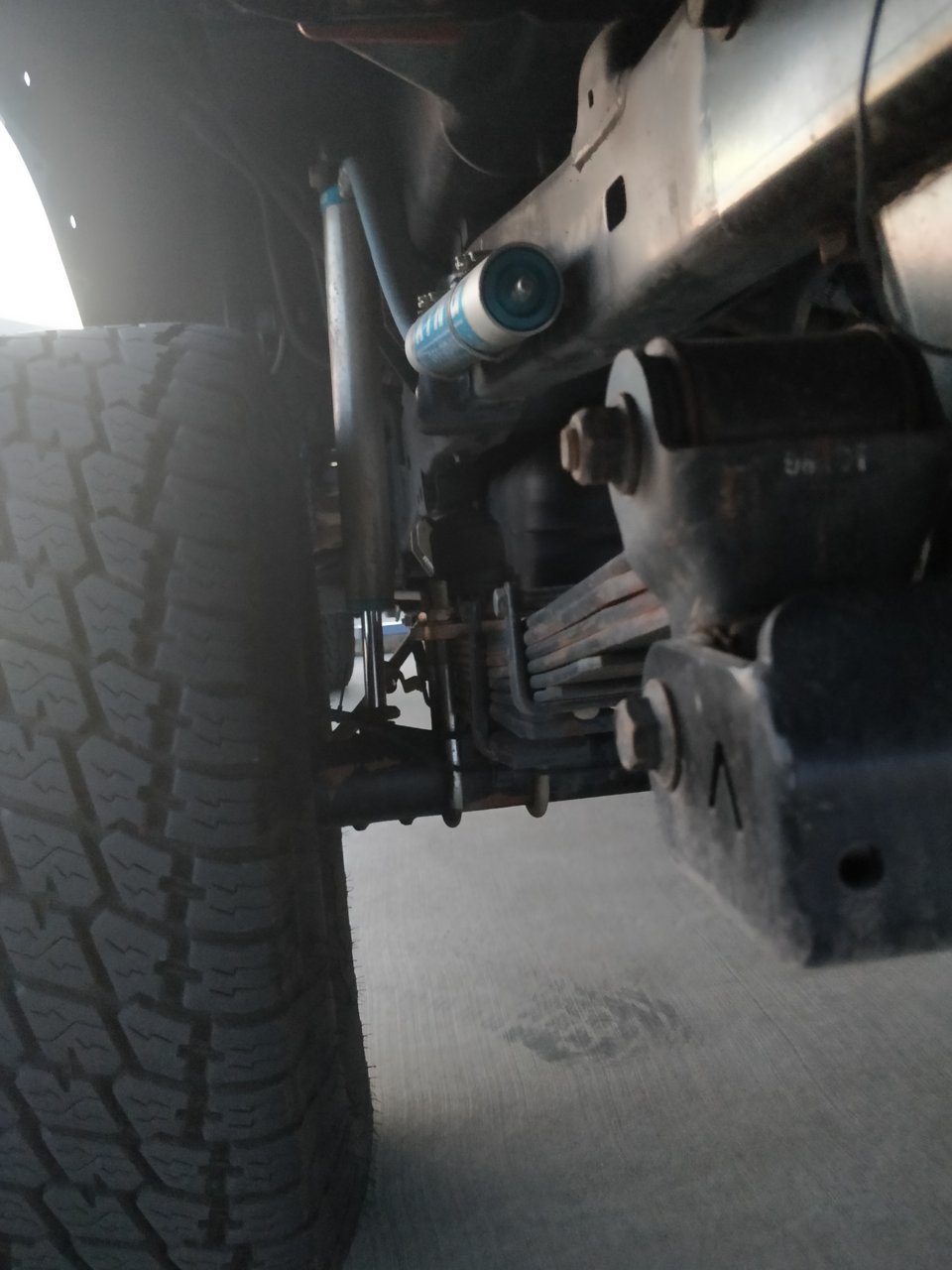

    15 Pyrite Mica DCSB Sport
    Scratches
    Driver's from the rear
    Passenger from the rear

    Have you ran into any problems with up travel? Yes I know this kit is designed for down travel.

    I haven't jumped my truck but between normal road driving, rock crawling and high speed dirt road action I haven't felt like the available up travel inhibited me.

    Who said this kit was designed for down travel? If installed properly you should have about a 50/50 split. Leaf springs are the up travel limiting factor.

    From be pictures posted looks like there’s only 4 inches of up travel

    It's between 5" and 6" with the lowers set about flat but you can rotate them down for even more down travel. Also most lifted Tacomas with a spring over don't get much more then 6" of up without over arching the leaf pack into a negative.

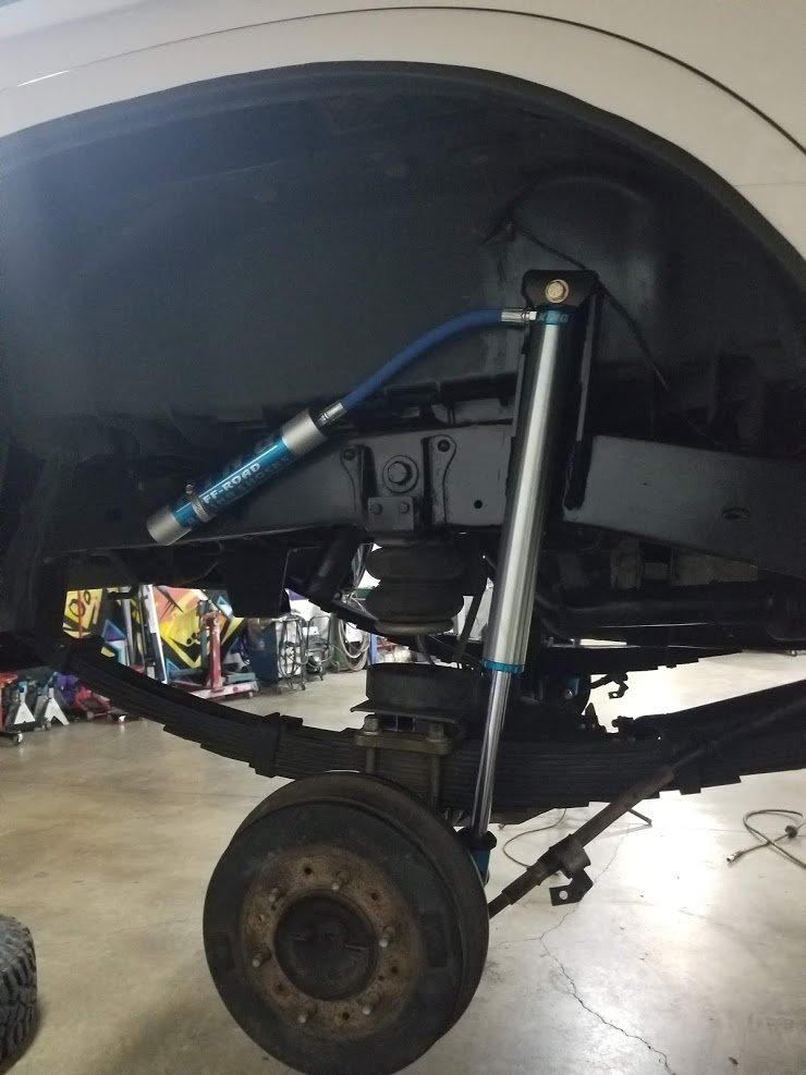

    Question for you guys that have gone to a place to get this welded on. How many hours of labor should I be expecting to pay for someone to weld up the mount for me?

    Looks good, but have you cycled it? Might be the angle, but it looks like the bump stop will barely be touching when the shock bottoms out. And those superbumps are soft and will pankcake pretty flat. Might need a spacer under the bump.

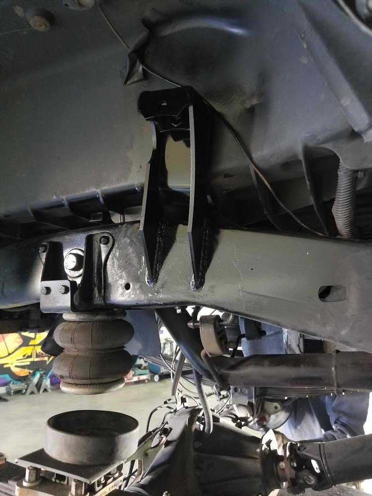

  11. Sep 13, 2018 at 6:35 AM
    #631
    inesshell
    inesshell blah blah blah
    Aug 2, 2011
    #60986
    7,166
    All stock Superwhite 10' AC
    welding doesnt take much time, its the grinding down the welds that take the longest. Depending what he has for equipment it can range from 3-5 hours

    Add about three hours to that if done right with braking the leaf pack down and cycle the suspension It's a 6 to 8 hour job.
  13. Sep 13, 2018 at 7:00 AM
    #633
    inesshell
    Aug 2, 2011
    #60986
    7,166

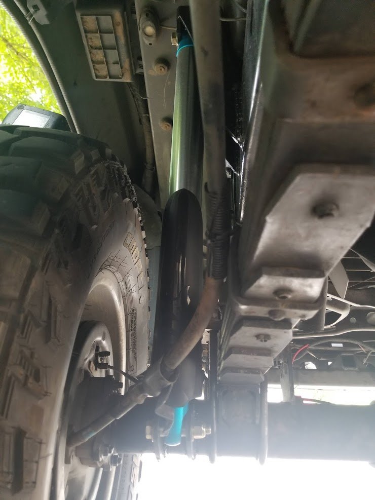

    here is my install from last weekend, fun stuff
    ZB4Tx63Pf8Yydudz9dsFhtD_CWmt5f4NHfHHx2Y-_1bde7c23f11cb3cdd215ba140cf5ac82f41312c8.jpg
    Y3VXfZXDjTpxQbd4to97hVB9oNy7NdH00x5xsARi_c116746e5084d6b282d3a9d0cd6fc7f7185add4f.jpg
    with the guards on
    toO9pOiVTpfgXqsyB-X-1kQWCI7DlLjRmvFQJpCJ_7ea97087d92ab822ad7bcd27fe09bb298f475071.jpg

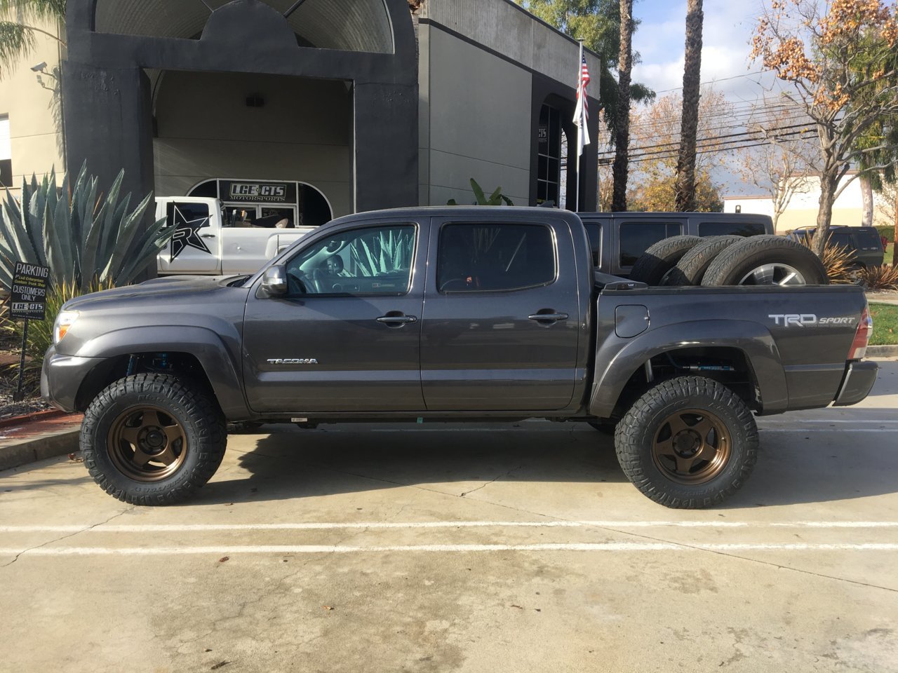

    See Build in Sig
    Gotta get better pics, but it’s on!
