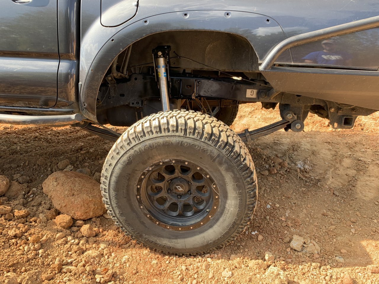

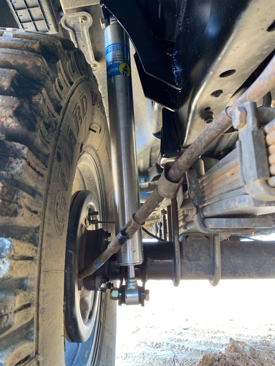

    BAMF shock relocation with 14” Bilstein 5125s installed. Having to run 1.25” spacers in the rear with my 35s to keep them from hitting the shock on the uptravel. At full compression I have literally about 1” left of shock shaft showing as you can see in the pictures.
    Thank you @Jerneyman for the services and a good day in the garage. Glad to have the limitations back on my springs and not my shocks.

    Time to move to a set of 3.5BS wheels

    It's what I had to do, spent a while in denial but going from 4.5 to 3.5 was a much better solution for me than spacers.

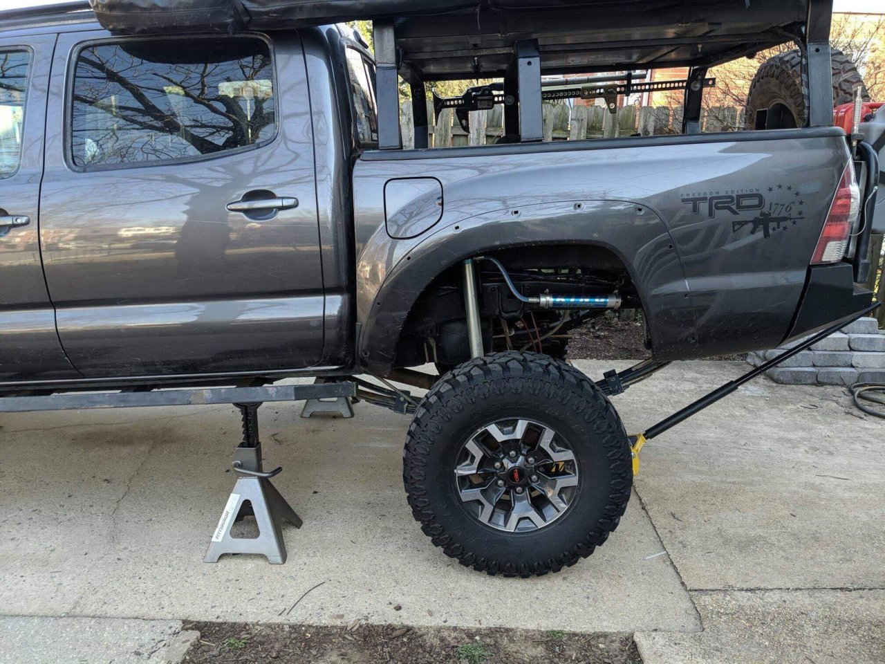

    If you replace them with poly bushings you’ll gain more droop. The stock rubber ones aren’t meant to articulate that much. Energy suspension makes them. And if those are Dakar leafs, you’ll wanna trim the third leaf so it doesn’t get caught under the rear leaf hanger.
    This is dakars, 12” shocks and the poly bushings in the shackles on my friends truck.

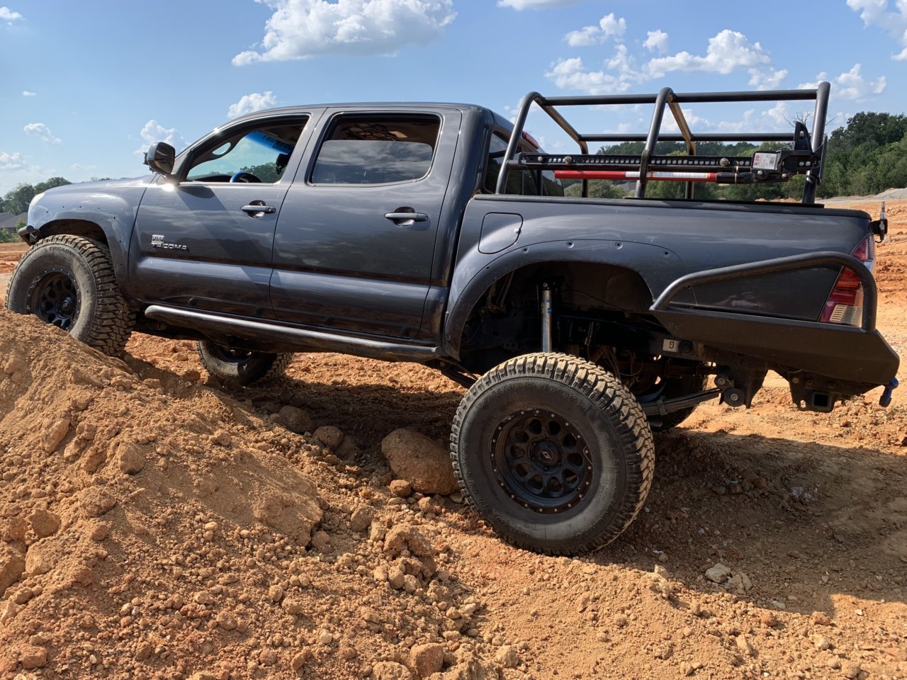

    Yeah the 14 are great for the droop, and just just about too long for the compression. I mean I literally have that 1” of shaft showing lol

    I’m hitting my super bumps at compression so I’m good with the uptravel. I didn’t space them up or anything.
