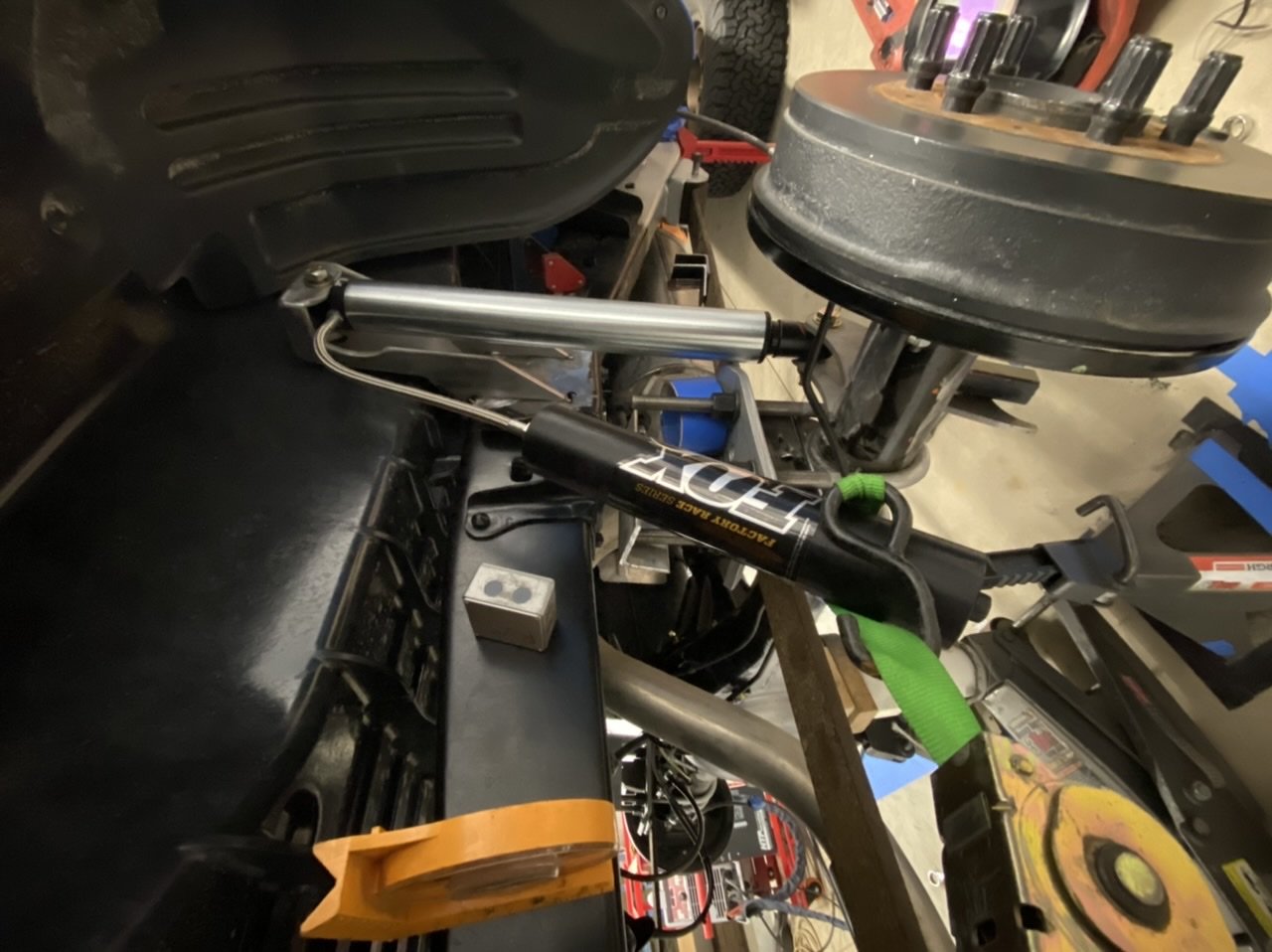

    how much up bump vs rebound travel are you guys setting these from ride height?
    I just tacked stuff up right now and was at 4" bump, 8" rebound.
    lower shock eye is about at the top of the axle tube so i can easily drop it down to 6"/6".
    is that what everyone typically runs the up/down travel split?

    Mine is about 4” up and 8” down as well and I use mine for crawling.

    is that 4" bump travel with 1" of shock rod showing? as in 3" + overhead?
    my current 4" is to metal to metal of the shock itself.... which seems a little too few bump travel inches for me

    At ride height I have 4” of exposed shock shaft but I have about 1/2” of safety net to not bottom out the shock.

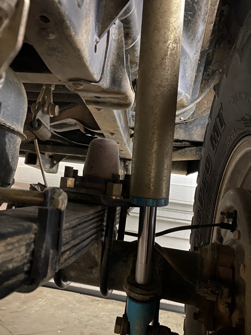

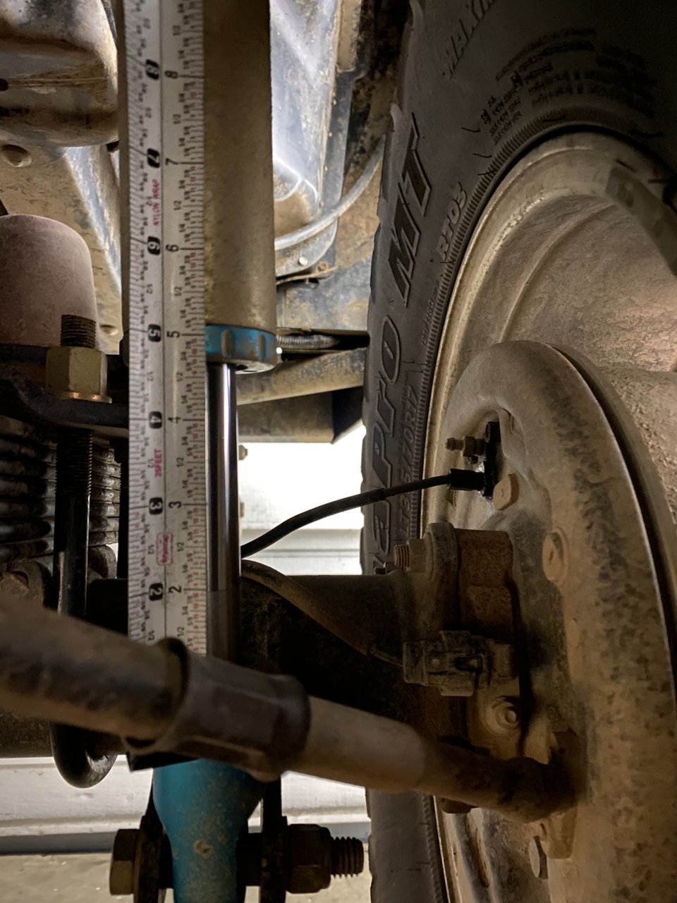

    I guess I have 4.75” exposed shaft at height and I forget the safety net I left myself. I think it was if the bump stop managed to compress 100%, which would never happen.
    I broke my leaf pack down and cycled it in my garage so I know it’s done correctly. I just don’t remember the exact numbers.

    moved the axle side tabs down a bit and now at a theoretical ride height I'll have 6" of rod on this 12" shock showing.
    called it good enough to fully burn in.
