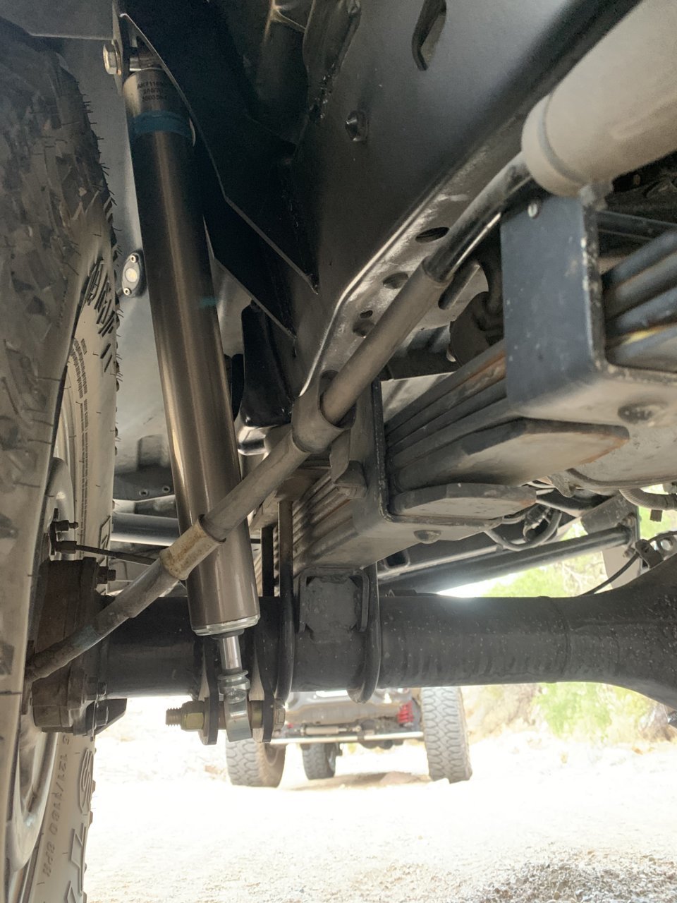

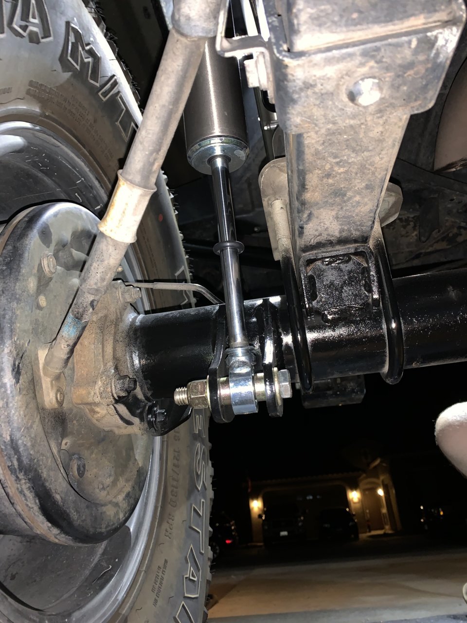

    My 14” short body 7100’s with superbumps & no additional bump spacers is literally just perfect. The addition of a small spacer on my bumps wouldn’t hurt but at full bump travel I’ve got just about an inch of shaft showing. It’s a great combo for me, with up travel not really sacrificed and plenty of down travel. Considering how budget friendly my specific setup is, I couldn’t be happier. Note that I have 2.5” taken out of my fenders
    Lastly here’s a static height pic of shaft showing

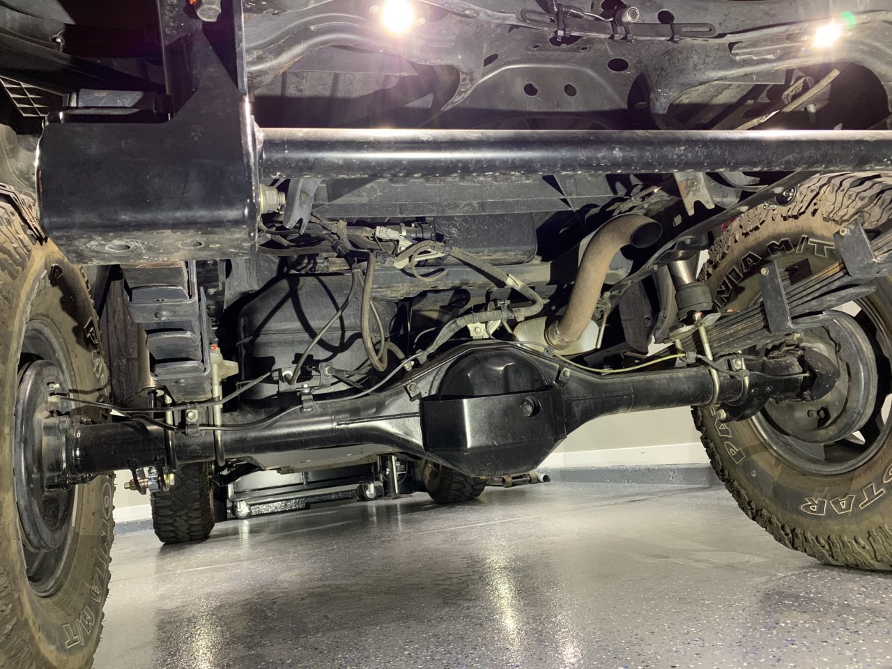

    I ordered limit straps as I believe I will use all 14" when i]I get twisted up and flex the front and rear. With just the forklift flex test I was getting 13" of shock travel out of it.
