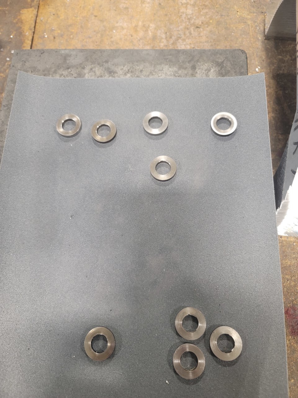

    Pulled the trigger, shock relocation, hangers , shackles and 14”SB bilsteins with 700/2550 valving. Is this valving ok to run with 200-300lbs constant weight and when loaded probably close to 500-600 lbs? And any one running the bilsteins have a spacer width for the upper bolt? Spacers on both sides even or can the spacers be on the outside only pushing shock towards frame. I have Dakar HD leafs trimmed to avoid shackle contact. And run a TRD pro 4Runner sema rim with skinny 255/80/17 tires. I’m assuming with the skinny’s there shouldn’t be any issues with rub on the shock body. Any valving input or setup recommendations are welcomed. Cheers from up North

    You'll probably get away without spacers with that setup. I need 3/4 with 35x10.5s and 4.75bs. 255/70 will be fine you can always revalve if needed. Hell I'm running 360/80 now which will be perfect loaded down I think. I may pull them and get them revalved once I get them on dirt. Time will tell. The spacer width you need extra is .280" if you need I can machine you some spacers if you want to pay for shipping to Canada.

    I was looking into upgrading to the Kendra R/T 35x10.5 once these are pooched. Thanks for the info if your machining the spacers from SS I’d love to pay some shipping to get those sent up. The salt and corrosion is bad here

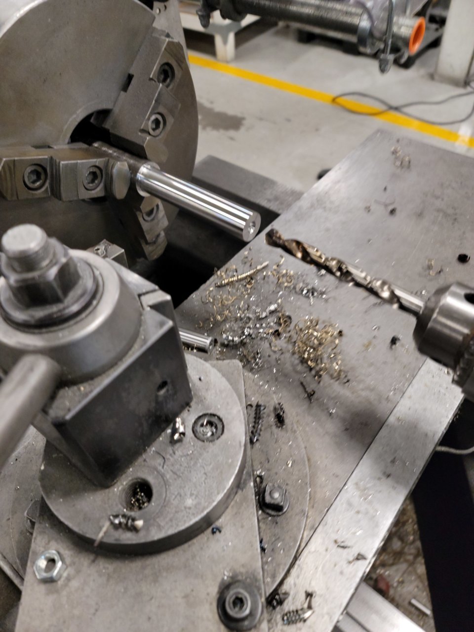

    I machined some out of 17-4 stainless the other day. Probably the strongest spacer on earth lol. @singletrack_ftw do you need some too?

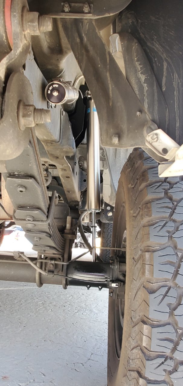

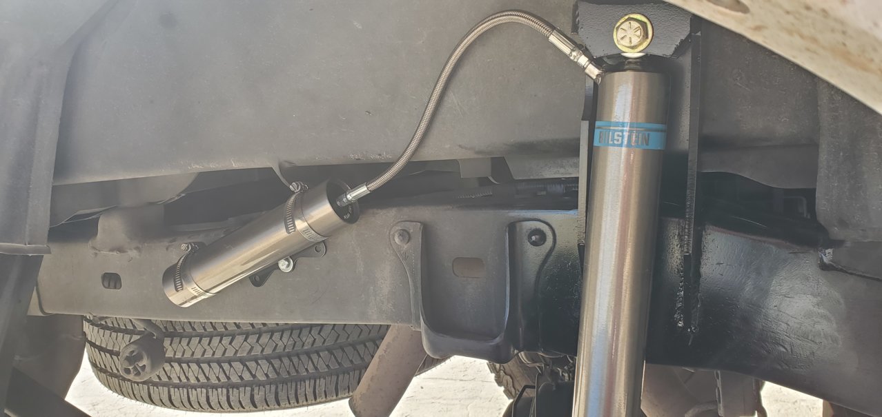

    Jumped on the 7100 bandwagon. @GHOST SHIP killed it on the install! Can't wait to really test these things out. Thanks again man!

    If anyone needs spacers for 7100s let me know

    You are a literal hero, this is fanrastic

    Done. Btw I'm not trying to make money so 10 bucks covers the cost of them.

    Made a couple more sets for anyone that needs them

    For ANYONE planning to run 7100’s without a spiffy set of spacers like these YOURE in for a nightmare of fiddling with grinding down larger spacers or adding washers. It’s a tight spot and it’s a nightmare to get up in there.

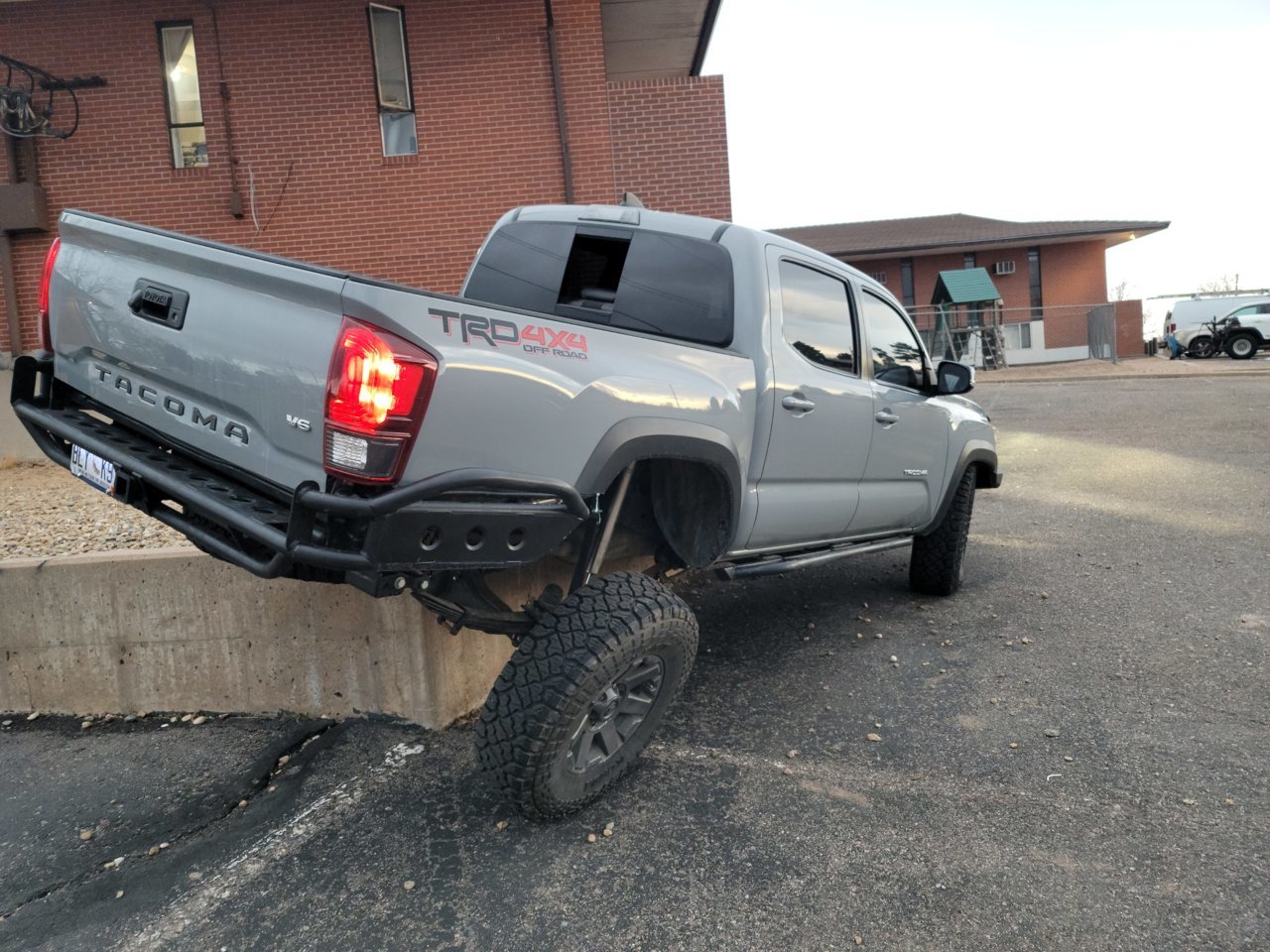

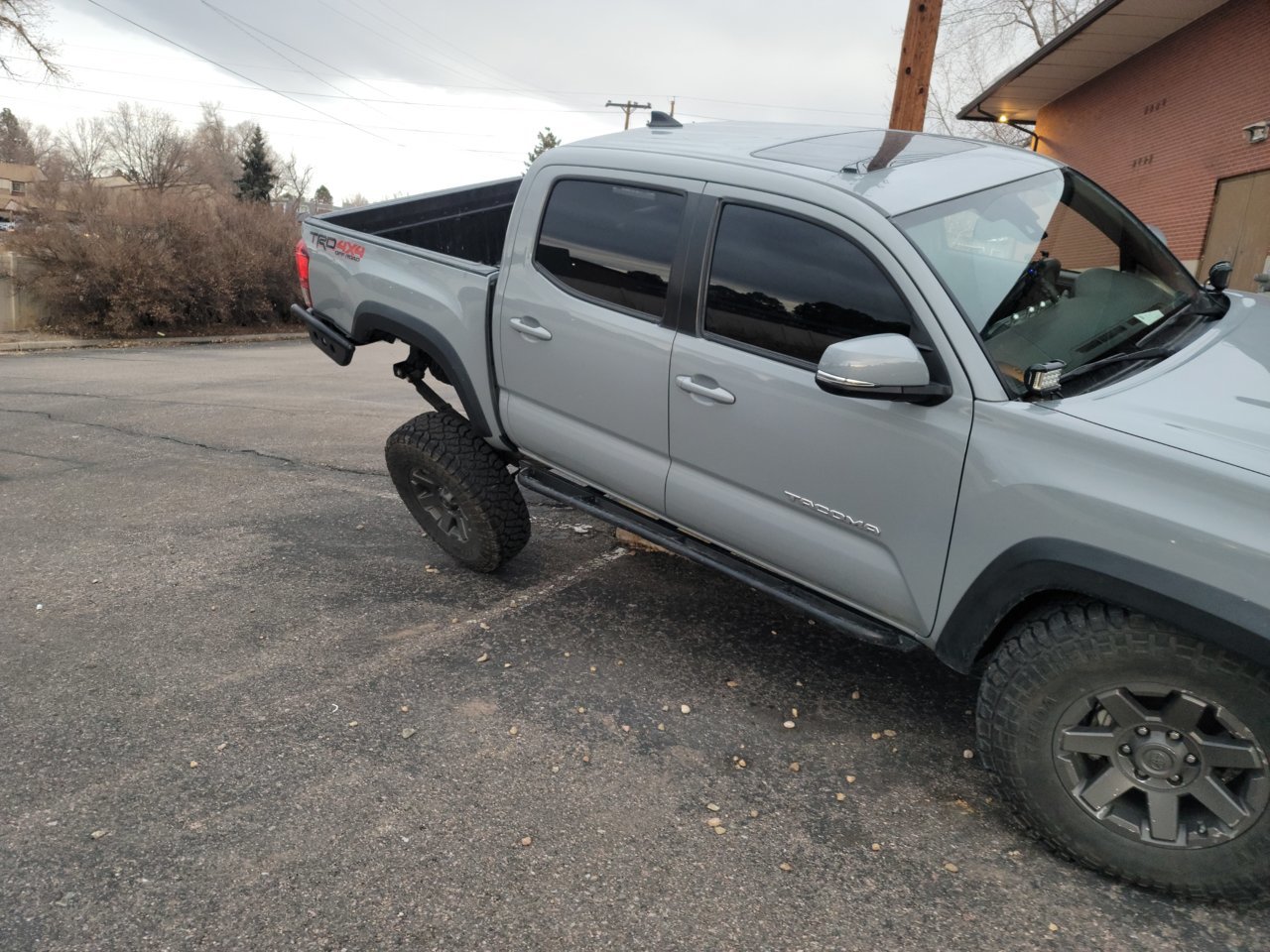

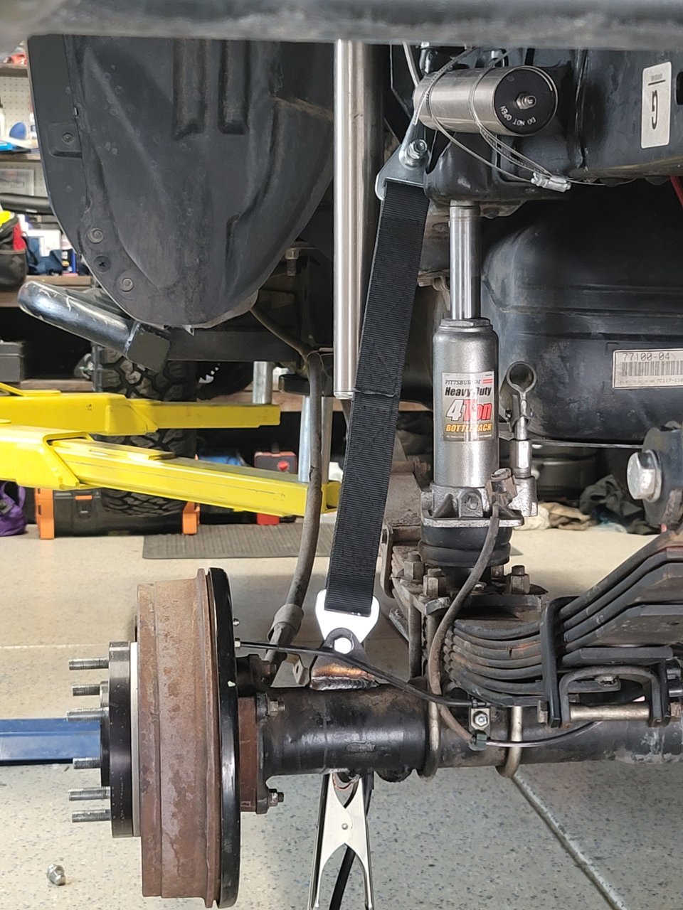

    YoU wIll oanlay gEt 12 InChEs oUt oF iT
    Silly gooses were using all 14
    Limit straps installed.
    RangerComa and Maxx like this.
  18. Feb 20, 2021 at 4:33 PM
    #958
    BEAR_KNIFE_FIGHT
    BEAR_KNIFE_FIGHT bearly famous
    May 21, 2016
    #187524
    2,618
    Alex
    Minnesota
    2016 TRD OR 4X4 DCSB Slowsand, 2017 WRX WRB
    that poor bumpski in the last pic
  19. Feb 20, 2021 at 4:33 PM
    #959
    Chadr7858
    Chadr7858 Well-Known Member
    Jun 13, 2014
    #131908
    1,914
    Chad
    Colorado
    19 TRD SHIT BOX, 02 BEST GEN
    All the mods; all the problems
    It's fine.

    You don't need bump stops
