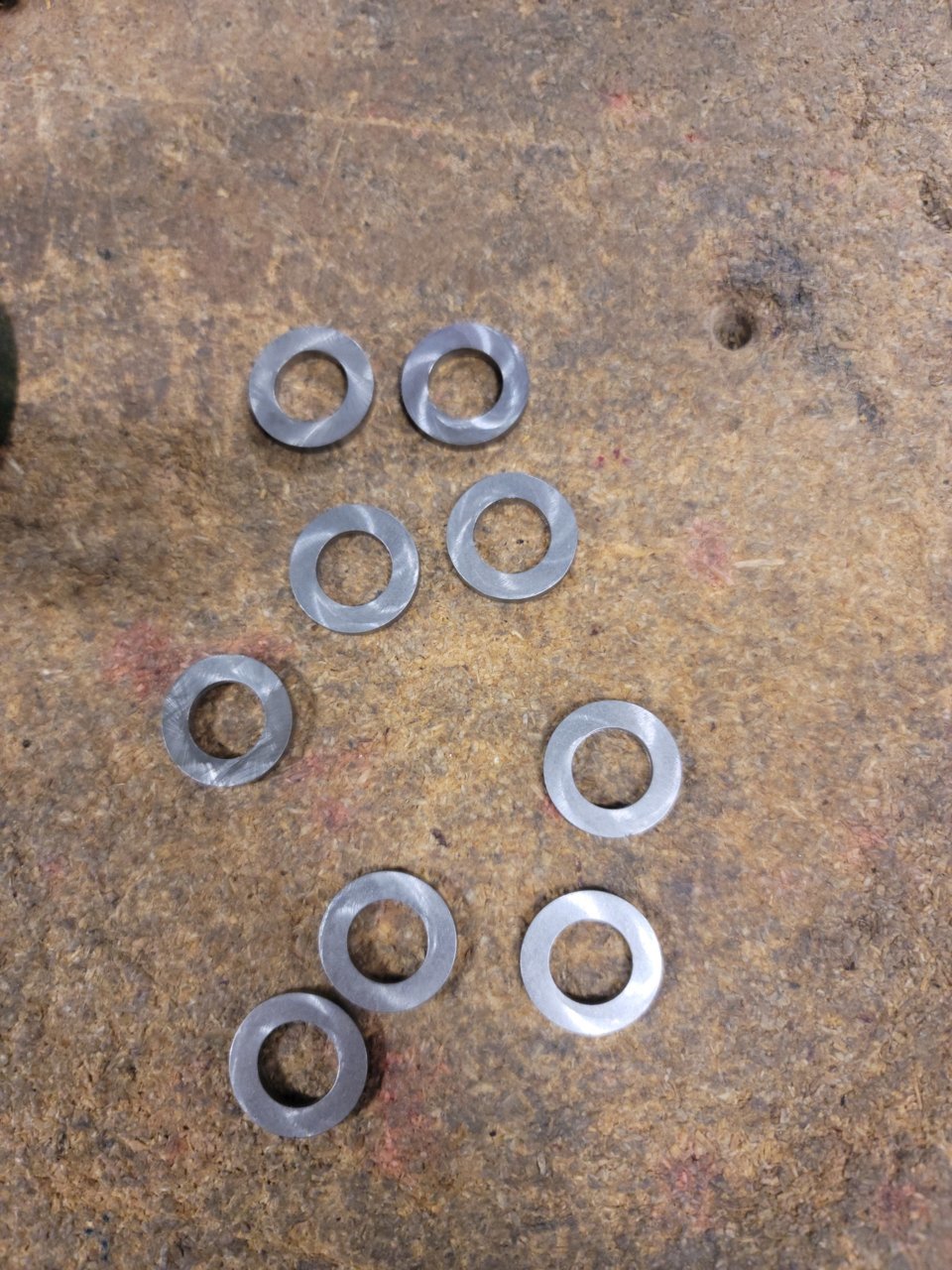

    More spacers going out! I'm happy to see people going with the bilsteins.

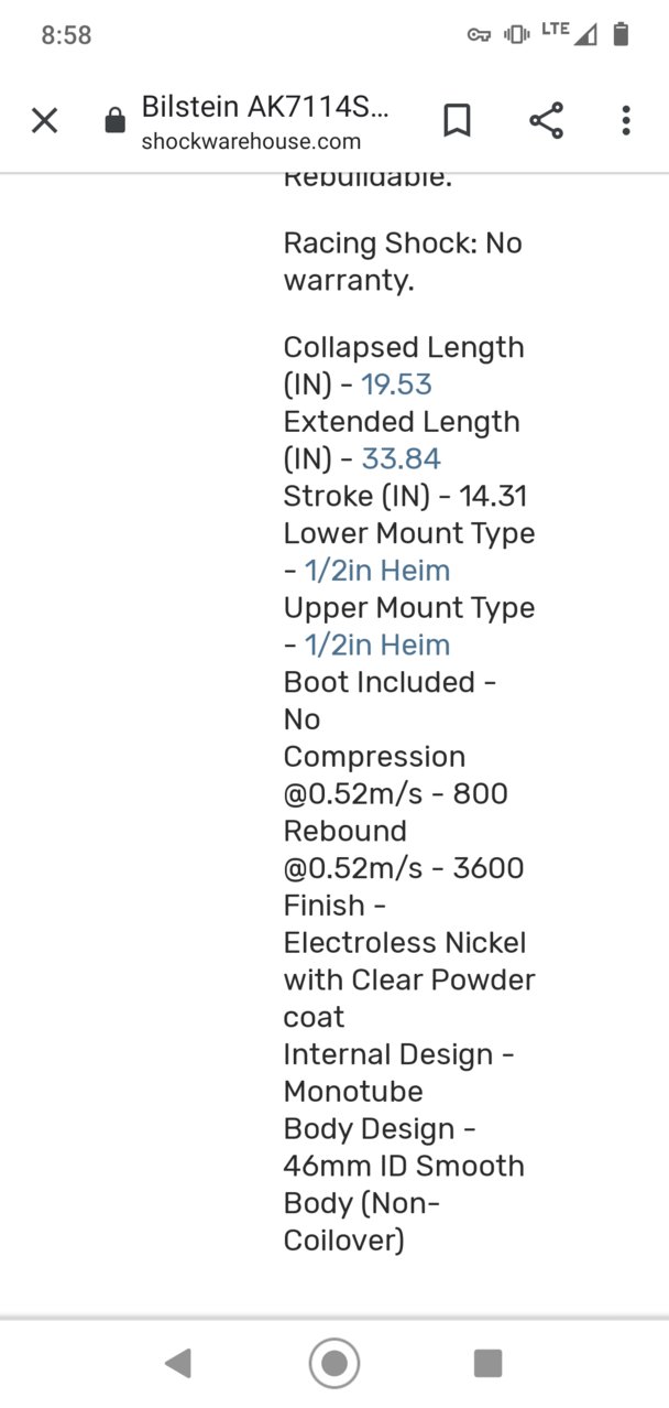

  11. Mar 19, 2021 at 1:11 PM
    #1011
    TacoEspecial
    TacoEspecial SSSlow
    Jul 19, 2017
    #224500
    1,641
    Mark
    Sacramento
    13 Sliver TRD AC
    BAMF RCLT Deaver Fox 2.5 StopTech Dana 60 37s 475:1
    The part# on mine are AK7114SB
    They also list the valving on them: 255/70
    They were listed as 19.61" to 33.34"
