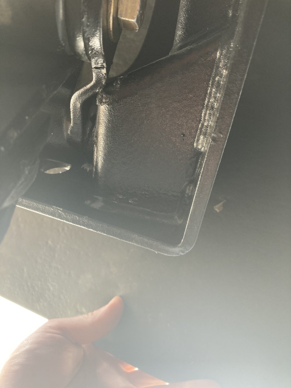

    -Bilstein 5100's EXT + 886 OME coils -Bilstein 7100 14"SB shocks -Camburg Uni ball UCA's -BAMF leaf hanger & shackle -BAMF shock relocation kit -Dakar HD leafs -U-bolt flip kit/super bumps -TRD PRO SEMA rims + 255/80/17 Ridge Grapplers -Cali Raised Led 32" hidden light bar & switch panel - Backflip tonneau -Demello tube sliders -Mobtown skid -TRD Pro grill -Custom bed rack -OVT 2.0 SFOB Tune -2WD Low mod -Kicker CS Speakers
    18EE7680-FBAA-4E82-B172-2028770B05E7.jpg Hello,
    Got a quick question regarding the hangers and HD shackle from BAMF.
    Is the grease zerk on the shackle supposed to be up or down? While cycling the suspension the shackle makes contact with the hanger.
    Thanks
