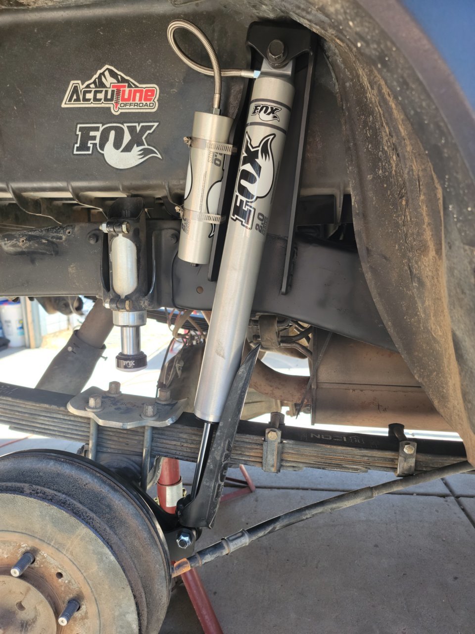

    I’ll be doing the shock relocation this weekend but I have a few questions and I was hoping you guys can help me out.
    I’ll be taking apart the leaf springs and just leave the two main ones. I will then use a jack to lift up the axle till the bumpstops just hit the frame. Which brings my to my first question the bumpstops are supposed to compress 1.75” so do I need to have 2.75” of shaft exposed?
    Also what are you guys checking when cycling the suspension?
    I think I’m just over complicating the install but I like to be prepared and have a plan.

    I just measured the distance my leafs had till full bump and added a inch. Full stuff I have about 1/4 inch of shock shaft left. It worked out perfect

    did you measured at ride height?

    Doesn't matter as long as it's not changed when you measure for shock length

    Fyi
    This is me now and I think I should be able to get a little over another inch of up travel.
    I have lots of room for my tire but that's about where my bump stops max compress stopping my up travel.
    So for me I'm going to move the lower shock mount down about 1.5".
