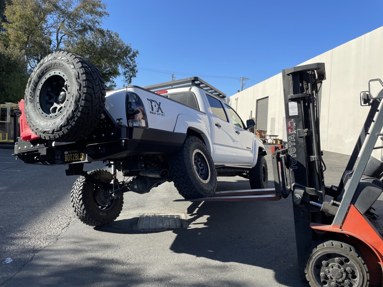

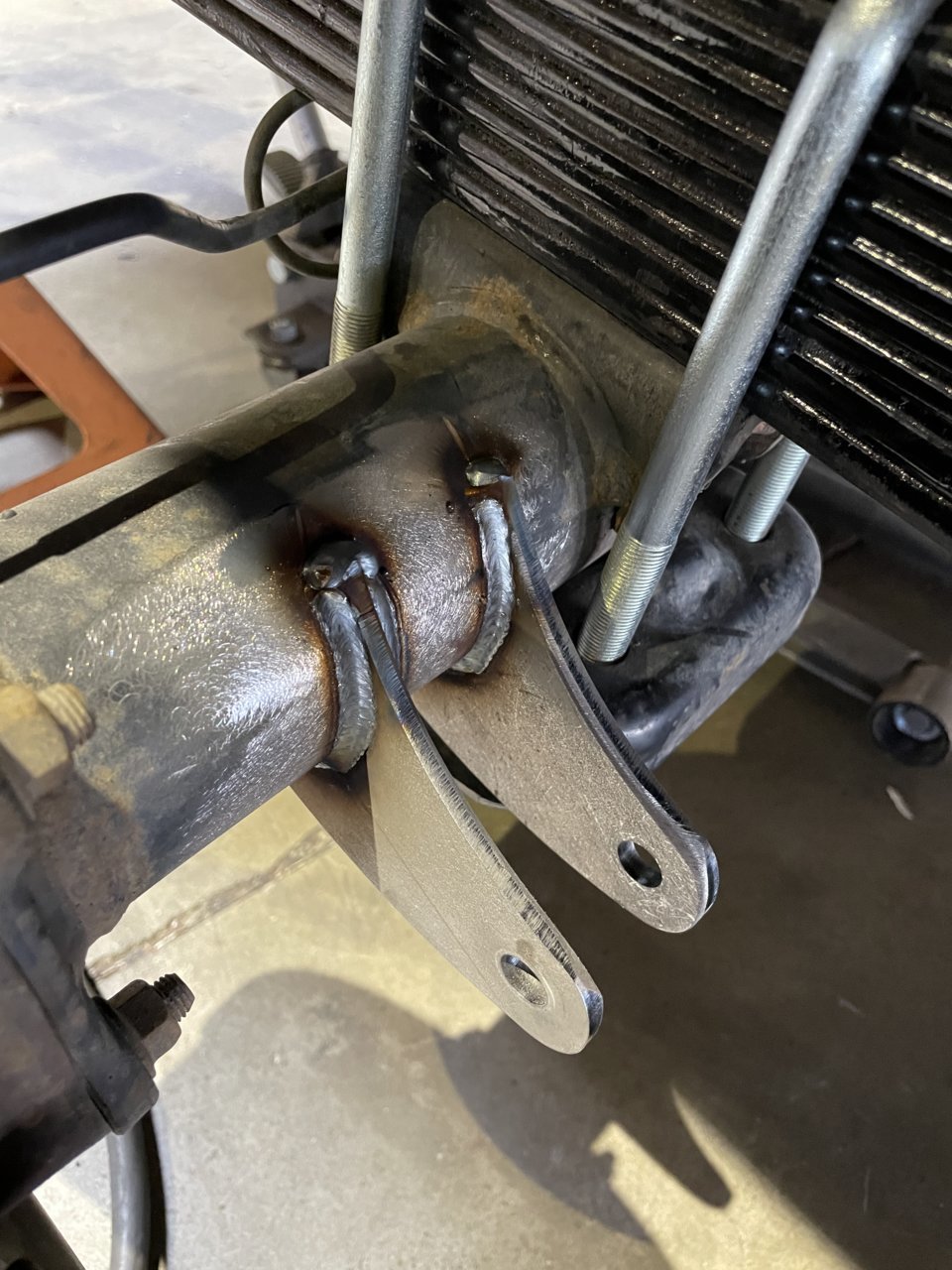

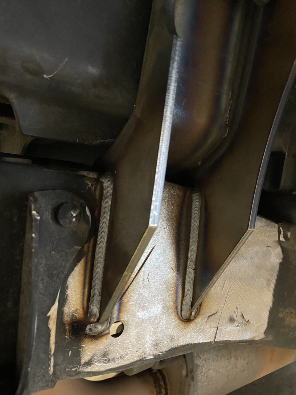

    Got everything welded up yesterday. I’m gonna change up how I mounted the Resi’s and then pull everything back off to paint. Then I can move to installing everything on the front hopefully sometime soon!

  6. Aug 2, 2021 at 5:53 PM
    #1066
    Vegasstunts
    Vegasstunts Well-Known Member
    Dec 27, 2019
    #314287
    751
    16 TRD sport
    All of them.
    Those welds doe!!!
    Baja13[QUOTED] likes this.

    Did you weld that yourself? WOW! Those are some serious beads......I might have to drive all the way out to Cali and have you do mine.

    I did haha, it’s what I do for a living tho so I’m glad they are up to par:rofl:

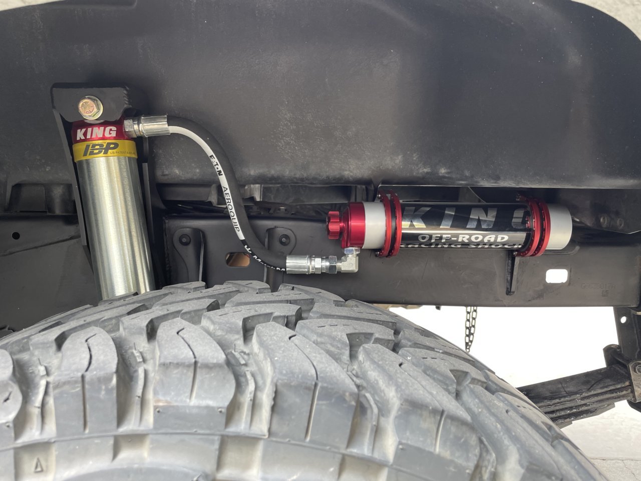

    did you have any shock mount binding due to not having a spherical bearing? I'm in the same boat, getting some billys for now until the kings come in. just worried about the rubber on the shock mount when im flexing out
