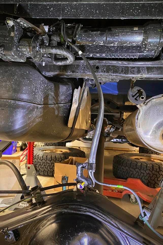

    Yeah man! I kinda went all out in the rear. While I was there kinda thing…

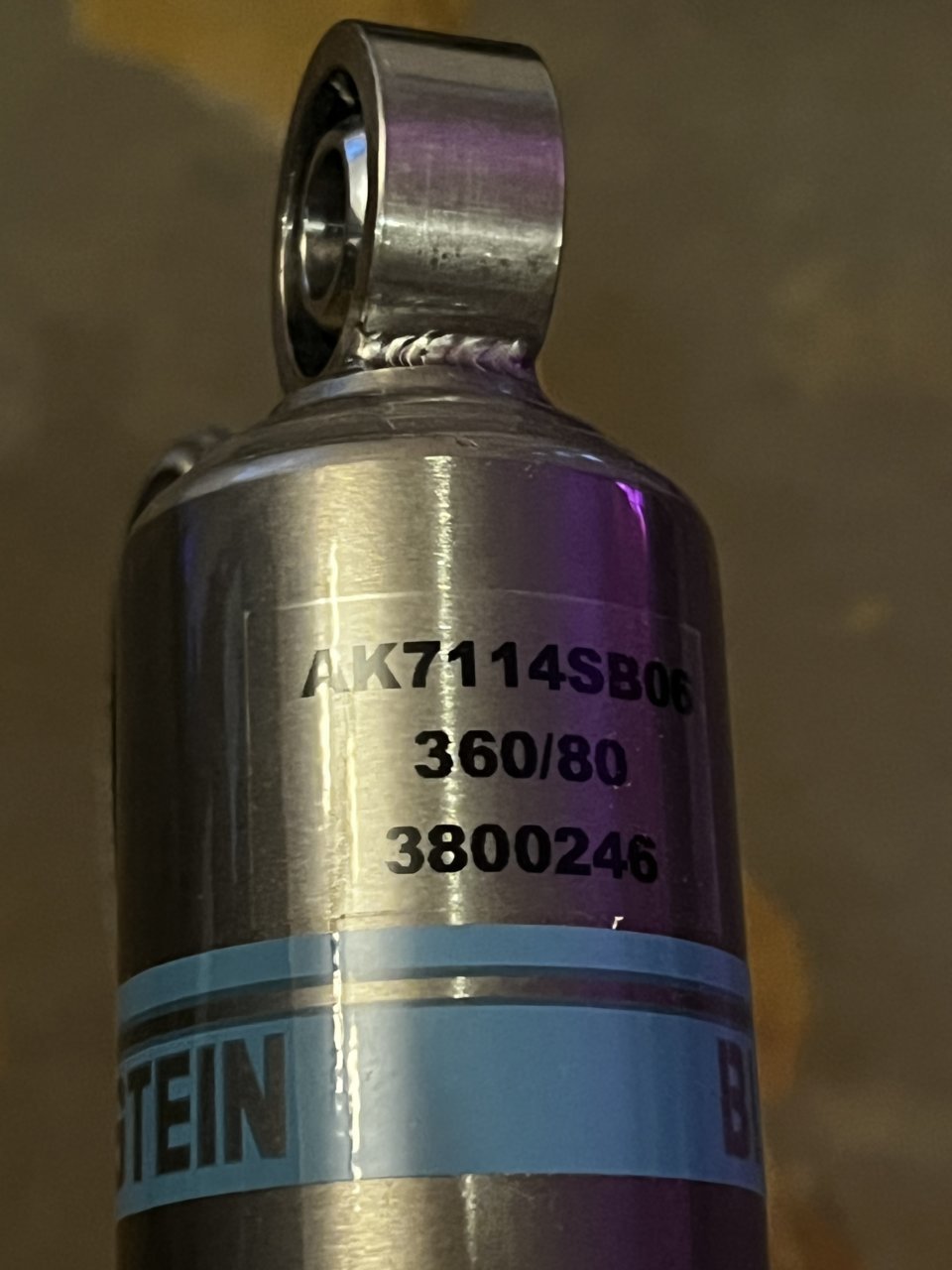

    One of my 5160’s is dead so I ordered my relocation kit and a set of 14” 7100’s w/ 360/80 valving. Last set I could find at the old pricing. Bilstein raised the price to $250 a shock. Ordered limit strap tabs as well. Anybody have any suggestions on strap length?

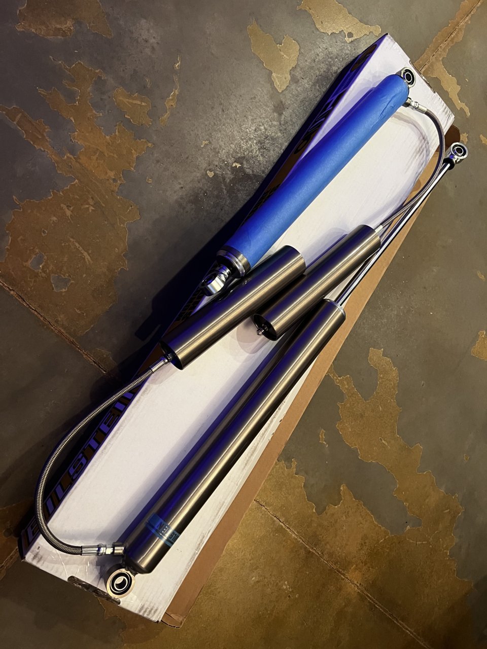

    Amazon with the quickness. Purged the nitrogen and started taping them up so I can work with them. Won’t have time until early April for this project but I’m excited.

    I’m not sure what you mean by stretch. What is stretching?
    I went with the heaviest valving per @Chadr7858 experience with them. I can also re-valve them if they are too much.

    I was going to try 278 valving but it has been discontinued by Bilstein and can only be ordered as a custom valving now or you can do it yourself. There were some 278’s on eBay still they wanted a premium for them and wasn’t worth it. I found this set at the old price on Amazon and had them within a few days. Here are 2 videos for rebuilding and re-valving 7100’s.
