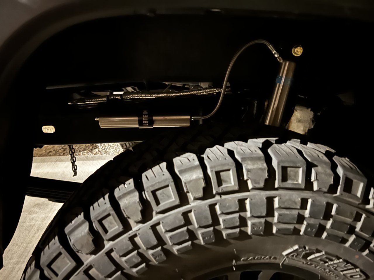

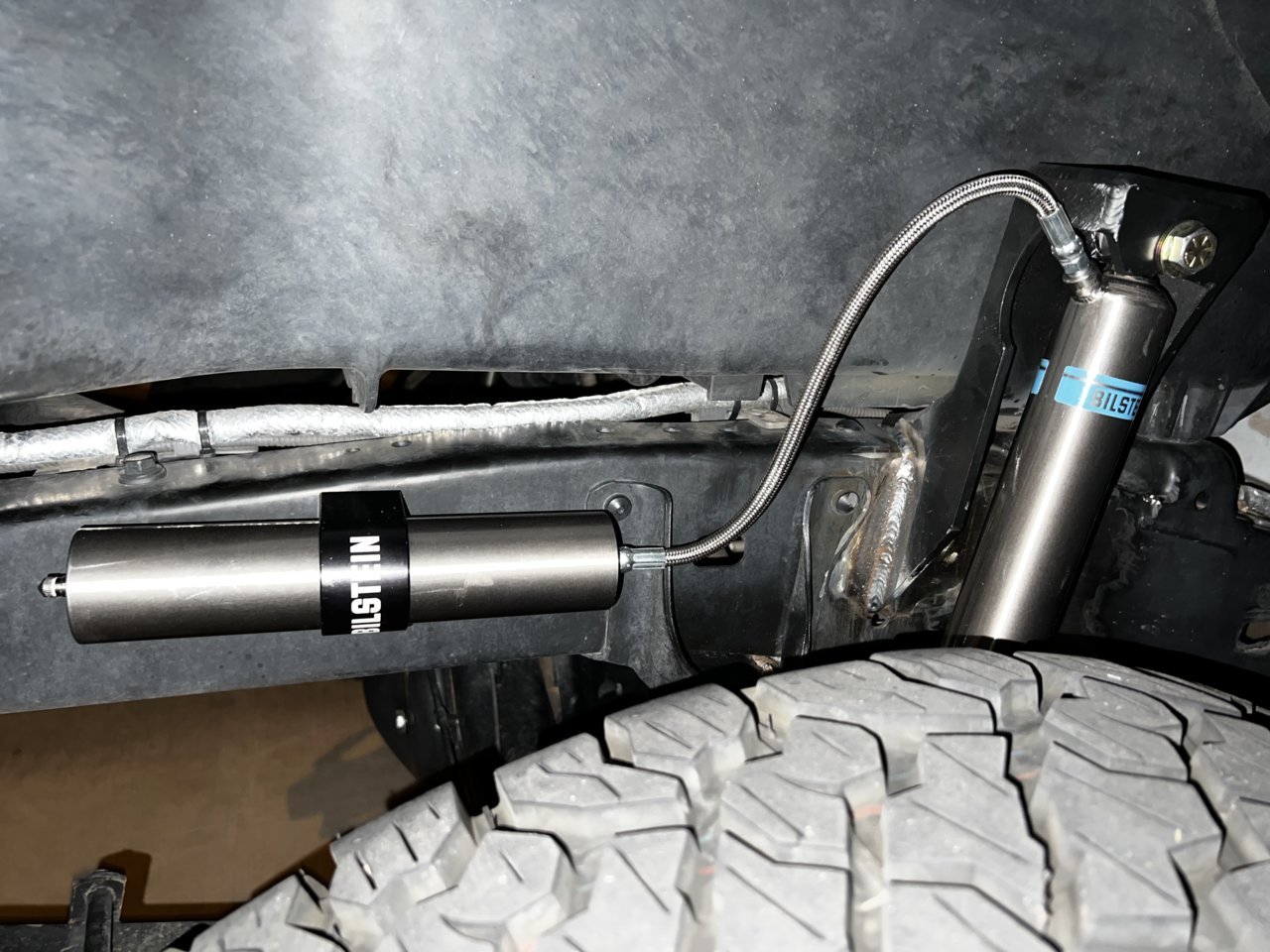

    Finally getting to it.
    JKU3000, Texoma, dk_crew and 2 others like this.
  10. May 26, 2022 at 10:02 PM
    #1150
    Maxx
    Maxx Well-Known Member
    Dec 30, 2012
    #94017
    1,397

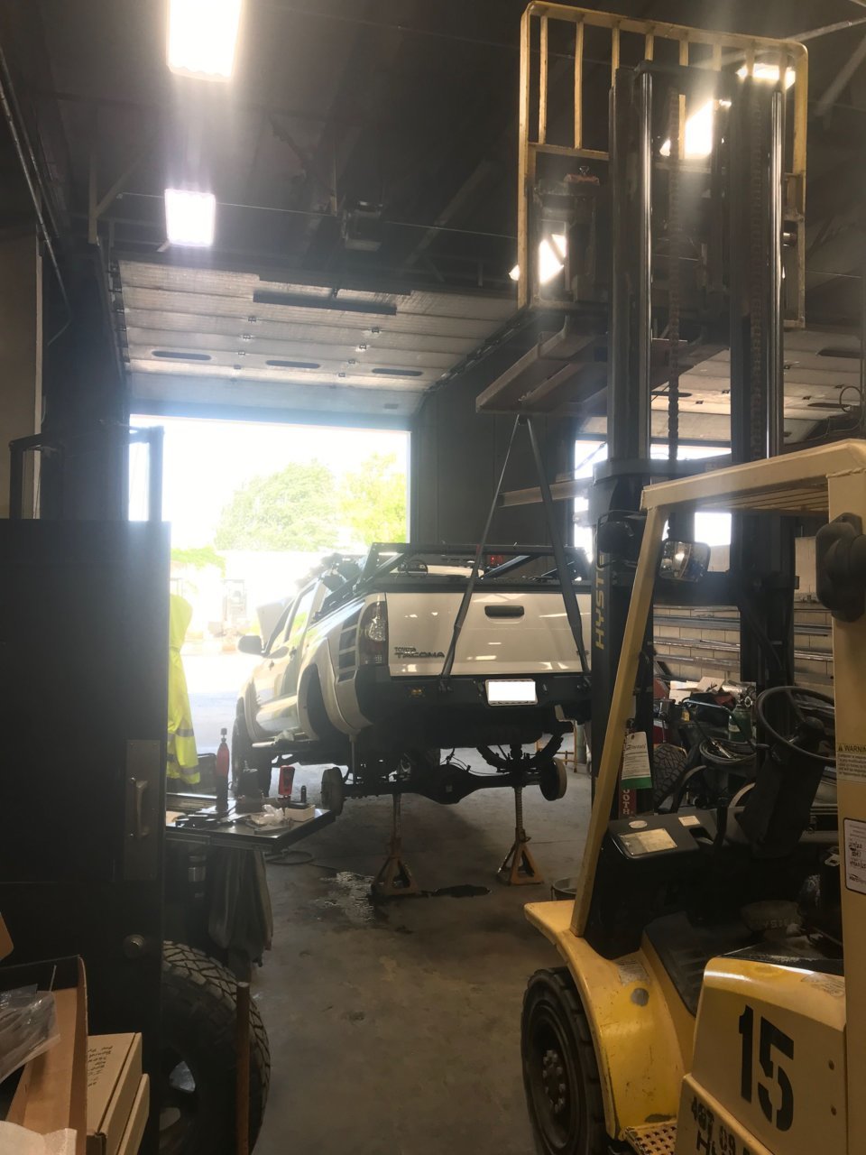

    Between work, life and it just being hot AF, this has been a week long project. Still need to take the shocks back out and paint everything, put in tabs, straps and do the brake lines but at least I have shocks again. Been running Bluetooth shocks for close a month. I was actually surprised how well the truck drove with just Deavers and the BAMF hangers. Stole the reservoir mounts off my old 5160s. It all turned out pretty good but wasn’t easy. Lots of grinding. Shitty dark pictures but you get the point.

    For anyone who was curious, 360/80 valving in the Bilstein 14” 7100 SB is too stiff for 300-400# extra in back. Going to pull them and revalve in a few months. Just my initial opinion.

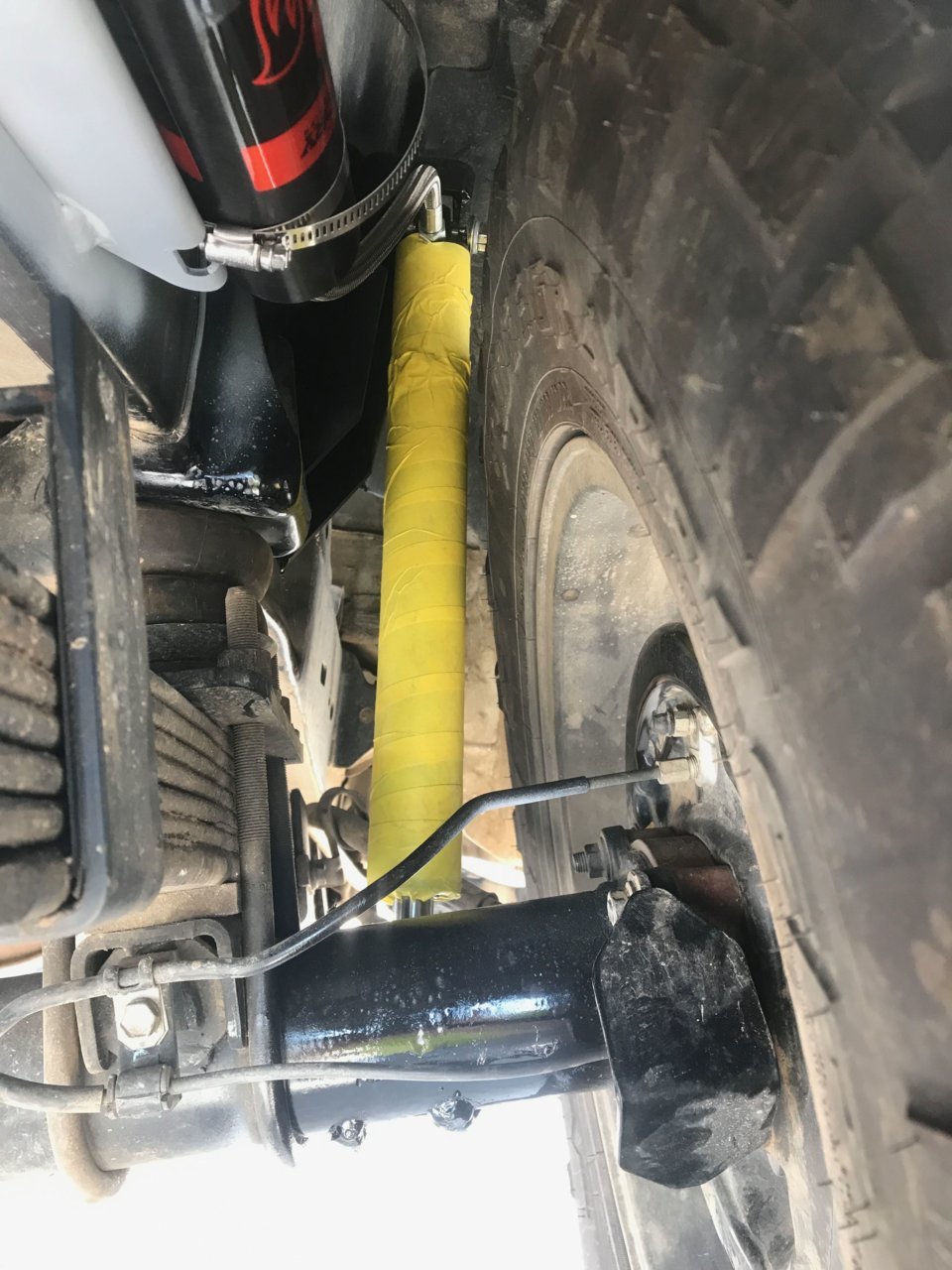

    Maybe this will help some out. I have about 1/4" to 3/8" of room between wheel and shock when stuffed. Running 285/70 17 tire with a 9" wheel and -12 offset. Shock is a 2" smooth Fox shock. (has yellow tape on it in picture)
    25" of flex with sway bar. (now removed:D)
    I don't have a lift but......
