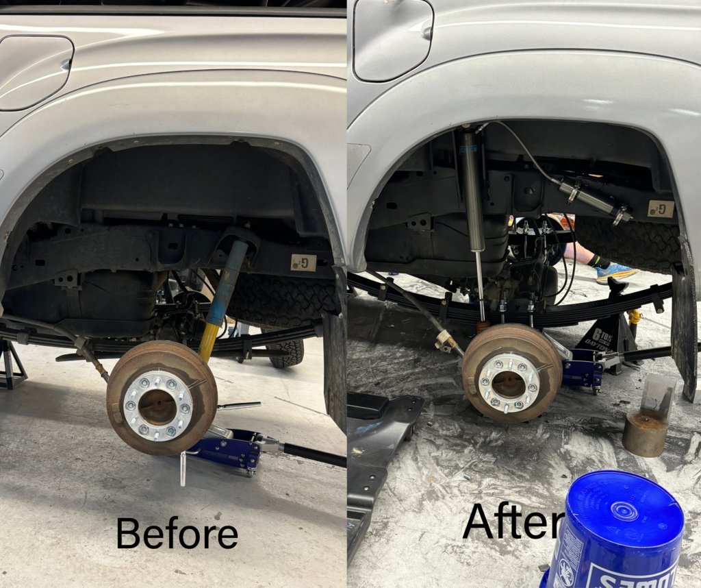

    Fused up. Waiting game for shocks.

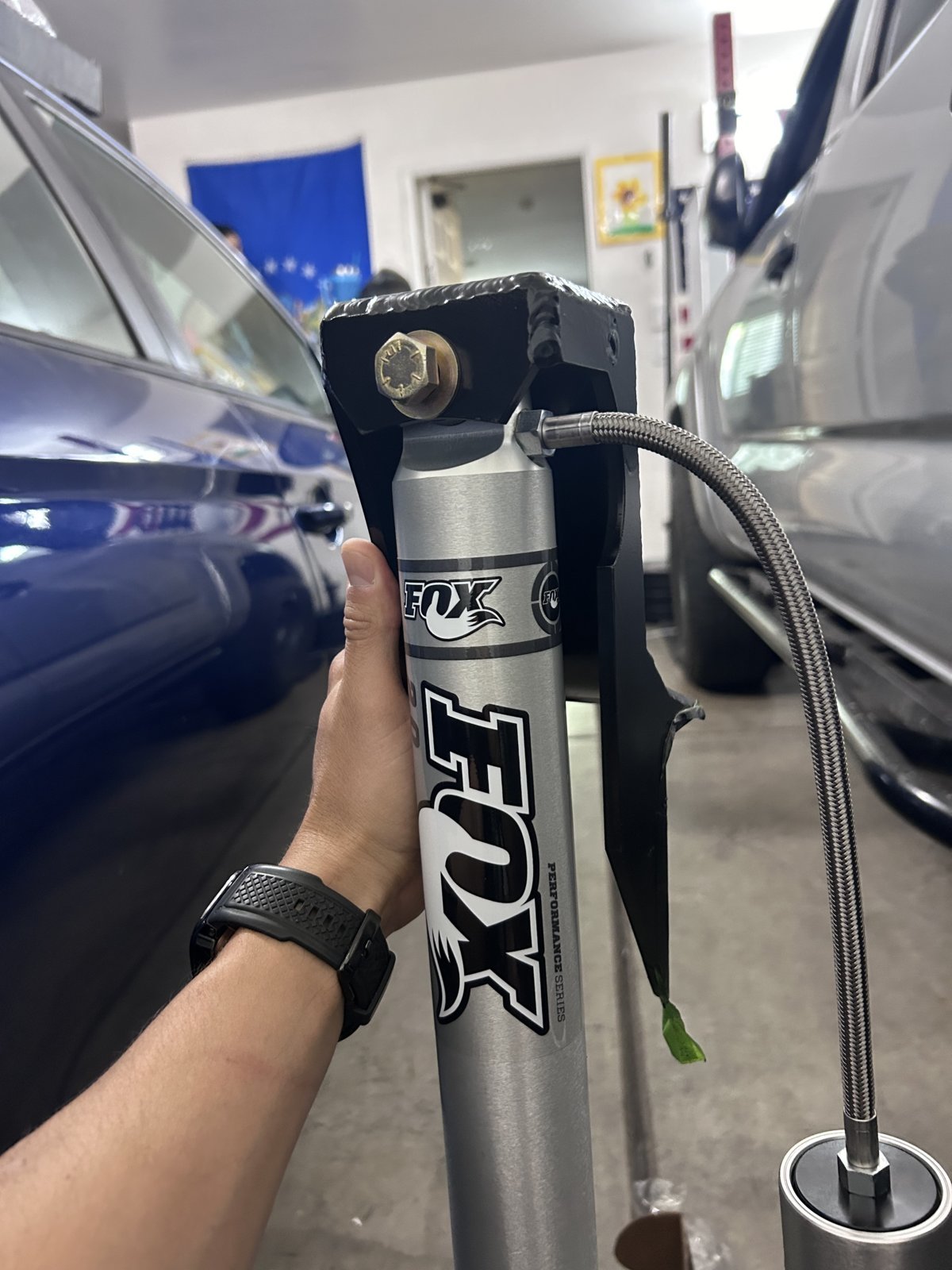

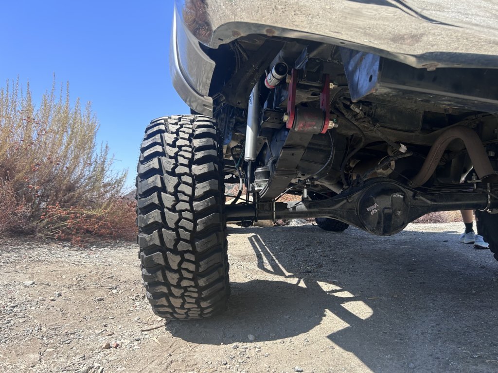

    In lieu of the 7100’s not returning to stock in the valving I needed with my provider I decided to pull the trigger on some Fox shocks 14.1” pn: 985-24-055 will not be able to mount until next weekend but here they are. Everything clears.
    *set up combined with Chevy 63”s

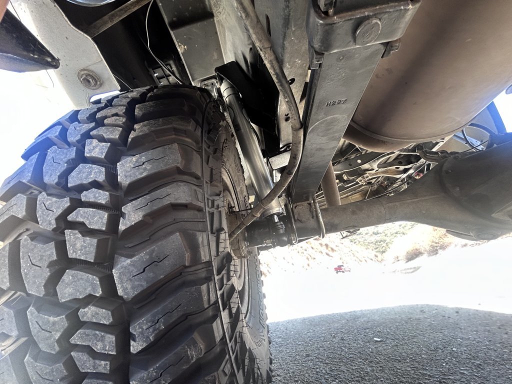

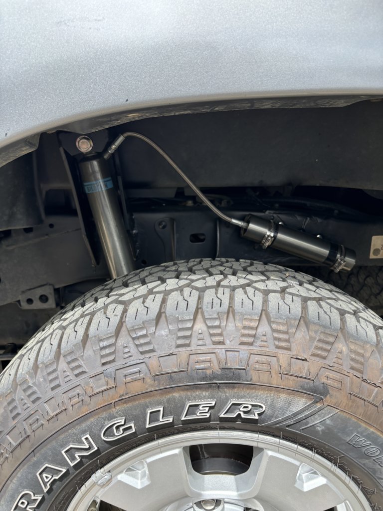

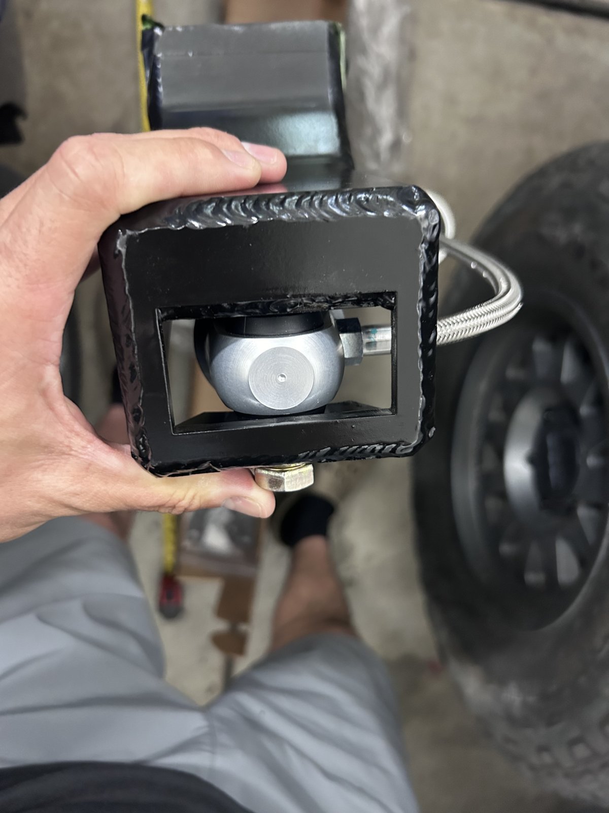

    Edit: no need to cut shit, all good. No contact.
    Has anyone cut the towers just below the reservoir hose notch and extended the towers about 2” higher? Or everyone just dealing with diff mounts at about 45•. My set up is Chevy 63 and 14” shocks. Asking for a friend :anonymous:
