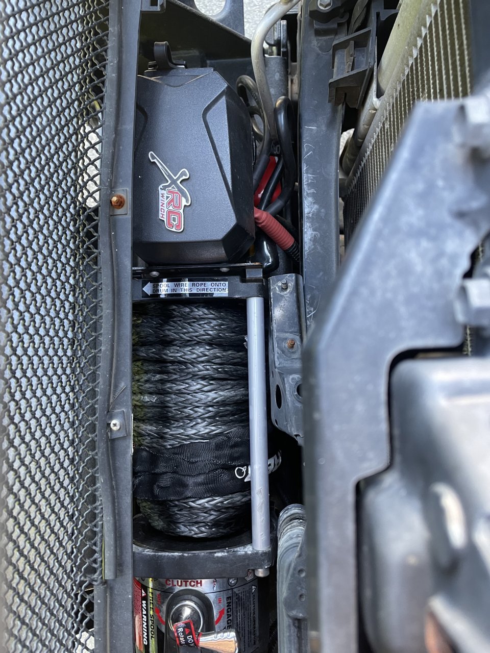

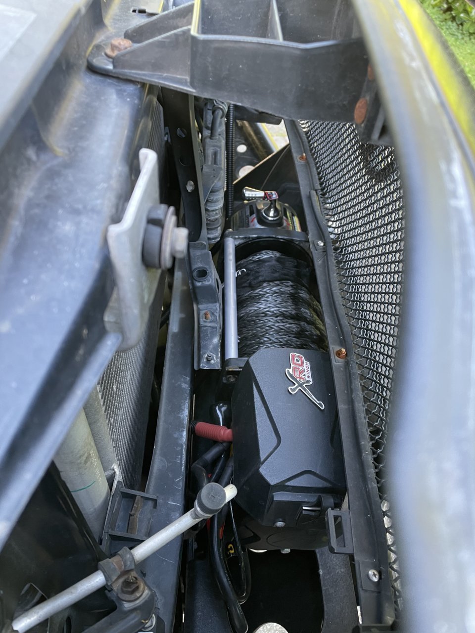

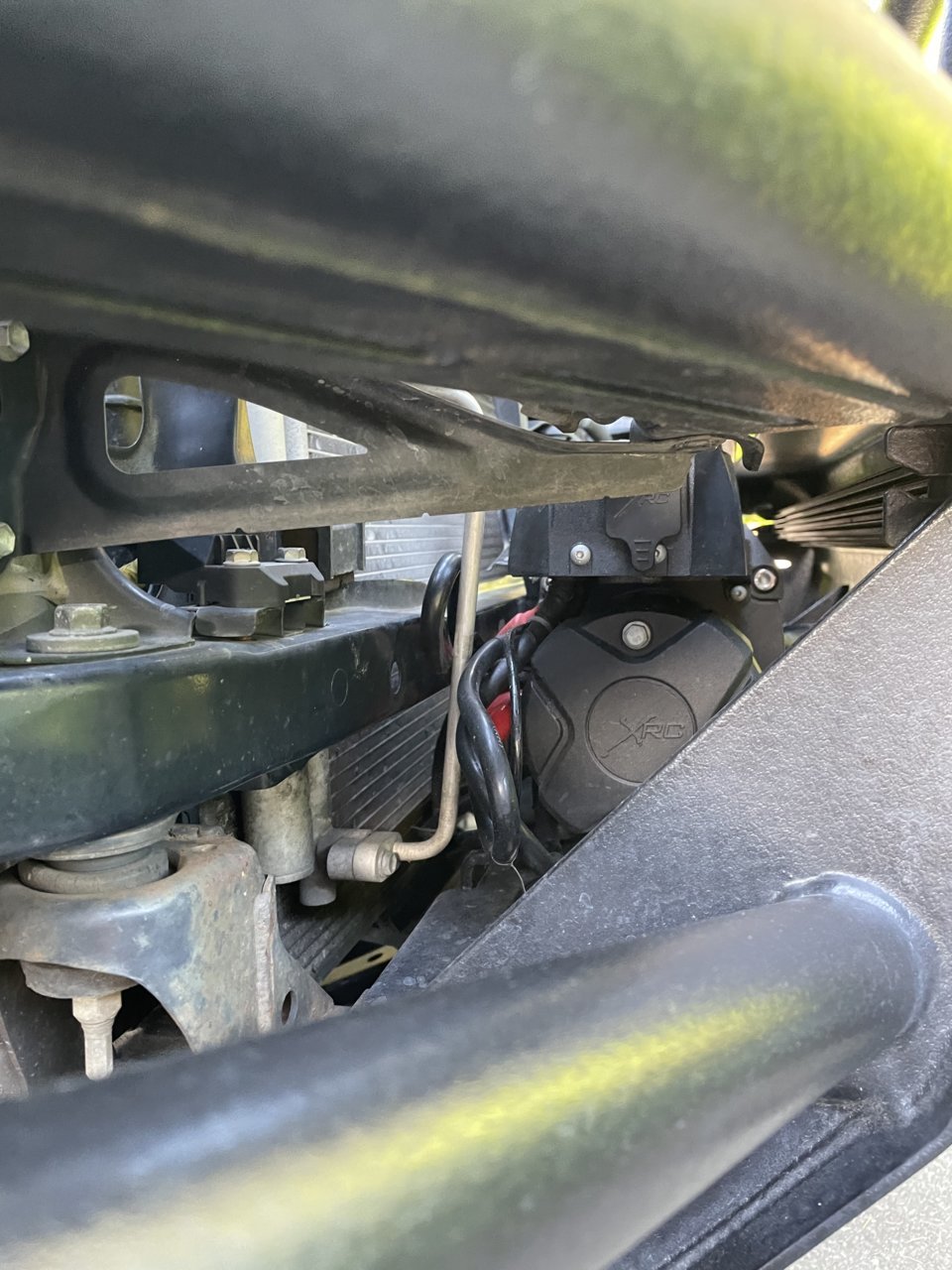

    I have a smittybilt 10k in mine. I put the control box attached to the winch on the passenger side of the truck. It also makes a controller easy to plug in if your winch controller is wired

    Thanks for the reply. Are you saying the control box is still attached for on the winch? They are similar size winches and I don’t see mine fitting. It looks like top mount is only option

    Here’s some pictures. I have quite a bit of space left too

    Interesting. When I eyed it on top doesn’t look like it will fit. Then j lee said it wouldn’t. I would think the smitty and warn are about same size. Maybe I need to try to install with it on top

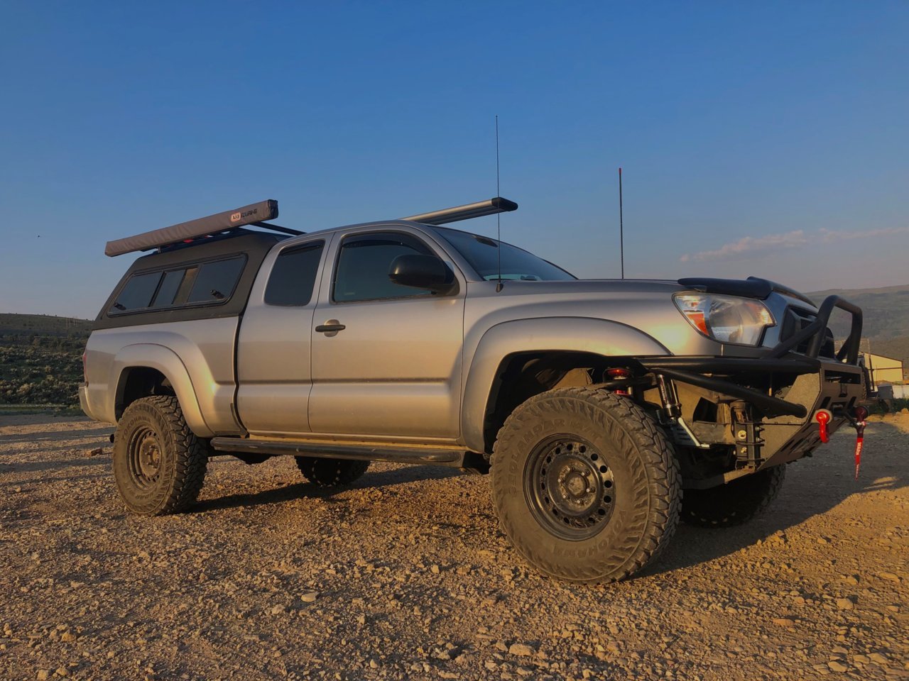

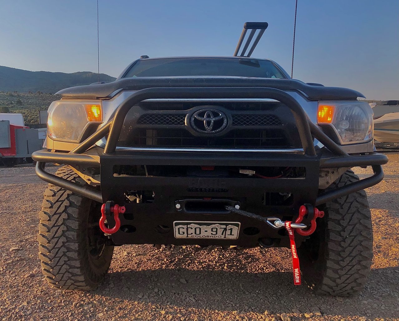

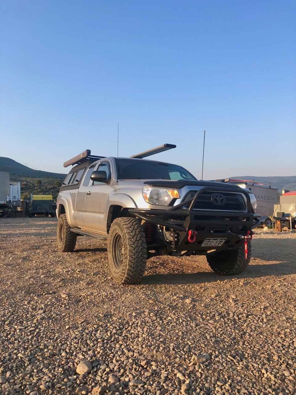

    Got the new bumper on last weekend. Very impressed with the fitment and fab work. The reinforcement brackets are super beefy. Going to have a lot more confidence winching with those on there.
    One thing to note - you may have to clean out some of the holes on the bumper/reinforcement brackets to get bolts to fit because the powder coat is THICK (not complaining). I had to clean out reinforcement bracket holes, the bolt holes on the inside of the bumper where the reinf. bracket connects to the bumper, and the fairlead mount holes.
    Went with a Warn Zeon 10k synthetic for the winch. Super quick install, didn't have to mess with the control box at all. The lower grill mount was barely hitting the control box, so I just ended up taking it out completely. Super clean fit and no rattle from the grill.
    Had a 30" RC dual row light bar laying around that I tried to throw on the bumper but the mounts were too close together. Didn't feel like messing with the powder cut from cutting, grinding and welding the mounts back on farther apart so I'm just going to order a skinnier light bar. Something to keep in mind when ordering bumper accessories.
    Can't wait to go beat on this thing! Thanks Jerry, you make one hell of a product. Rear bumper and HD shackle hangers are up next!
