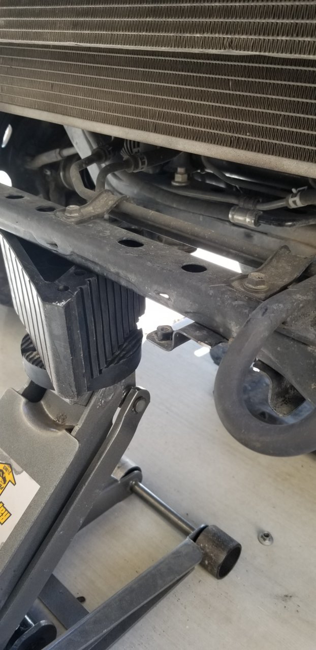

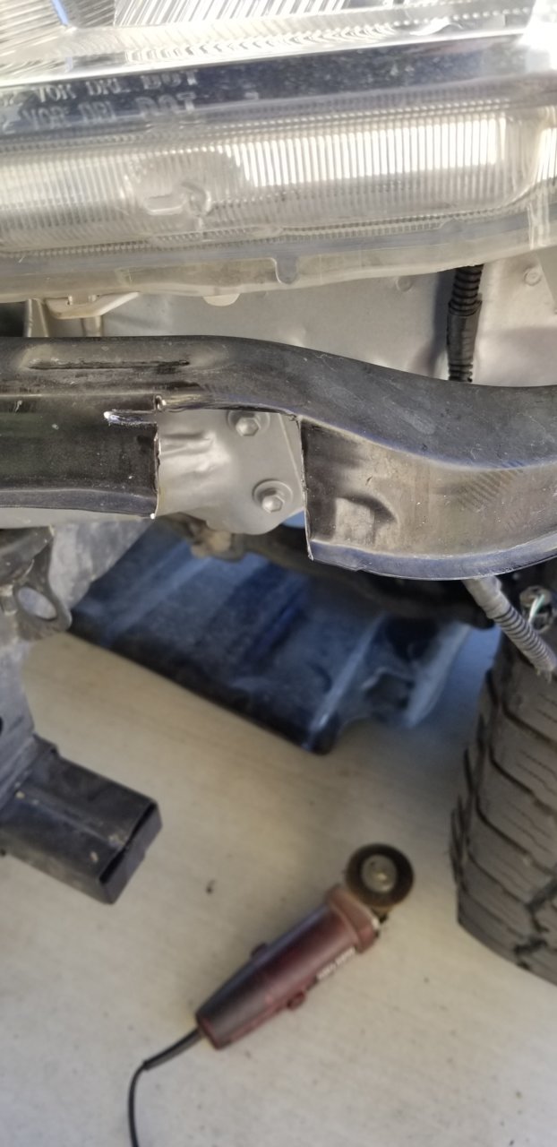

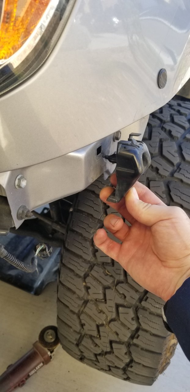

    Where exactly do i notch the channel for the bumper to fit? :(

    2012 - 15.... to help with the guesswork...
    Cut driver side skid plate nipple.
    Trim here under headlight
    Remove plastic end caps

    I'm so confused... @JLee says all you need to cut is the splashguard... now this guy is whacking stuff off with a cutting wheel!!

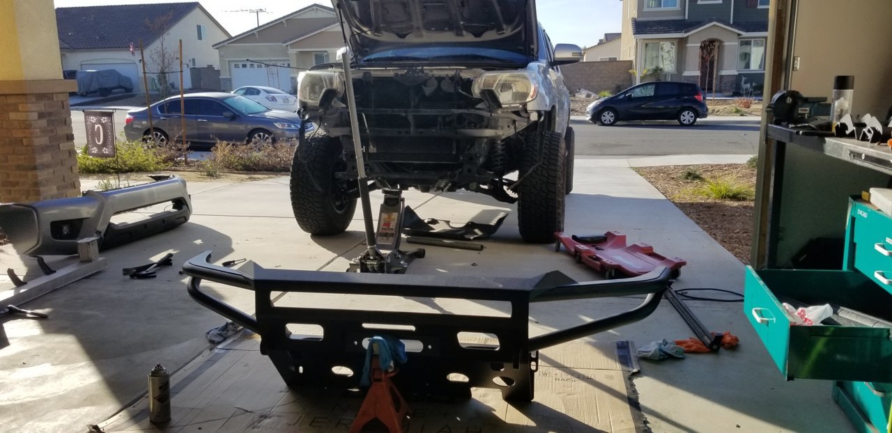

    It will take you a few on and off tries to see where you have to trim but its not to bad.
    And i didnt realize i would lose my grill lower mounting tabs, but then again any aftermarket bumper on the market will be the same.

    @Beer-toe yeah mine will be in a few weeks from now. Not sure what your top picture is showing....?
    Also not sure what a skid plate nipple is, and I am not gonna google it on my work computer!

    On the stock skid plates they have little fingers on the frame so when you unbolt it, it wont fall down. You just have to trim the finger off so the bumper will go flush if that make sense.
    And remember to tie im the reinforcement brackets the same time i had to redo everything again:) lol
