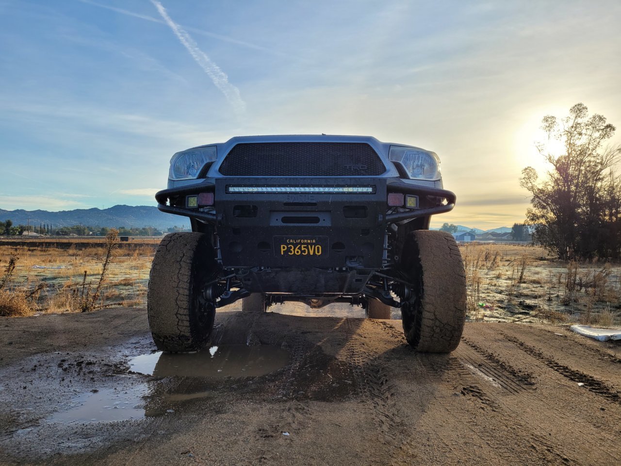

    Beer-toe
    Beer-toe Well-Known Member
    Apr 3, 2018
    #249325
    1,286
    Berto
    Menifee
    Dad Mobile
    Stickers
    Need to align it to 100% but its in

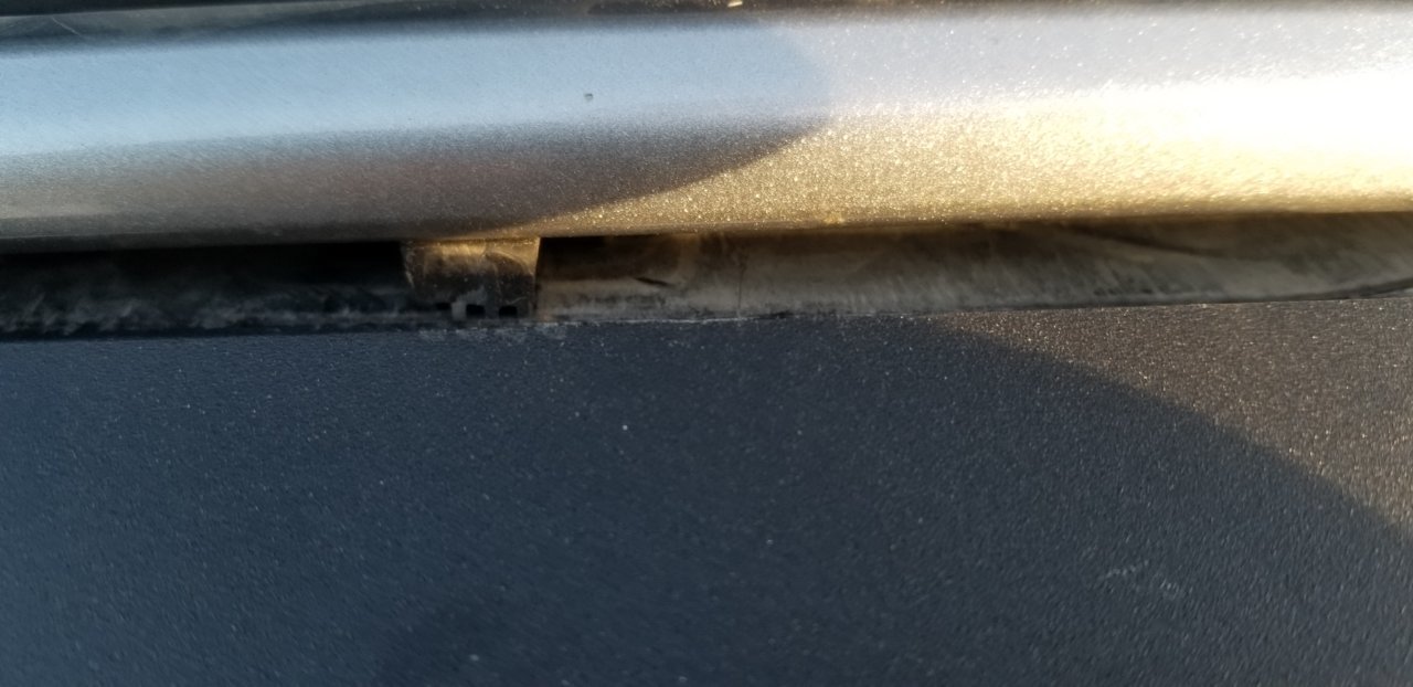

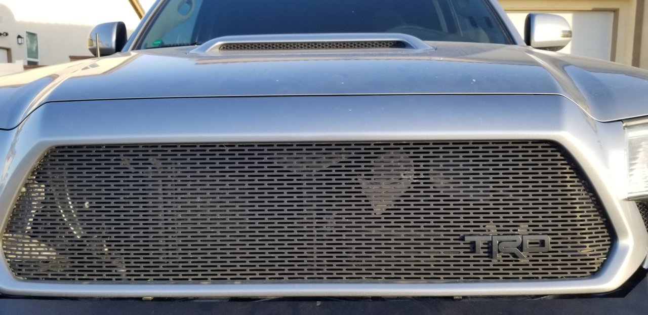

    My front is signing now, or whistling at 60+ mph, you guys experience this also?
    Wondering if its that gap for the light bar or because my truck squatted and now it has a slight rake

    Found the noise! Because the lower grill is not supported it created a pocket where it meets the hood and just enough space to make it sing lol
    I found some sticky rubber pads but it underneath to put tension up to the hood and close the gap and now its silent :)
    Im happy now lol

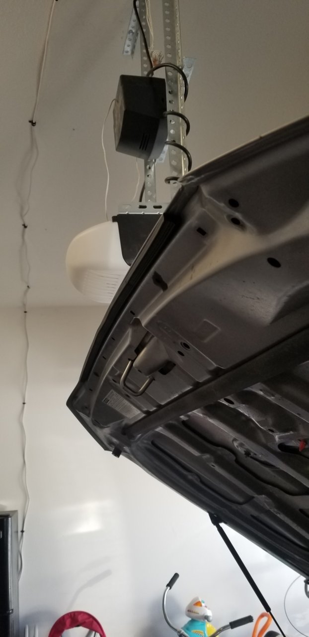

    @jjeffries4
    I added 2 rubber pieces here and added a strip on my hood.... no more whistling

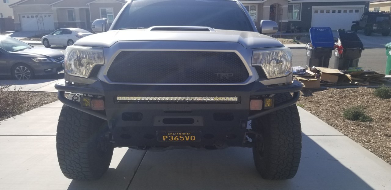

    Well finally got my bumper on, and all the little tips and tricks helped a ton. Thanks @JLee and @Beer-toe
