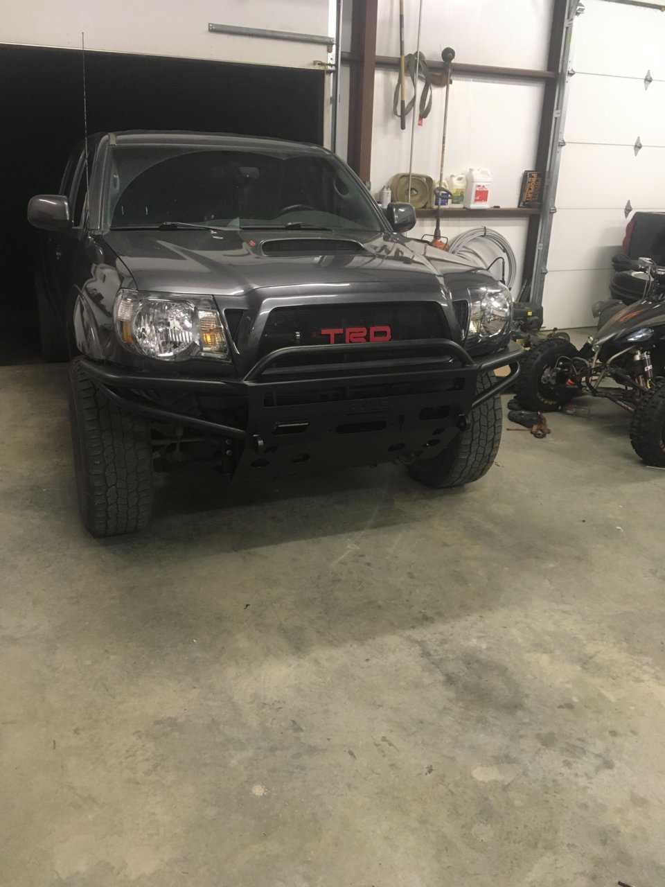

    Got mine put on today. Just need some lights now. 87E04BA3-710F-4D10-A04E-8CDC00D1D556.jpg49B94CE3-AEC5-4178-9D3A-85309F107847.jpg

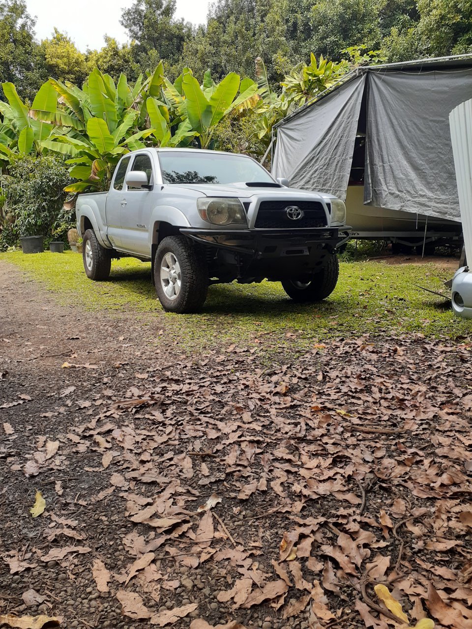

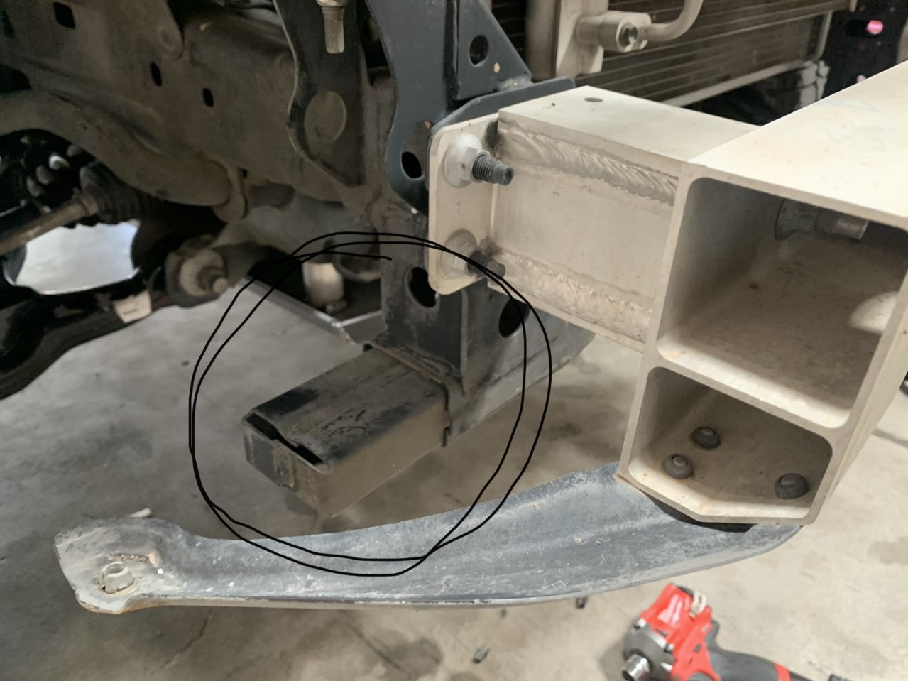

    I just started the installation process. Everything is ripped off. Can you tell me if I need to remove these for the frame brackets? Can’t get brackets to line with bolts with them there
    Also. Am I correct holding the bumper onto the vehicle is just the 6 bolts from the aluminum crash bar. Then the additional 6 bolts for the reinforcement bracket?

    Remove them. and yes the bumper mounts with the six studs and the 6 grade 8 bolts provided.

    Thanks for the reply. Is it the single bolt underneath for each side? Does bolt get tossed or reused for bracket/bumper?

    yes a single bolt on the bottom they are not reused.

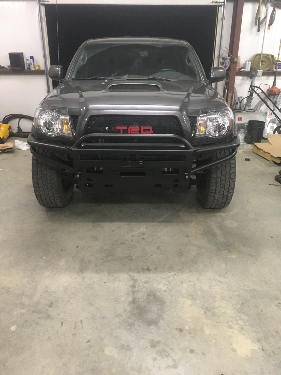

    In case anyone is on the fence about a no hoop 05-11..(dont mind the dent :hattip:thats another story.)20210328_132339.jpg
