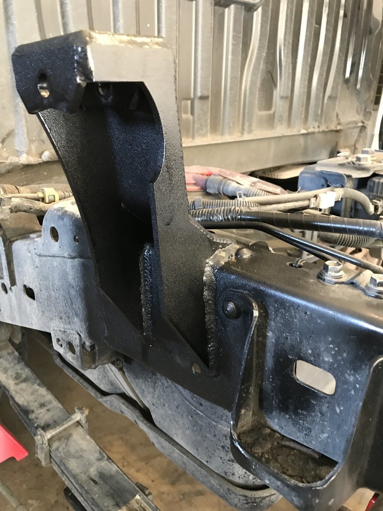

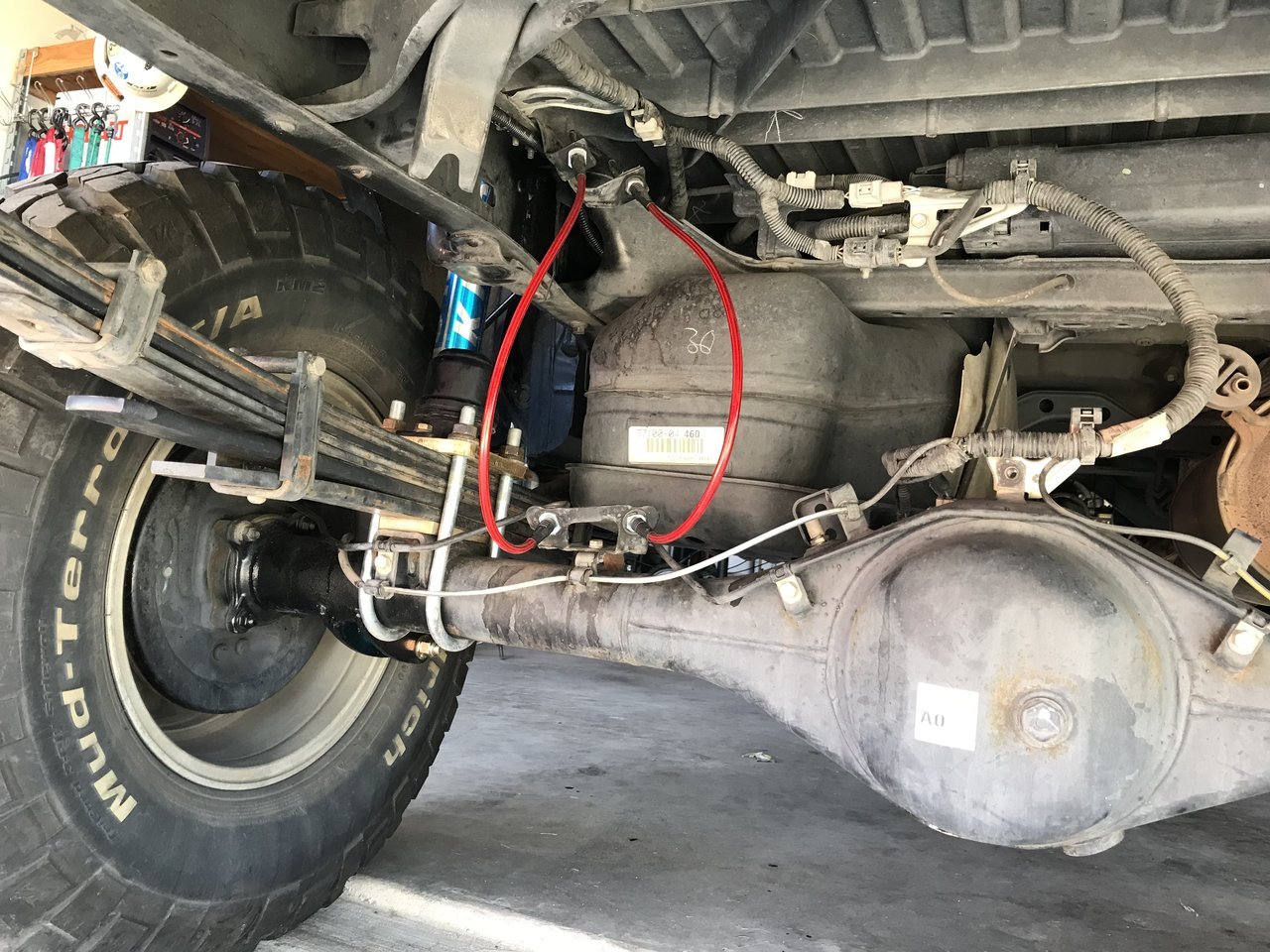

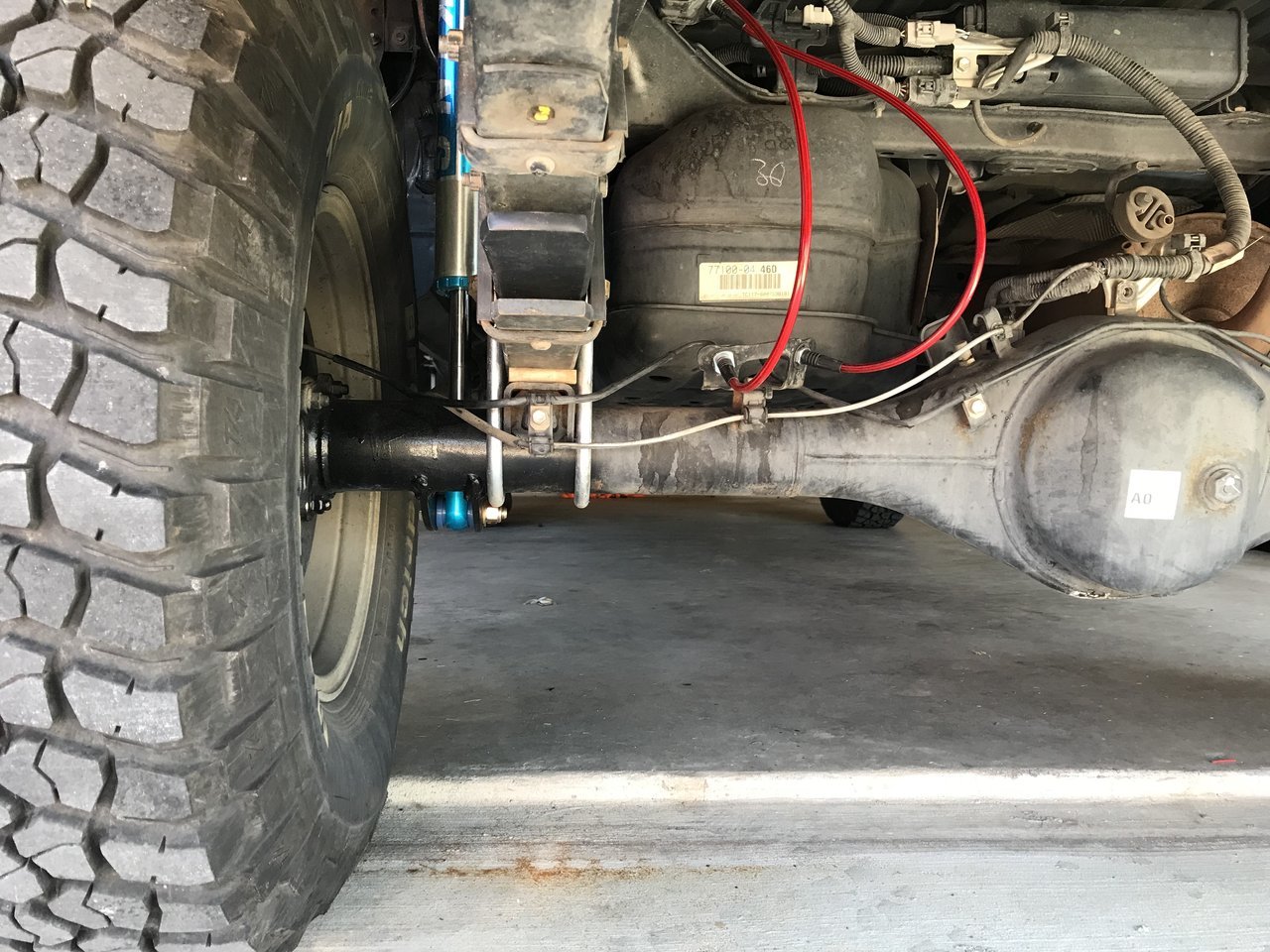

    Just did this mod last weekend with King shocks and Dakars. I'm running 255's and the tires are not touching the shock on compression, about an inch or so between the tire and shock.
    I would recommend the U-Bolt flip with Wheeler's extended bumps as well as +4" brake lines. While you've got your leafs broken down, go ahead and add the leaf you removed to help with axle wrap. We set the total distance at compression between eyelets at 20" which left about 3/4 an inch of shock showing and the rubber bump at the bottom of the shock. This puts the lower shock mount slightly below the rear axle instead of flush with it. At droop, the opposite bump stop and the leaf pack became the limiting factor leaving about 3/4 an inch of shock remaining as well. I'm currently not running limit straps but I'm going to fully flex everything out to measure and verify.
    Also, for the shock towers, there is a factory rivet on the top of the frame. If you flush up the side of the shock tower with that rivet and then leave a gap to weld between the two, you'll get about an 11* angle from vertical on the shocks.
    Let me know if you have any questions, I'll be happy to help however I can.
    5AA4214C-AF32-4B0E-A26C-8EF172A427A9.jpg C8E9D012-48F0-4A2F-B1C2-490E19BCBED6.jpg
    You can see the rivet in this picture.
    EDIT: I did not and have decided not to flip the shackles. I realize I could get more performance from this mod by doing so, but I also use my truck for truck stuff. There is still a significant gain from the longer shocks without flipping the shackles.
